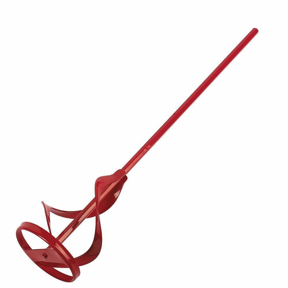

have you put a stirrer in a drill and brought the pigment up from the bottom of the tin ... it always looks like very light green 'til you give it a few minutes agitation
have you put a stirrer in a drill and brought the pigment up from the bottom of the tin ... it always looks like light green 'til you give it a few minutes agitation
I gave it a good stir with a length of copper.. Will try the stirrer on it tomorrow when I'm not wearing my good overalls!
Will try and report back. We have them as use for knocking up the odd bucket of mortar
drop it into the centre of the bucket and quietly work your way around in ever increasing circles ... beauty of those is almost no risk of knocking a hole in the side of the bucket ... should see the pigment rising pretty quickly and then work yer way up/down/etc. ...... 'course you may be right and have been sent the wrong colour :rolleyes::LOL:... but was my first thought when I opened my first tin, many years ago (used to use a lot of it on tanks)
