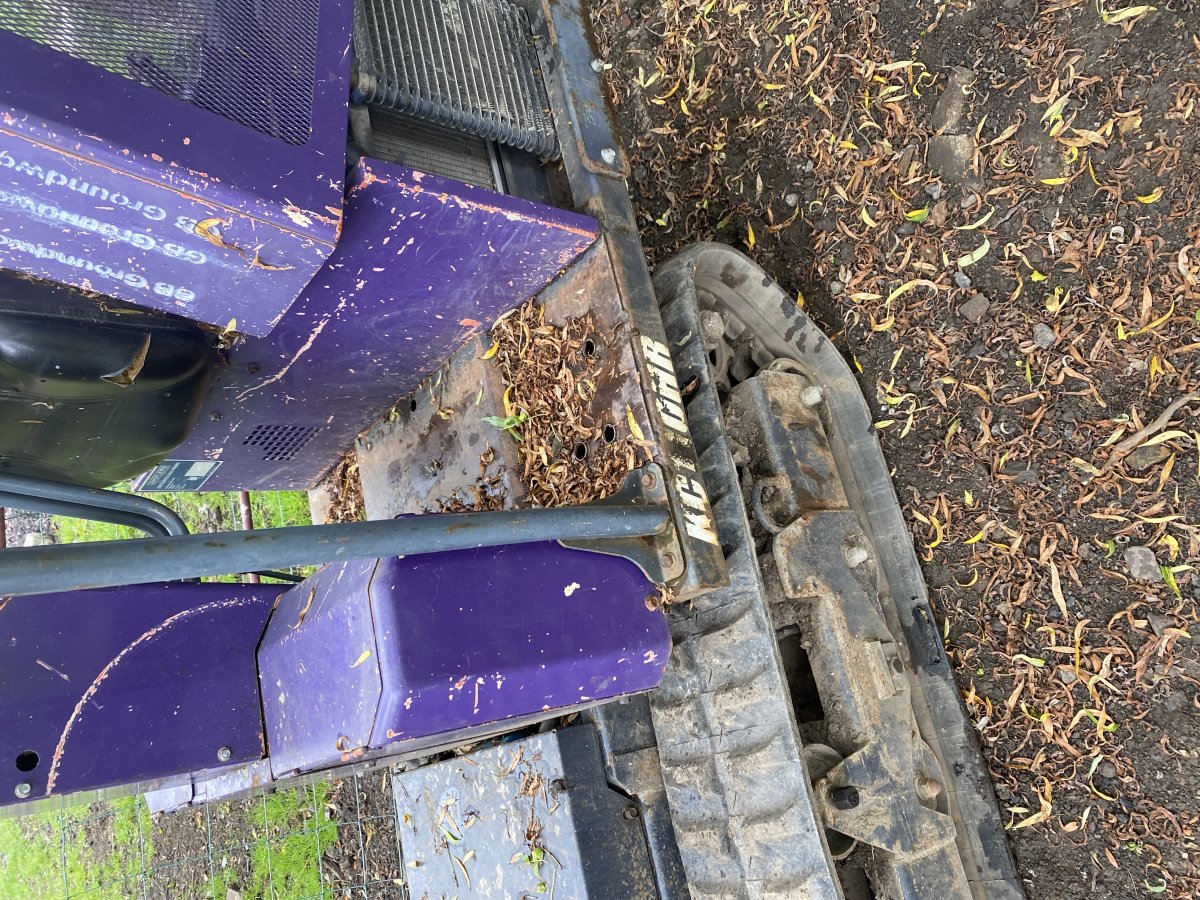

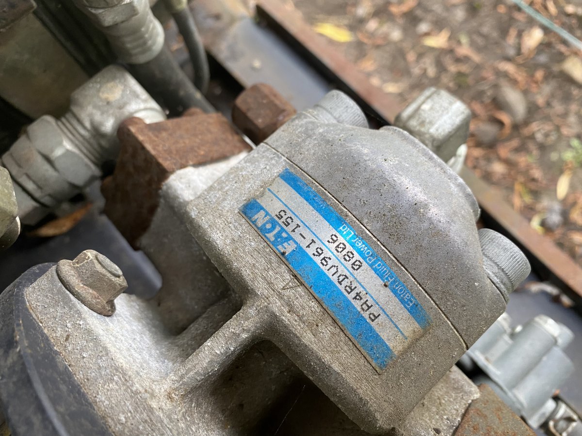

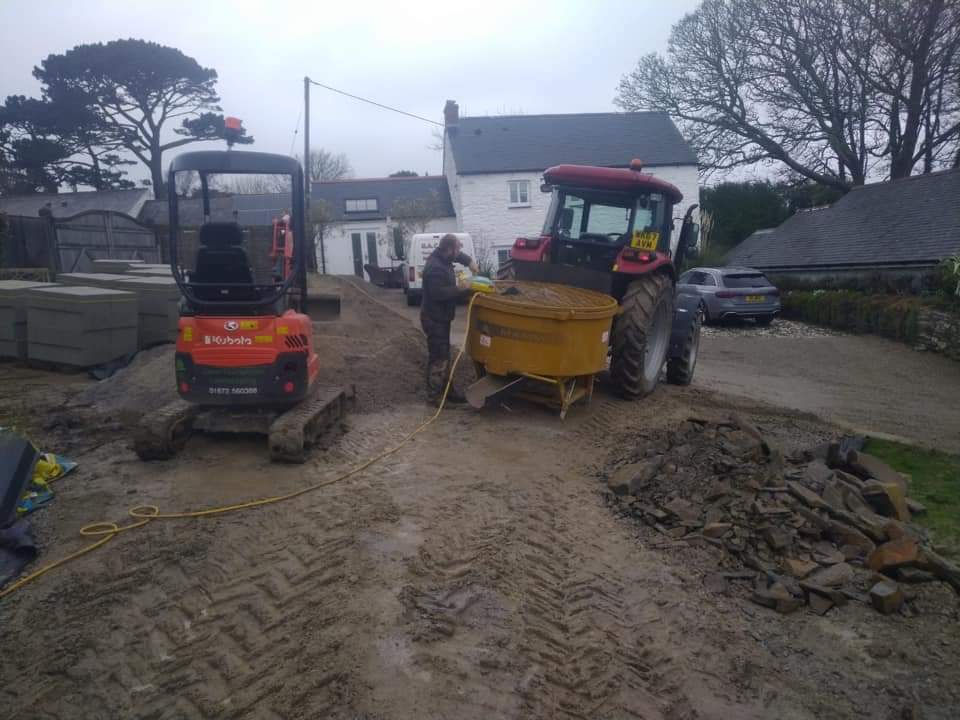

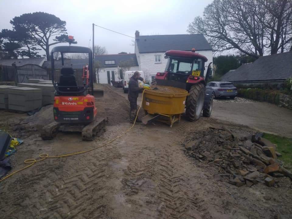

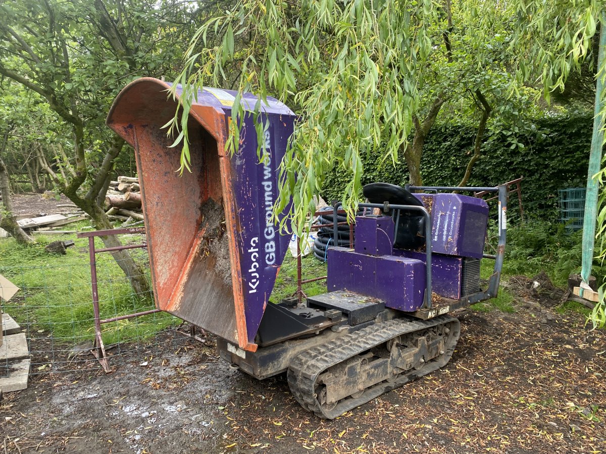

Ok so speaking to agritrend who seem to be the better manufacturer of pan mixers they do a 600l that’s 550kg and needs 50l a min oil flow. Looking like this will be too big for the little kubota kc1100hr.
but can use it on skids run off digger aux so could have it sat on a frame so it spills into track dumper.
only problem being you couldn’t be mixing as you loaded unless beaver pack would power it. Or I go up a step and stick it on my 3 ton tracked dumper a marooka mst450
