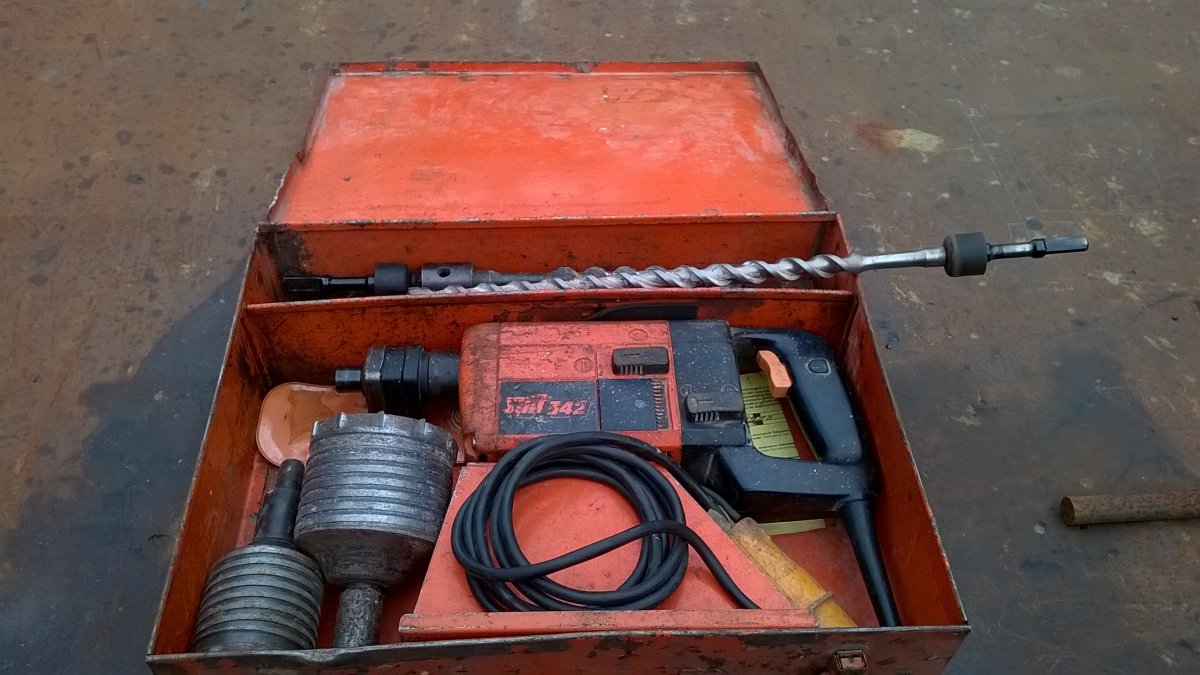

Concrete drill bit.
You’re not the first to say the drill and saw are good. A friend was telling me the other month. Most his gear is Makita but wanted to try the stuff and he was extremely pleasantly surprised, so much so he was planning to buy more.
the little battery drill was a bit of a 'tester' ..... been superb .... charger has its moments, but seems to have its head together currently ... would buy more of their gear with out hesitation (y):cool:
