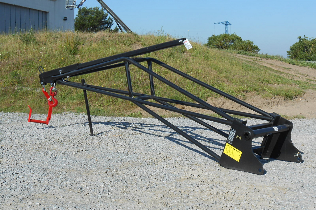

It this proper manitou one
It's a fair lump and gives about 4m more reach. I'm not sure the duck would handle it with much more than a couple of hundred kilos on the end I know the Tele doesn't like too much on the end with it fully stretched out

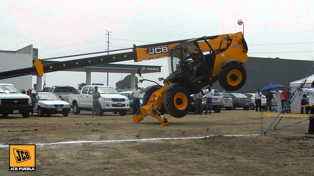

On jcb there is a black box on side of boom about size of fat packet
As the boom retracts there is a metal plate that covers it which tells the machine the boom is fully retracted and disables the sli for bucket work
If this black box where to some how end up with a 2p piece stuck over it then you can do what you like

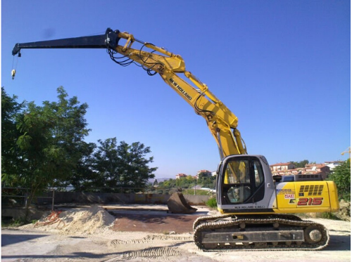

was thinking along these lines ......
this one even has a winch
give the bucket ram a testing though and it's plumbing :oops:

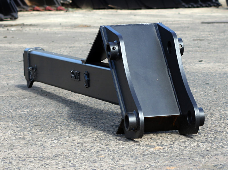

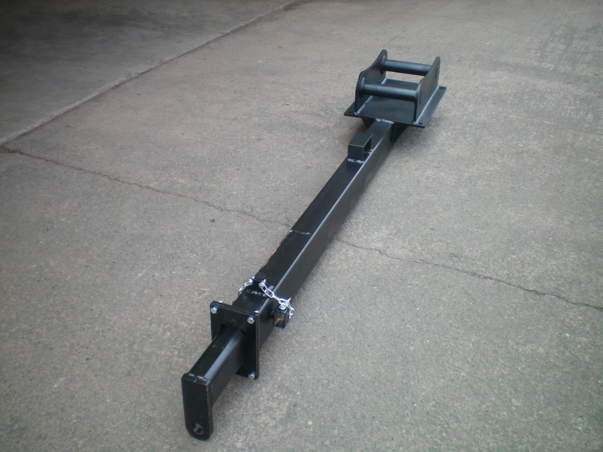

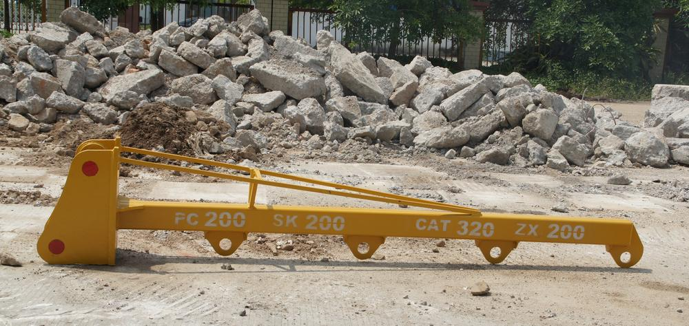

Tbh @V8Druid the ducks nearly got more reach than it can handle anyway with the 3pc and offset boom and no legs to keep the arse down it's got some pretty serious reach anyway if I was to go for any sort of boom it would be a 3cx extending type boom so it could give more reach for digging /ditching and could be used for lifting if required
There are a few pix on fb of the whole bucket linkage and ram removed and then the two pins at the bottom of the boom used to mount it solidly to the dipper so no worry about the ram failing
bit like a fixed dipper extension ... lot of faff for a few lifts though ........
