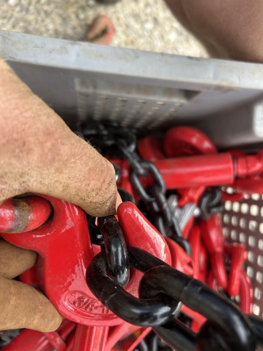

Does this look acceptable for a chain and hook? Seems way too much play.
Don't some work with 3/8 and 5/16?Does this look acceptable for a chain and hook? Seems way too much play. View attachment 84344
even though it has 3/8" stamped/embossed into it -- I assume that's 10mm chain in it ATM ... if it's 8mm then deffo notNo. Wrong size binder for that chain.
Some do two sizes, I'd be happy to use that binder with that chain provided the chain is 10mm, no way those links are gonna fold and pull through that hook!Does this look acceptable for a chain and hook? Seems way too much play. View attachment 84344
Yea that’s the firm10mm chain? Most binders can take 10 and 16mm ? Is that from ratchet straps uk? Will check what mine look like when I’m next near them!
