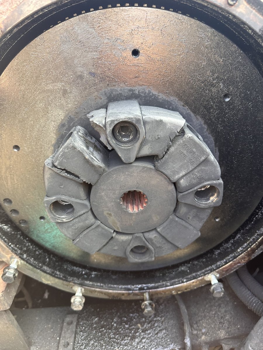

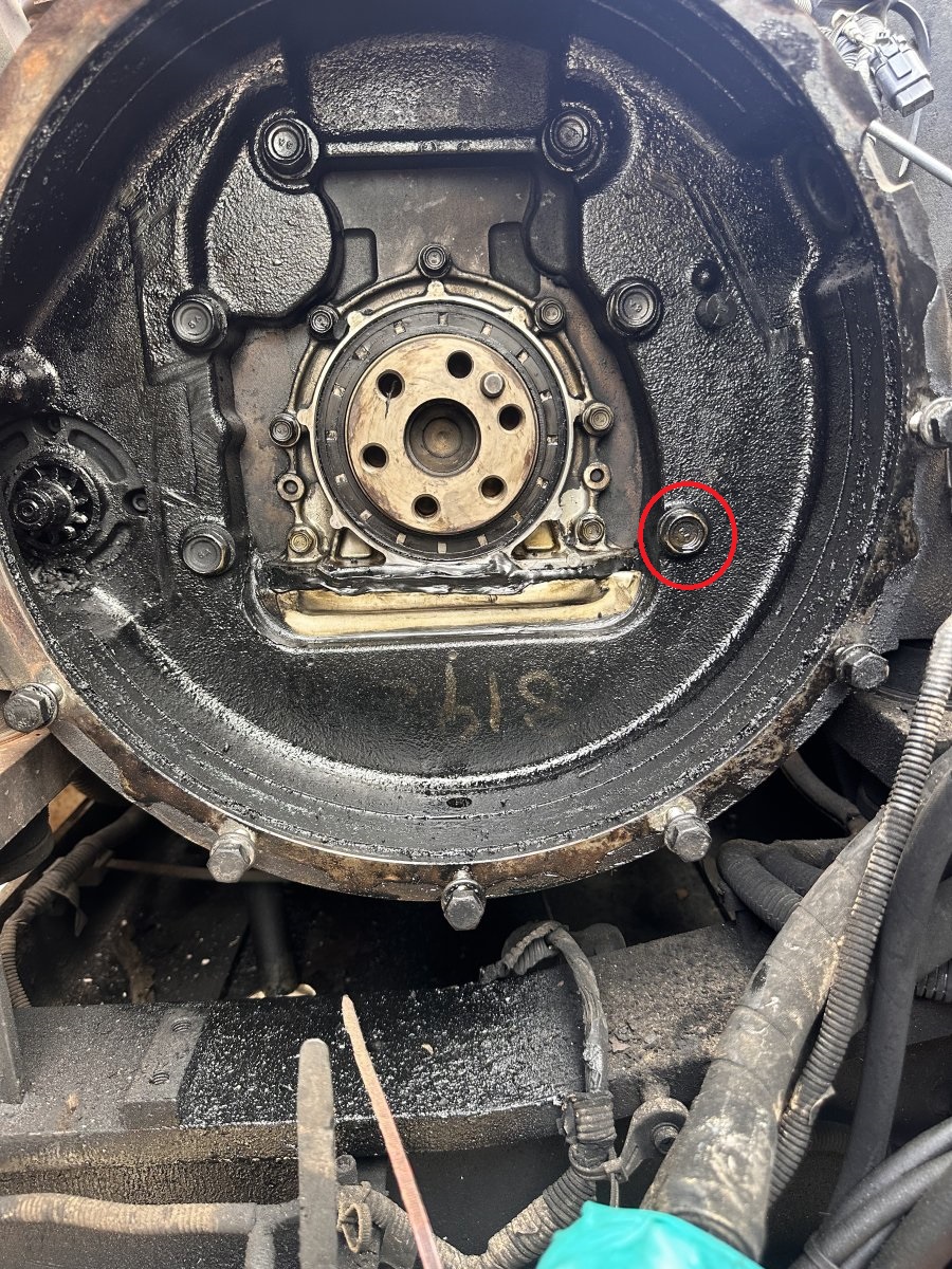

The oil will not have caused the coupling failure, for one thing there isn’t enough in there. I suspect, looking at the sealant round the rear crank seal, that the crank palm was worn when the new seal was fitted, or whoever worked on it bullied the new seal on and caused a bit of damage. Whatever, while it’s off I’d fit a new seal, but be a bit more careful than the last bloke. Without knowing the architecture, it might make fitting the seal a bit easier if you lower the sump a bit on its bolts. Be sequential or you’ll end up with another leak round the sump joint.Yes but I don’t actually need to change it as it’s engine oil I have a wee drip from the bell housing , that’s probably why the rubber has given up . I was only going to change hydraulic seal as I thought might be wise when I’m in there . Looks like a pump off job then buddy !
You’re right there Bri the oil definitley didn’t do for the donut . It was bone dry . I will defintley check the distances though as that’s a good shout . From memory I think the donut is more rounded edges on one side and I’m sure that would affect the contact .The oil will not have caused the coupling failure, for one thing there isn’t enough in there. I suspect, looking at the sealant round the rear crank seal, that the crank palm was worn when the new seal was fitted, or whoever worked on it bullied the new seal on and caused a bit of damage. Whatever, while it’s off I’d fit a new seal, but be a bit more careful than the last bloke. Without knowing the architecture, it might make fitting the seal a bit easier if you lower the sump a bit on its bolts. Be sequential or you’ll end up with another leak round the sump joint.

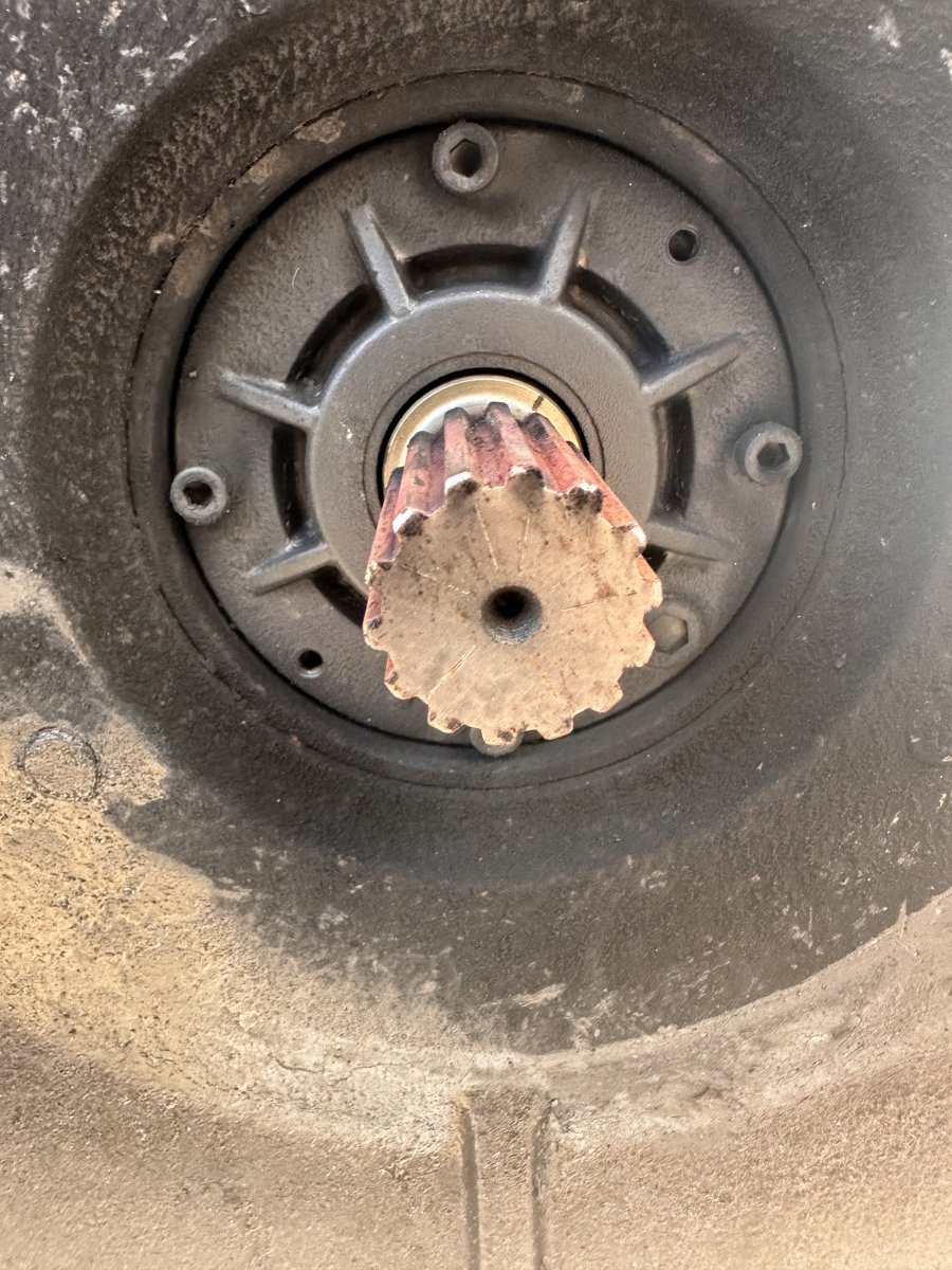

As for the coupling, the drive may not have been correctly positioned on the splines. Too far forward and it’ll take the end float out of the crankshaft and pump, too far back and the doughnut won’t drive across the full face and you’ll get premature wear. I worked on a Cat 315 that hadn’t been lined up properly (too far back on the splines) and the coupling was chewed up at under 1000 hrs. You need to do a bit of measuring and working out with a straight edge and steel ruler.
I never took a pic of the back of the flywheel but I will when I’m back up thereso where the hell is the oil coming from?
odd this is the only bolt with oil pooling in it ?
what's the back of the flywheel look like Vin ?
