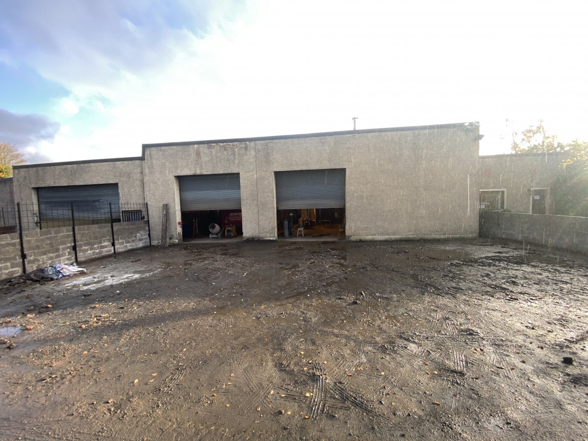

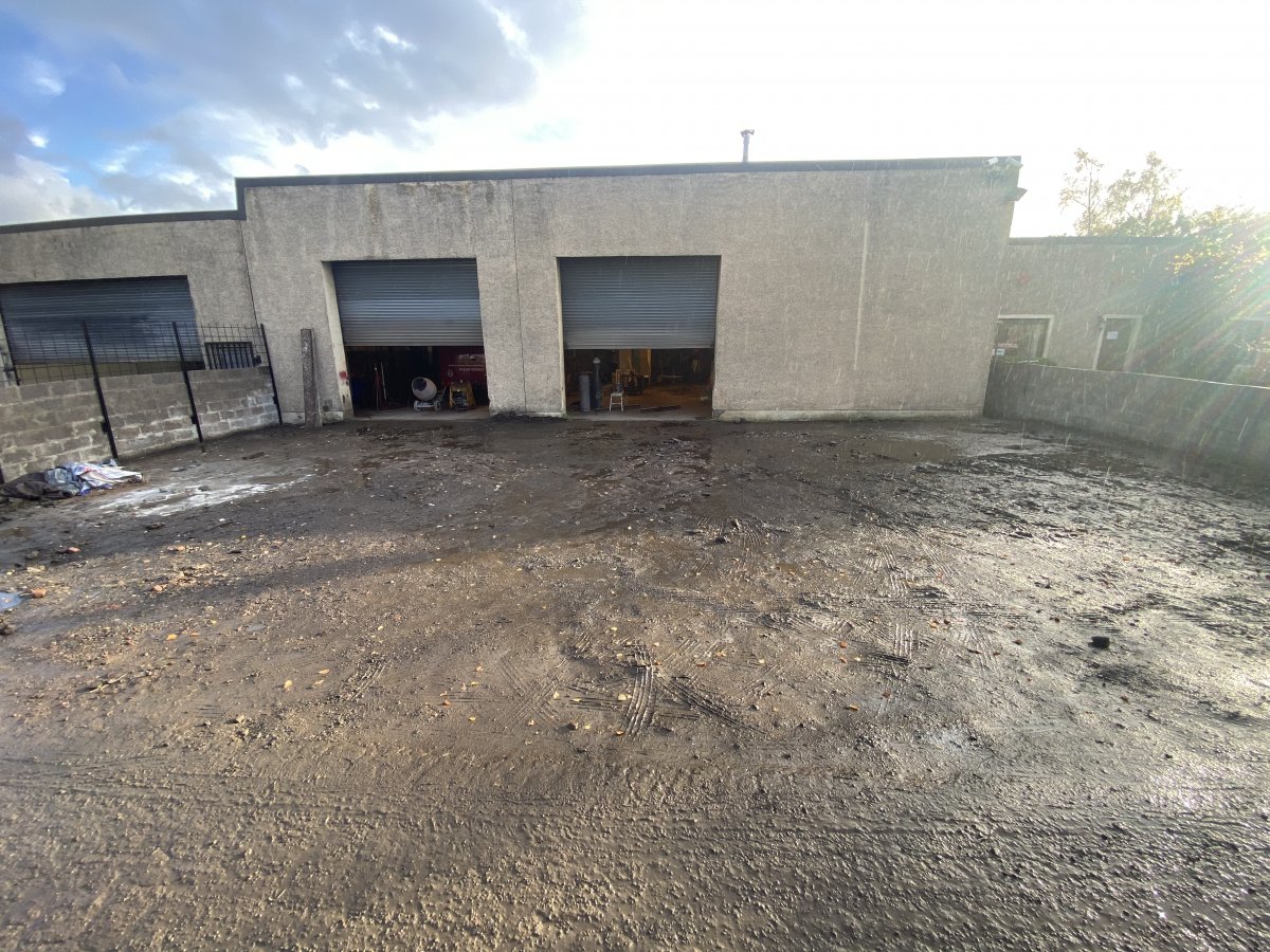

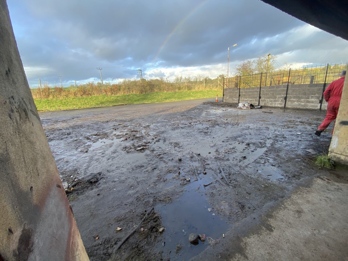

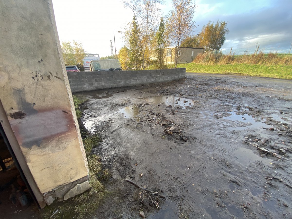

Evening all,
need some help with new workshop.
I want to concrete the outside of the workshop so it’s tidier.
It’s 16mtr length x 11mtr width.
at the moment water runs down towards the workshop doors and the runs to the left where you can see another unit.
what’s the best plans for this?
I was going to dig down 200mm
Remove all slop, 50mm hardcore and ramp down, aqua drain running full length of workshop with a fall going to the left as per existing drain. Then 4 bays of concrete

More hardcore, thicker concrete and some reinforcement.
If you don’t own the yard it’s a hell of an investment, I’d look at planings and drainage.

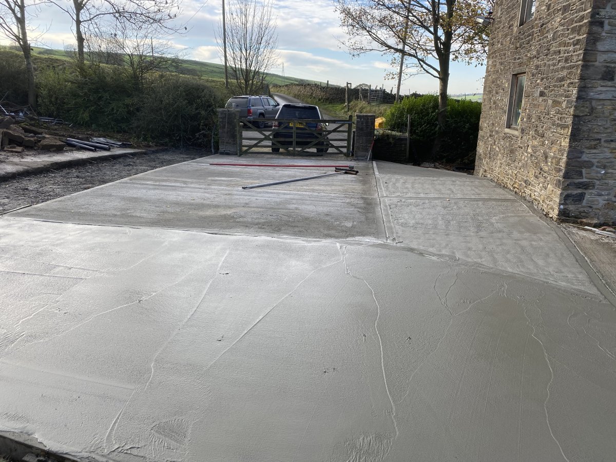

You want at least 150mm of good compacted mot/crusher run. 50mm Sand And 1200 visqueen then 200mm slab c35 with a layer of a393 50mm from the bottom in an ideal world
if reality if the ground is hard packed 50/150 meshed concrete will work until 32 tons find the weak spot etc, if you dowel between bays and lay some proper concrete should be fine.

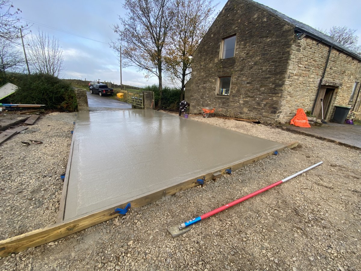

6 inch slab we laid recently on 100mm mot on bed rock, ran the 40 ton voli on it 2 days later to pour the next phase

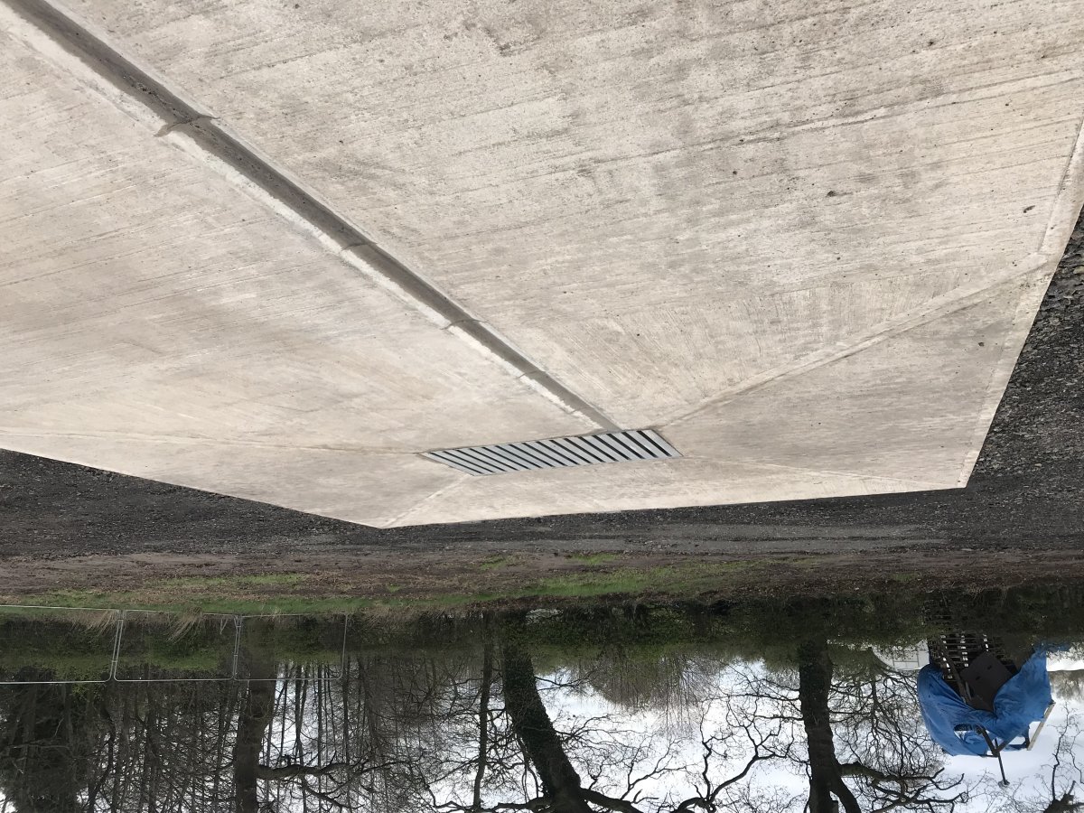

Aqua drain do you mean aco or concrete half channel ?
i ran a length of half concrete channels in my yard straight into a huge catch pit, ideal as they don’t clog up like a Aco does. I was very short on fall, should of had more away from the shed and into the pit, but the yard and shed keeps dry so I shouldn’t be so fussy!

It depends what the existing yard is you want 200mm of concrete with mesh and 150 of type 1 underneath really but it doesn't have to be fresh if your still in existing hardcore.

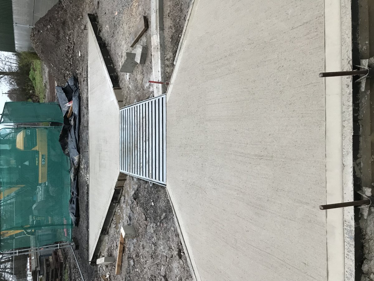

I'd pour one bay out the front and saw cut it the next morning for ease of pouring it I'd also take dave's advice and lay open channels and a catch pit or make the slab fall to a catch pit rather than acos unless your going to fit d400 ones as forklifts will just smash them.

I couldn't tell you why but I have worked on a few that have been engineer designed and it seems to be best practice to use a speed bump around the edge rather than dished channels

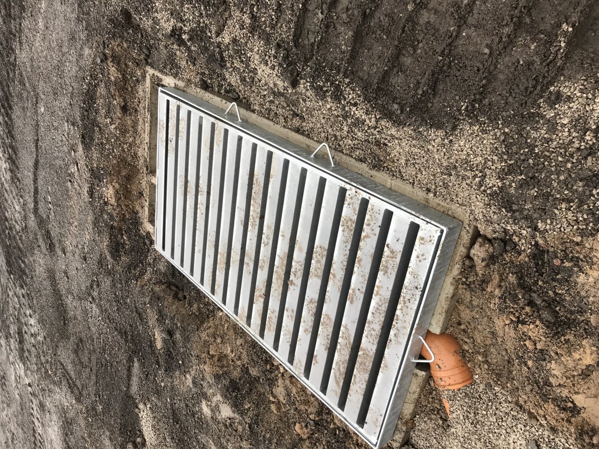

8ft cow trough to make the catch pit, was about £300, bedded on a semi dry mix, had my fabricator guy knock up a lid and concreted the lot in, c35 150mm with mesh, had all sorts drive over it with no problems!
you have to chamfer down the last kerb channel so it runs flush into the lid.
