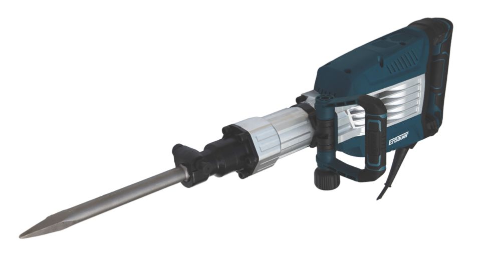

And I've just had a look at the Erbauer breaker, looks a much better machine for the money 👍

For occasional use, the Erbauer screwfix breaker has much better anti vibes than the Titan. It's OK for the odd small slab, although not a patch on a £2-3k Makita or Hilti obviously. But realistically, anything more than half an hour's pecking about and I fetch the Sherpa or micro.

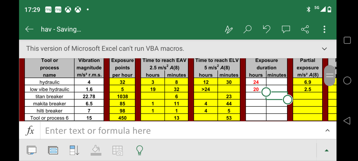

Don't know how Screwfix etc get away with selling Titans and all the others that look like they come out of the same Chinese factory, they can't conform to any standards regarding vibration, trouble is a decent alternative is about ten times the price, people think they are working well because they make a lot of noise, i hired a nice Hilti that did more work, quieter and far less vibration.
Aimed at the DIY market, the hav figures are there but they are terrible.

You'll need to worry about as it's literally minutes with those cheap ones. If you have employees they will get vwf and claims can be high
Makita hm1812 is 30kg and around 1k with 3 year warranty, it's what I have and does the job, similiar figures to the hilti but a third of the cost.
This was a calc from a while ago but you get what you pay for

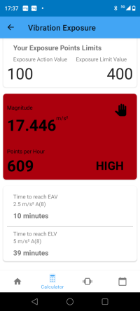

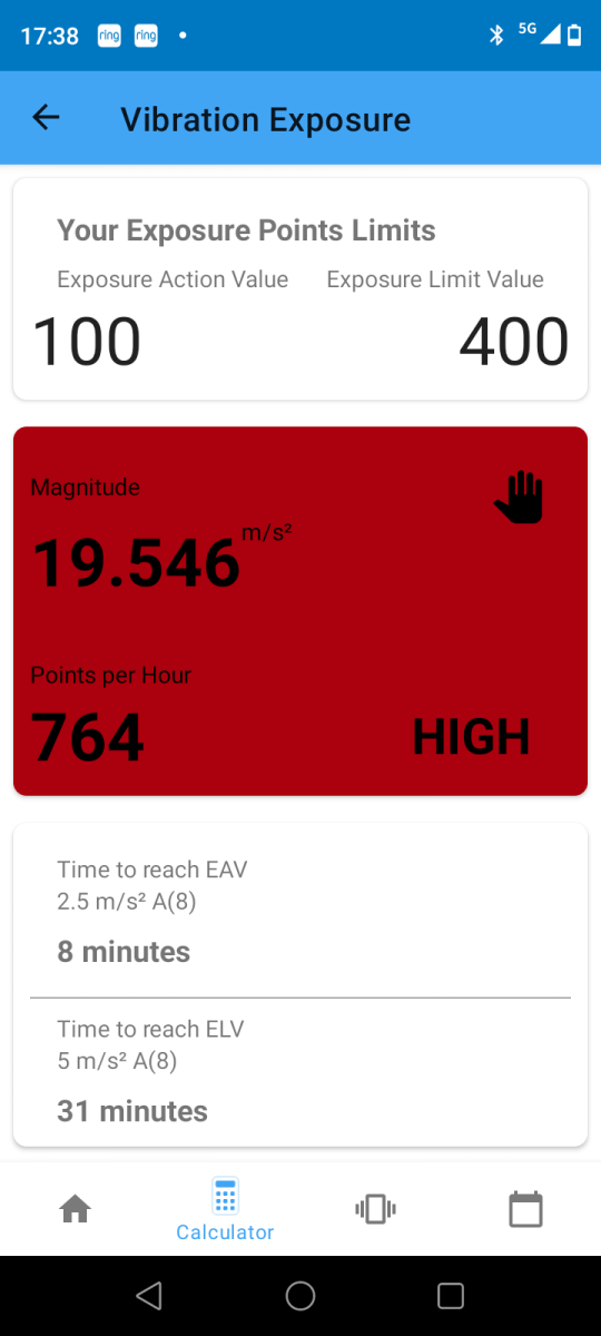

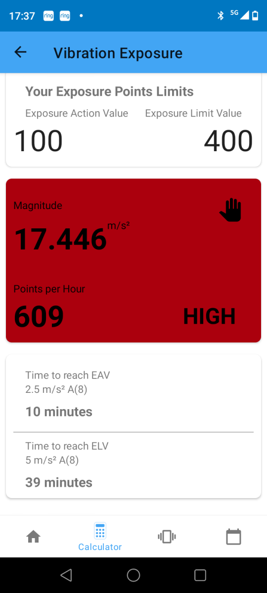

Ab1900 main and handle (handle is worse)
