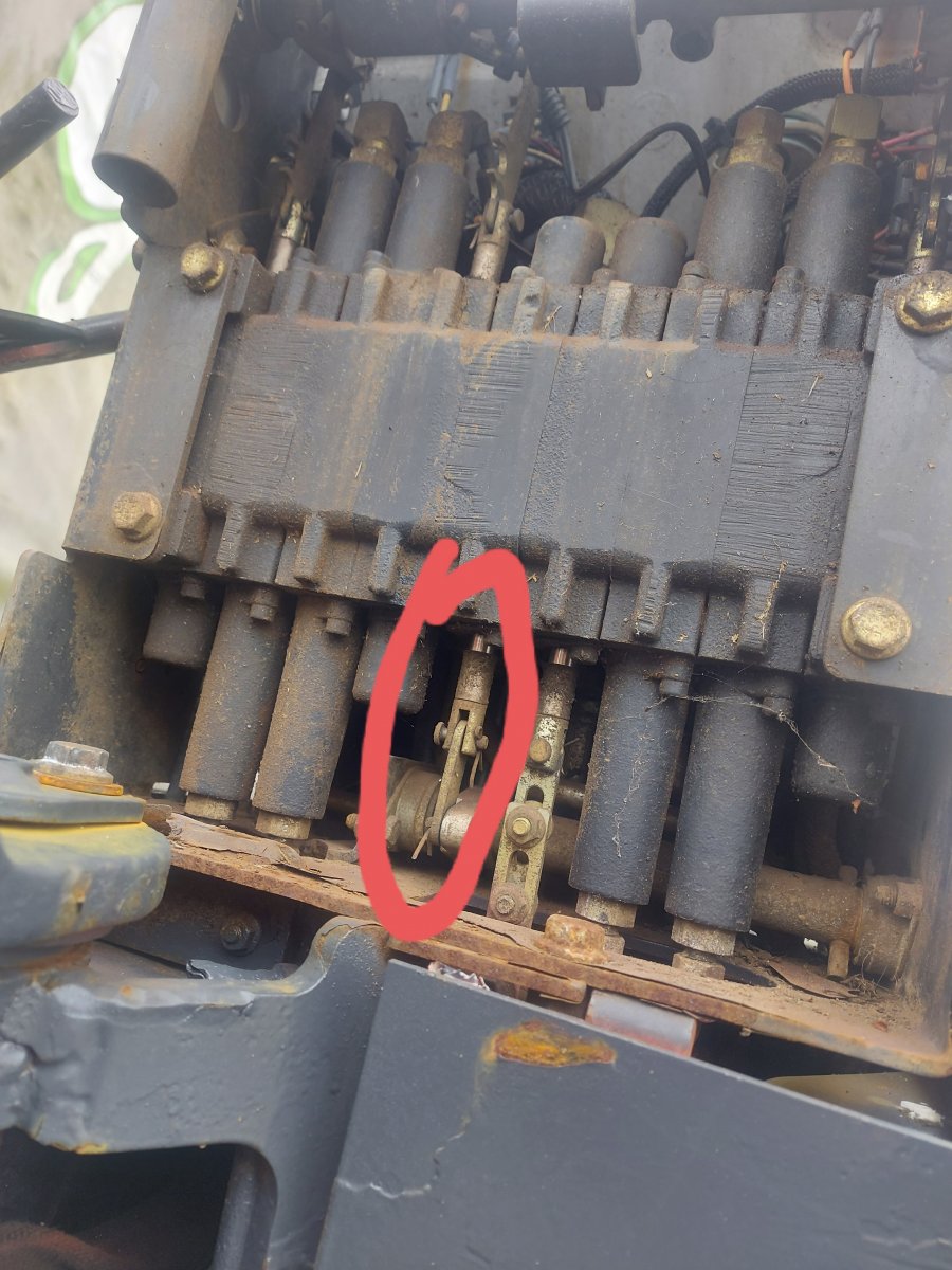

Should be simple enough, disconnected the hose from the tank and blank, and put it on the other end of the valve block... don't think they have a t valve on themand your solution would be........... get out and swap the pipes over every move ??????
if the valve will double act Aiden .. if it's one wayShould be simple enough, disconnected the hose from the tank and blank, and put it on the other end of the valve block... don't think they have a t valve on them
will be what?Pretty sure it will be ........
even with that pin up against the mount plate?????Just got the lad to take the covers off mine, the main spool is double acting and moves both ways on the pedal, but mine is blanked of at the valve block and returned straight to tank, I can imagine the original posters will be the same.
Quite disappointed with this as I could have sworn mine was double acting and was going to use it this Saturday with a little grab to cut some fire woodah well plan B...... or re-pipe it before Saturday..... which with the work load this week seems unlikely

Oh I Haveeven with that pin up against the mount plate?????
that'd take some getting at to re-pipe, Id guesslooks pretty 'kin tight

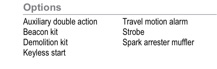

Hi Mark,Thanks everyone for the advice. The pedal does go both ways already. Could somebody possible post a photo or diagram where the double acting valve would be? I can’t find anything online about it.
I can well believe there's little room on those for extras ..... could always put a mono block on the boom or dipper though ... would only need a 3 core wire to it through the king post thenOh I Have![]()
you anit getting many extra valves on this machine
Have looked into converting one to fully proportional with rotate lines etc, and it can be done! but needs a few custom made parts.
