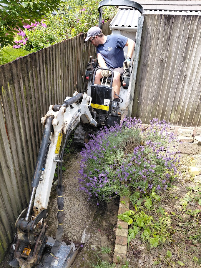

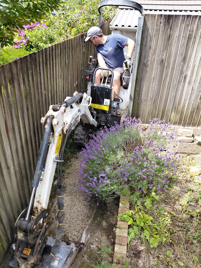

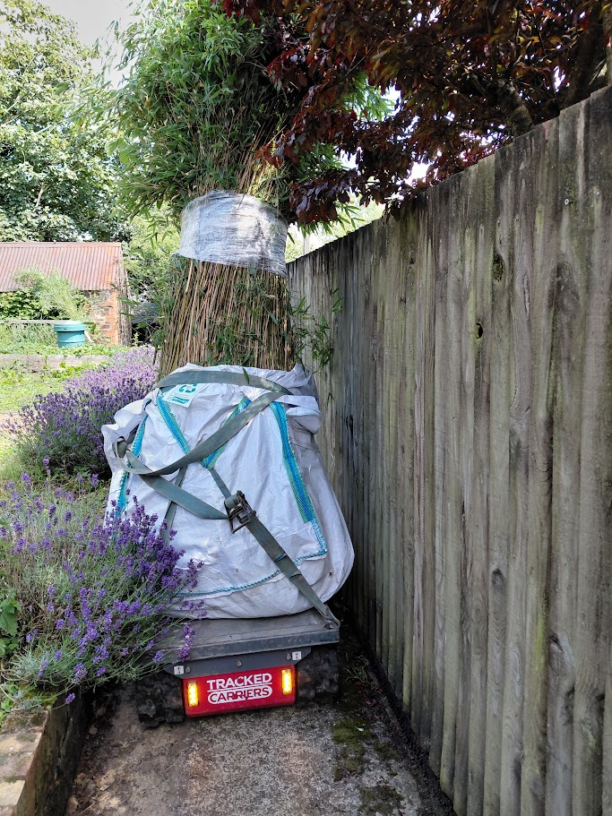

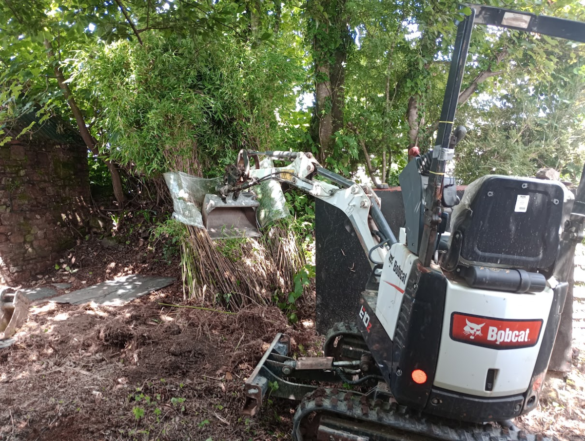

E10 show off day! Got a free Bamboo out of this job. Bit tight getting in. Had to dance onto the steps then slide the ramp in afterwards. E10 going what it does best.. Getting into places that nothing else in its weight/power range can access. 350 hours and I should think its more than paid for itself already. (Although I still haven't finished paying the 0% finance!)

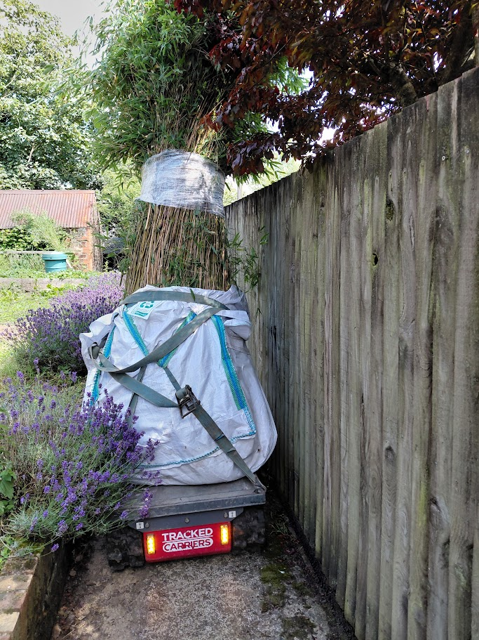

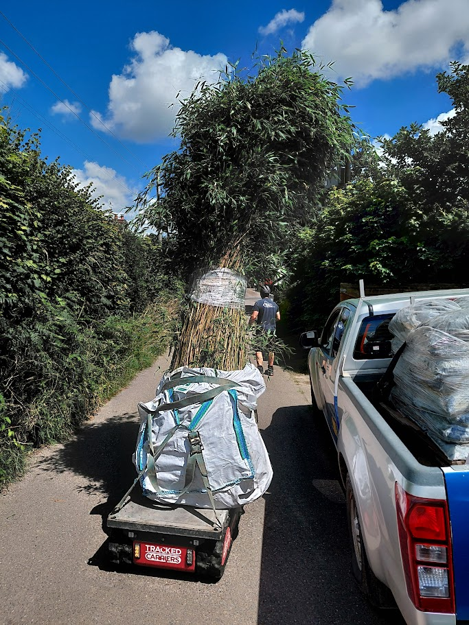

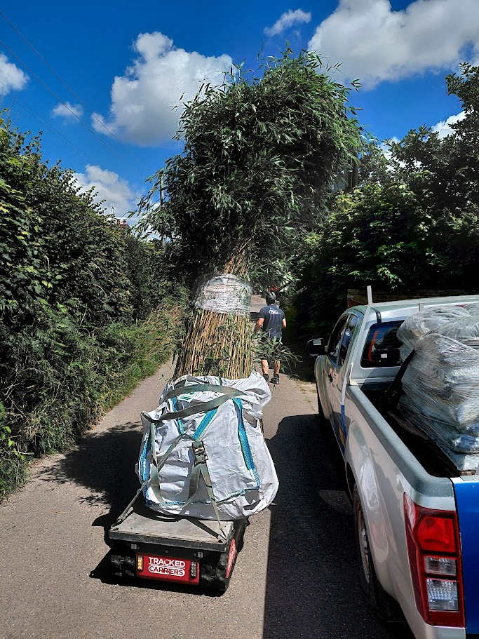

Hope your putting it on the fire or a present to someone you secretly dislike :)
Its going on top of the bank of my shed site. It will help stabilise the soil.. and it cannot grow anywhere it shouldn't as will be surrounded by concrete. Plus its not spread much in the 20+ years its been in this garden. Not a naughty variant.
"Not a naughty variant"
I hope so....as otherwise it's mental how much it groes. Flailed som on Saturday . Used to be head high...now more like 12ft.

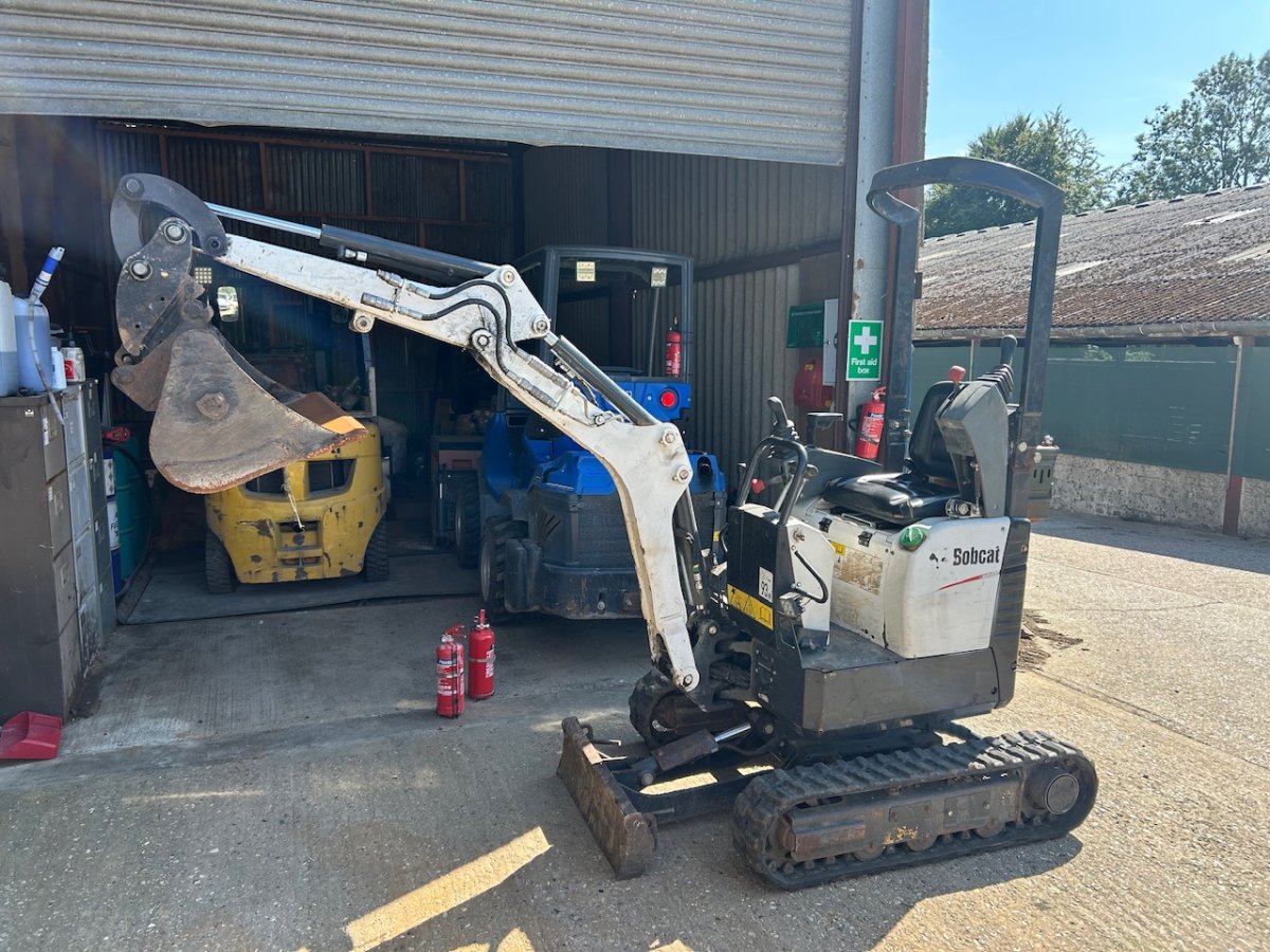

1 hour later. As you can see it’s dropped a bit on all the rams.
If I straighten the bucket back to where it was (flat bottom) the measurement to the bottom of the bucket is just under 53”. So 2” drop overall
Boom ram has extended by 1/2”
Dipper ram by 1 1/2”
Hope this helps.
