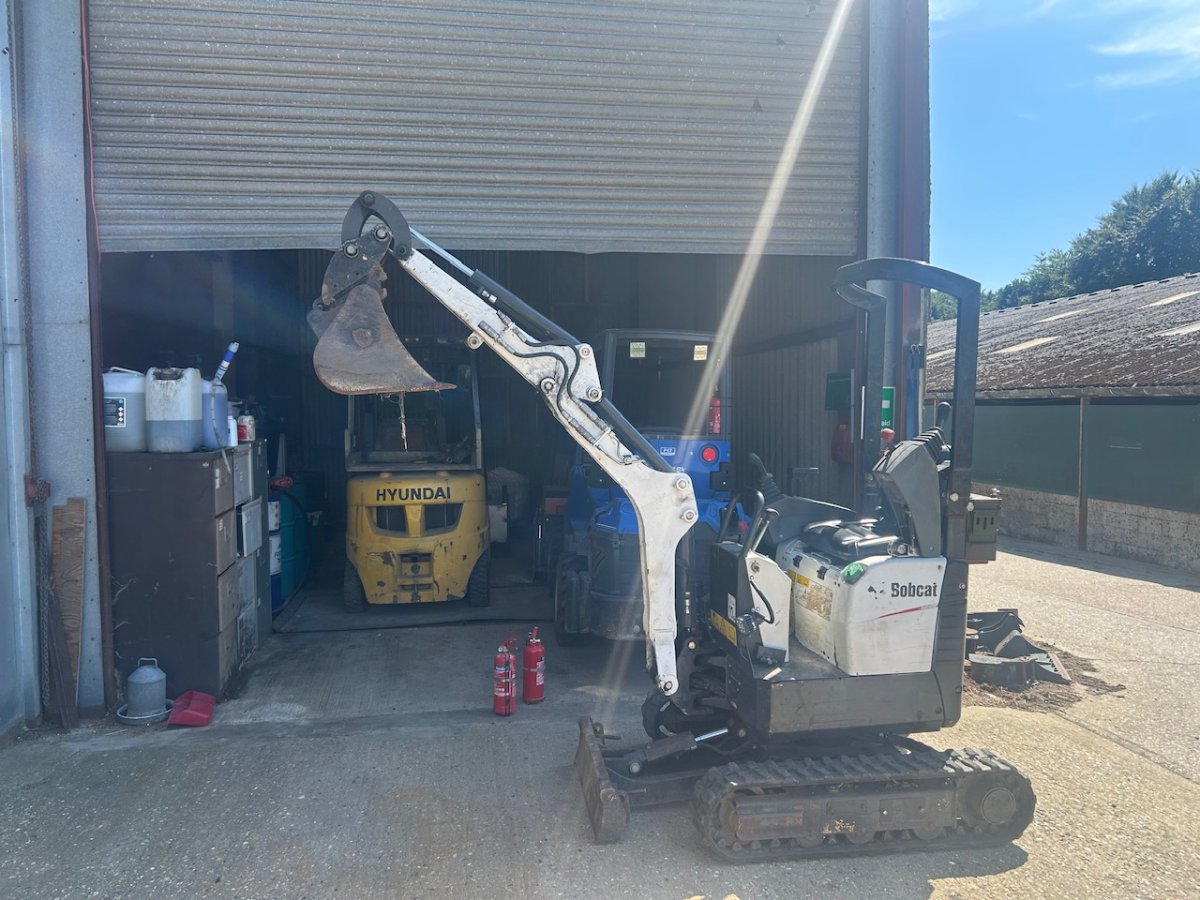

1200 hrs shouldn’t have any hydraulic issue really
Hydraulic issues, as in the blade not being able to lift machine & the bucket dipping back in the wrong direction I agree, but reading some of the above posts its seems somewhat normal for the boom & dipper to creep down with these hours on, under fair wear & tear, i wish it didn't, but I think i may be floggin a dead horse trying trying to get this sorted under warranty.
Another thing the fitter did mention he thinks the hydraulic oil has a bit of water contamination in ☹️
