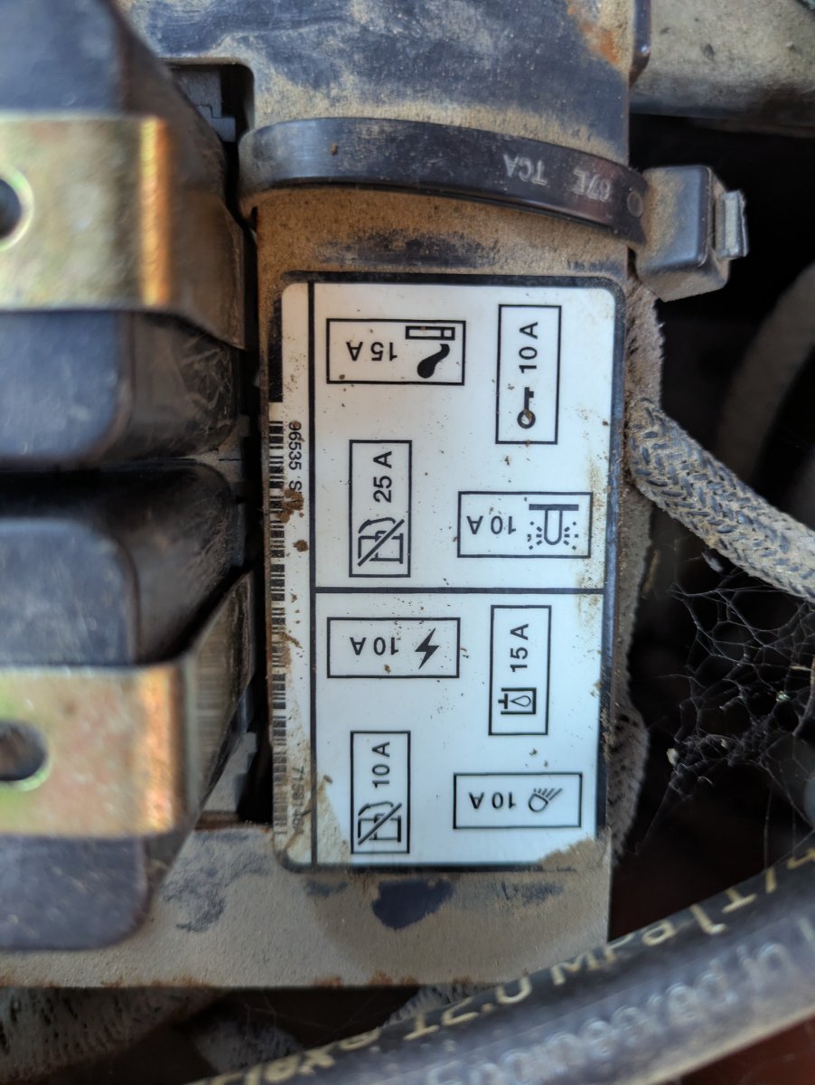

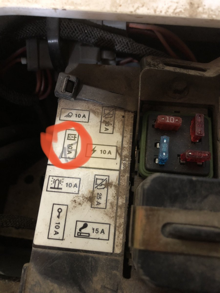

Bobcat E10 blowing 10a hydraulic fuse
As title really, yesterday just randomly started blowing the 10a fuse for what I believe is hydraulic safety switches. Assuming a wire has rubbed somewhere, has anyone come across a common place it happens? I only had a 15a spare to get it moving out of the way (some machines look to have a 15a as standard)

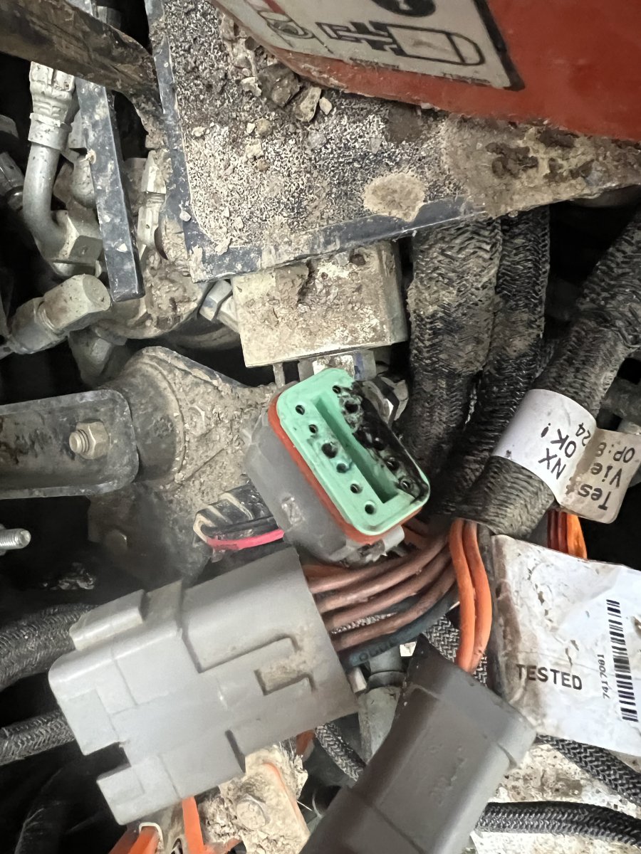

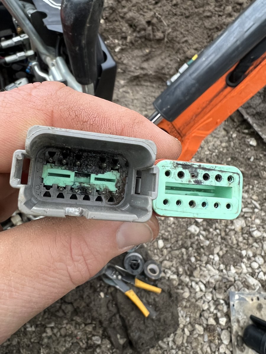

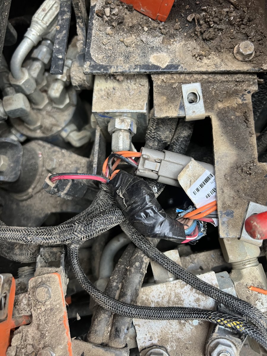

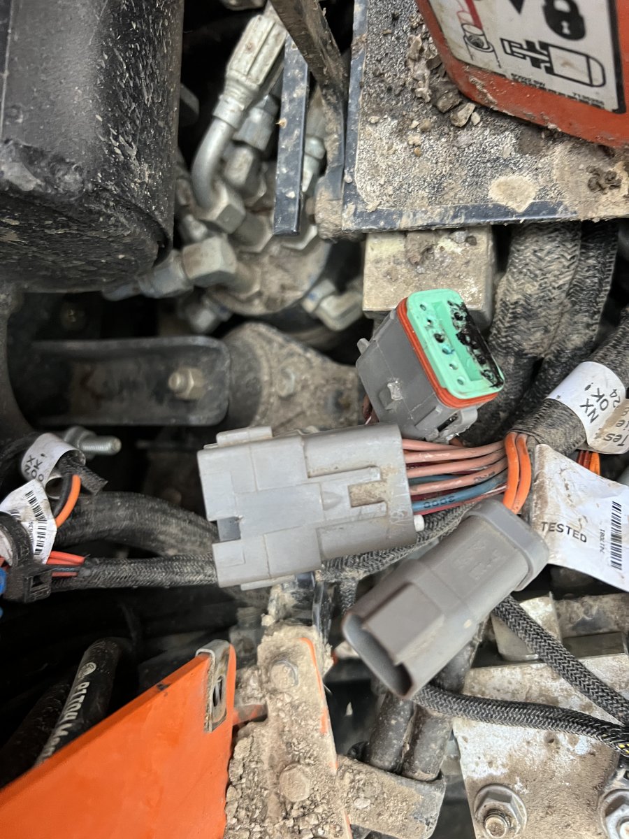

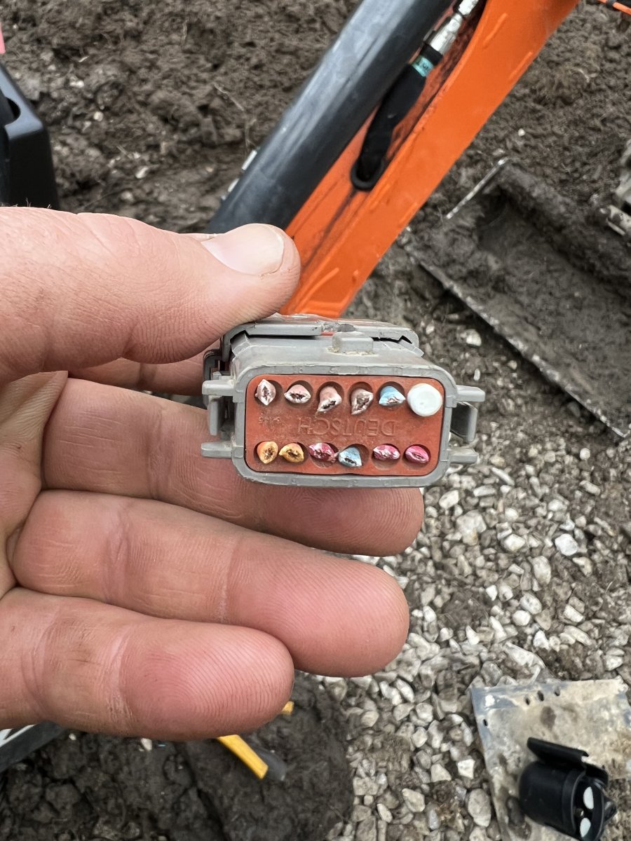

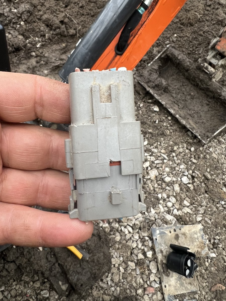

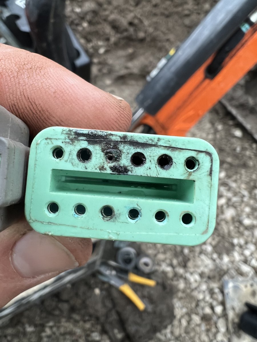

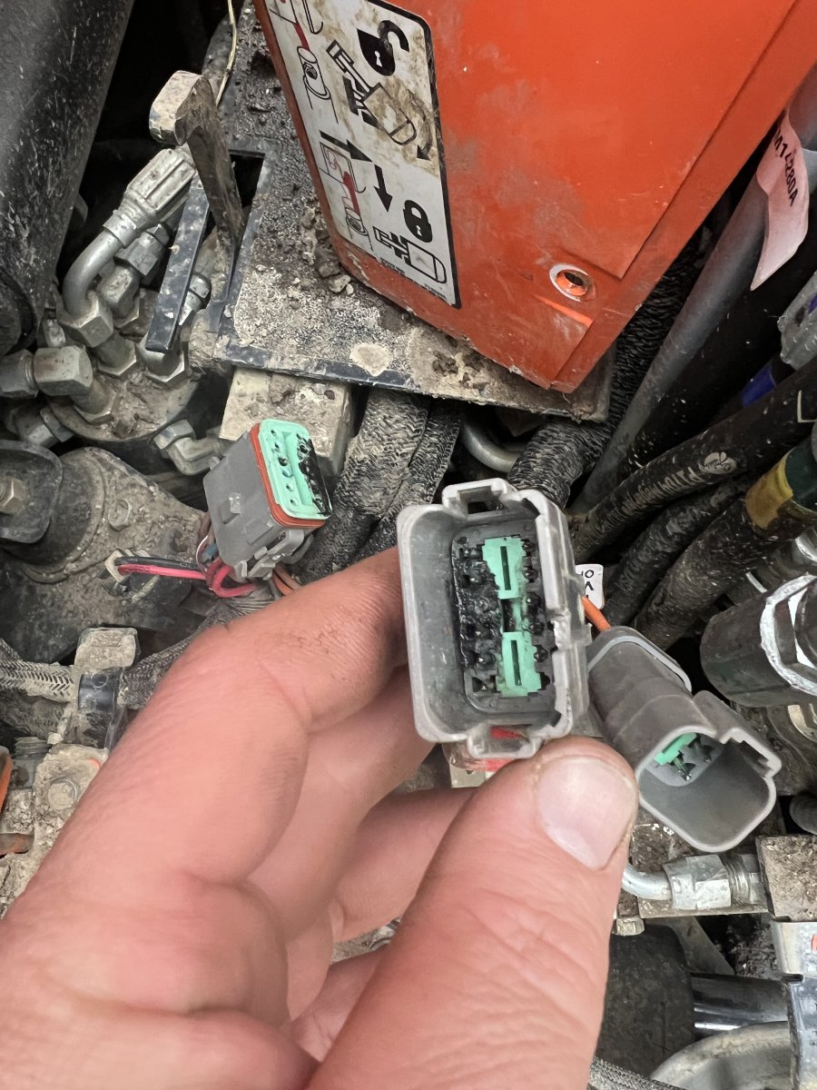

The big connector under the floor plate is notorious for bad connections and water ingress mine got bypassed at 200 hours
