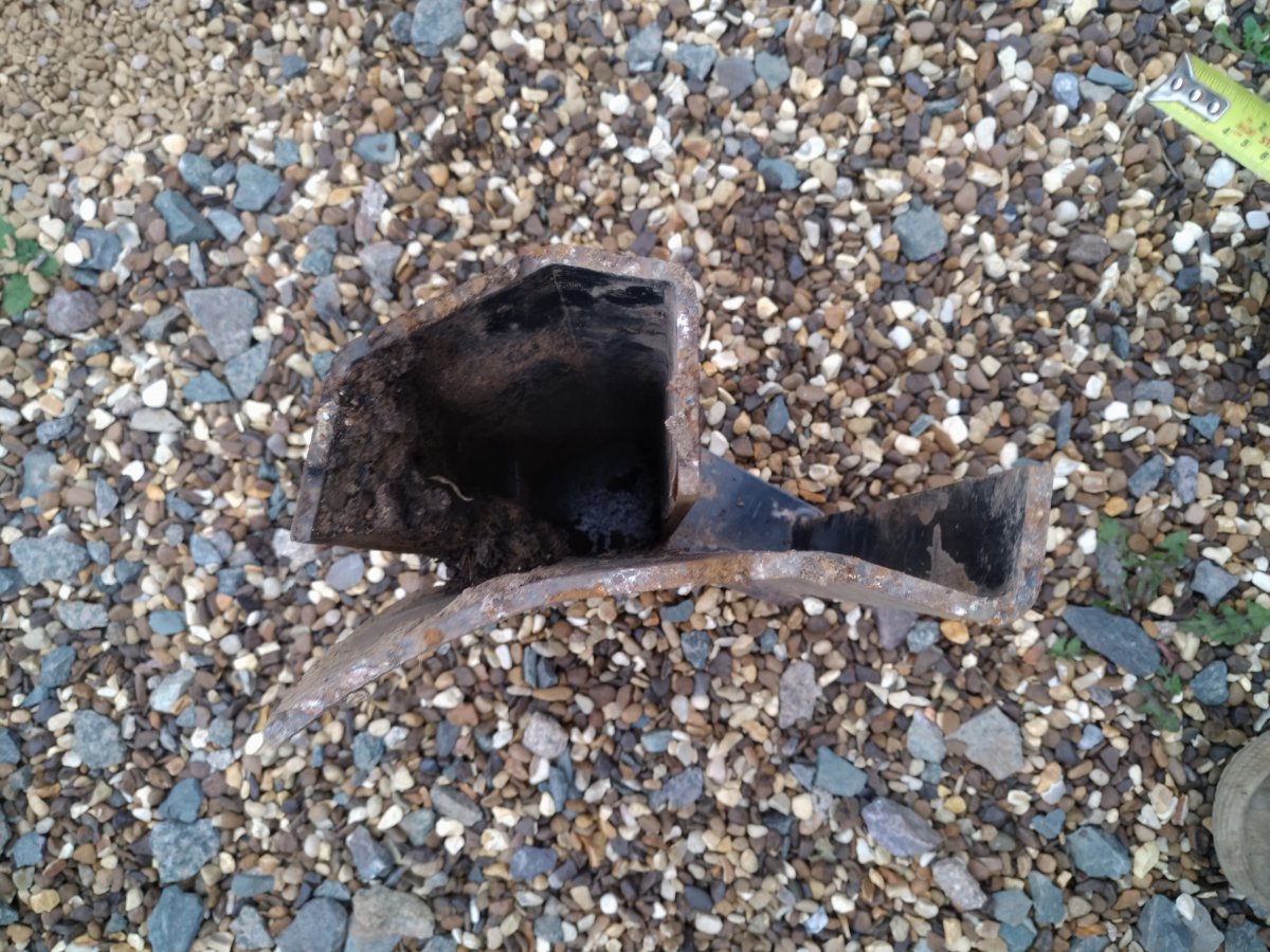

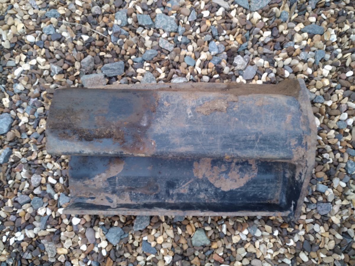

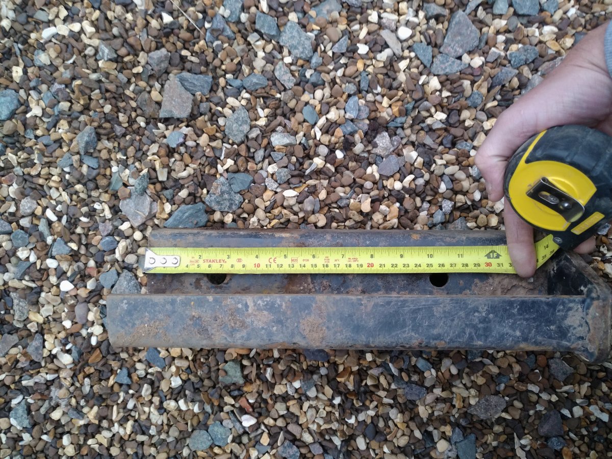

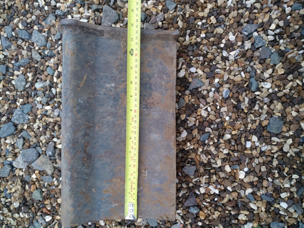

Crap design, front bottom edge gets caught by buckets as it sits proud, you can never slide them in as they fill with spoil so have to be removed to shorten the width

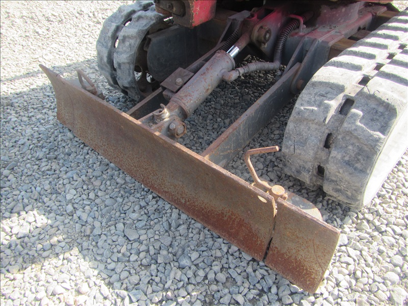

They are a total total rubbish design. I've bent, cut, welded straight and bent them again all ready. You can't straighten them with a sledge because their too springy.

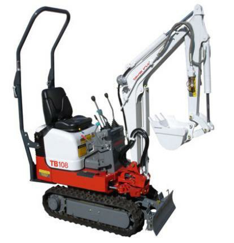

I need to eye up a how the pin on one's work on other diggers so I can copy when my one's get really bad.
Two pins, you take the extension off, spin them around and they bolt onto the reverse
Thanks for the replies folks, and for the pictures Brendan
I have heard there are crap, hence why they are missing on this and the E16 that we had too! once we have it back in the workshop il have look and maybe make a set like the takeuchei
Even the takeuchi design has its flaws i never even take mine with the digger tbh great when they are on a width but stored away they just catch any crap that comes over the blade. Minis and micros aren't bulldozer imho better of learning to be better with the bucket.
