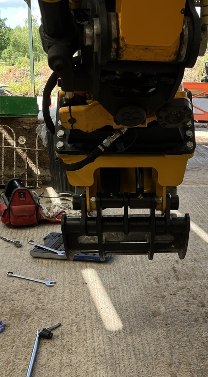

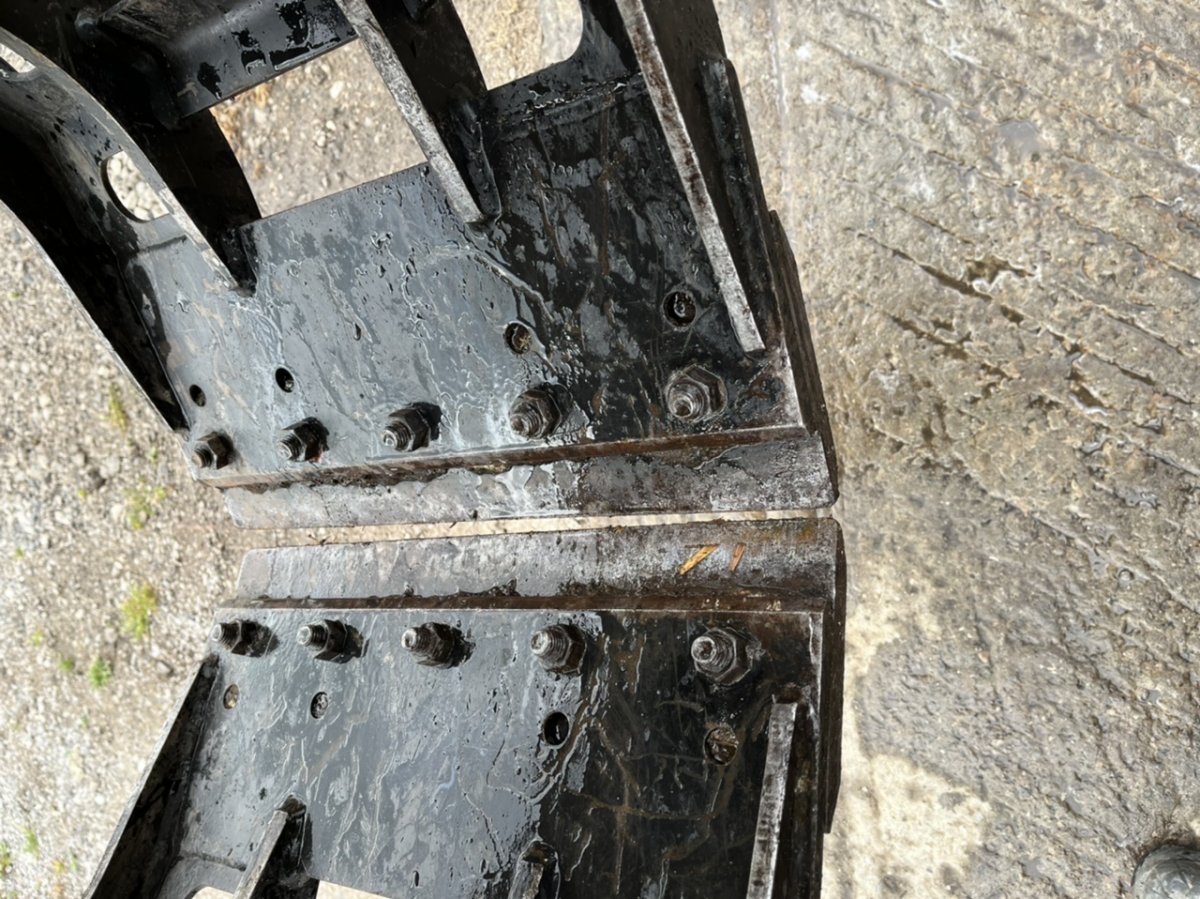

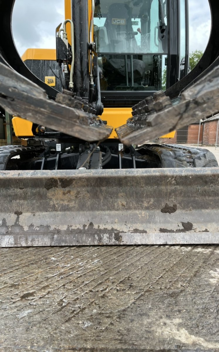

Spoke with Engcon and they said the expander bolts are most likely bent as they are supposed to go before the clam shells themself? I kinda just assumed I’d bent the clams? Anyone shed any past experience on it?

The expander bolts should be easy enough to slacken and knock out once there released for checking?
How did you manage to bend it like that ??
Will knock the bolts out and have a check next week while I’ve some downtime! Don’t know if it’s best to remove the ram so they move freely and I can feel which part is bent, as to look at individually both clams looks straight, until they meet.
Was moving some timber around, think i just caught something abit off, I’m no animal of a operator! pick up all sorts with it and never bothered it before 😔
Tat's appaling if that's bent, a grab should be almost indesctuctable for the machine it's matched to, I've been using a prodem this week which has been used and abused bolder handling for a few years. Still as good as the day it was made

Certainly wouldn't expect clam type to bend especially premium brand
