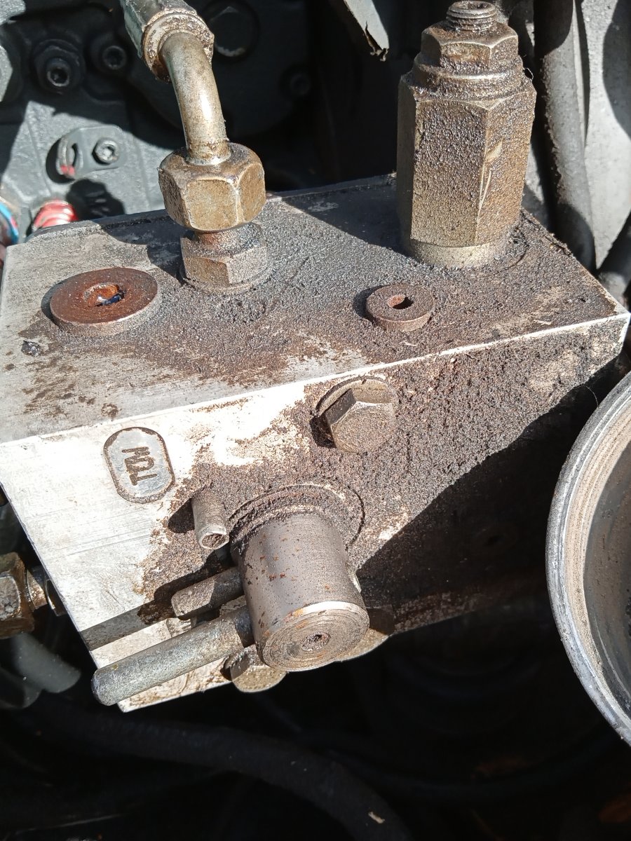

like @Mick-the-fitter said ... refurb the tow valve block

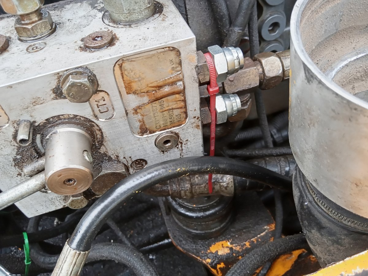

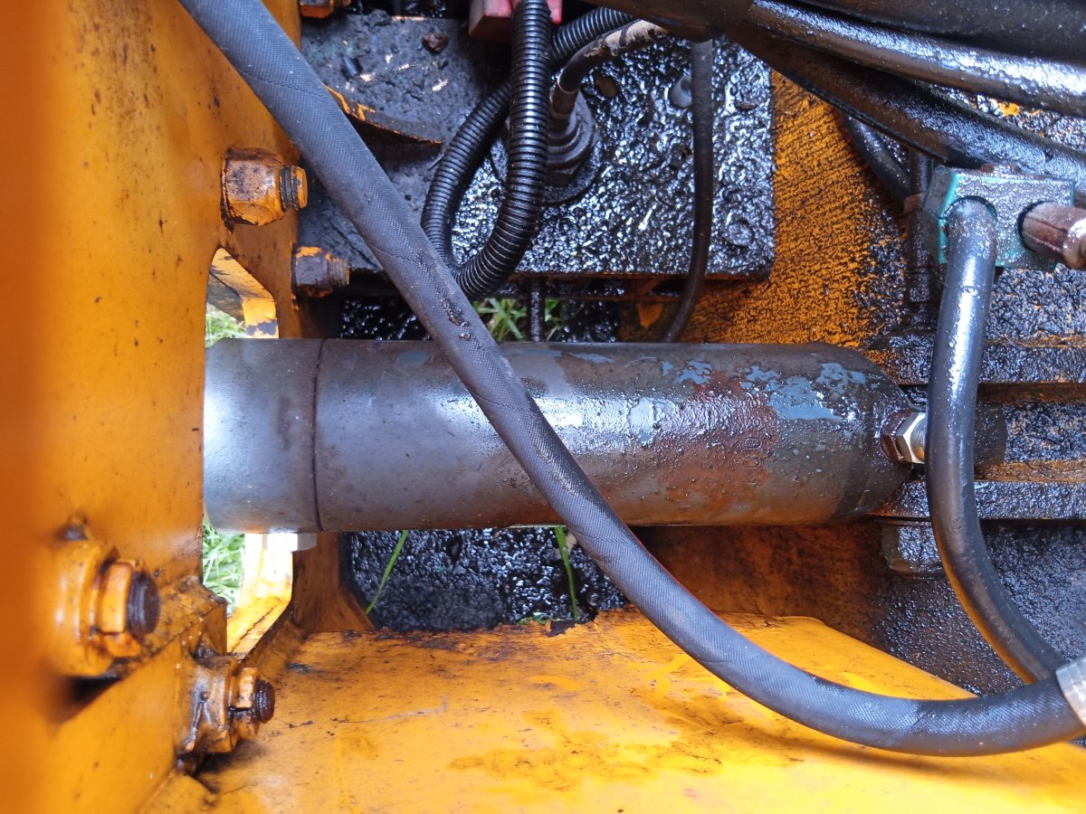

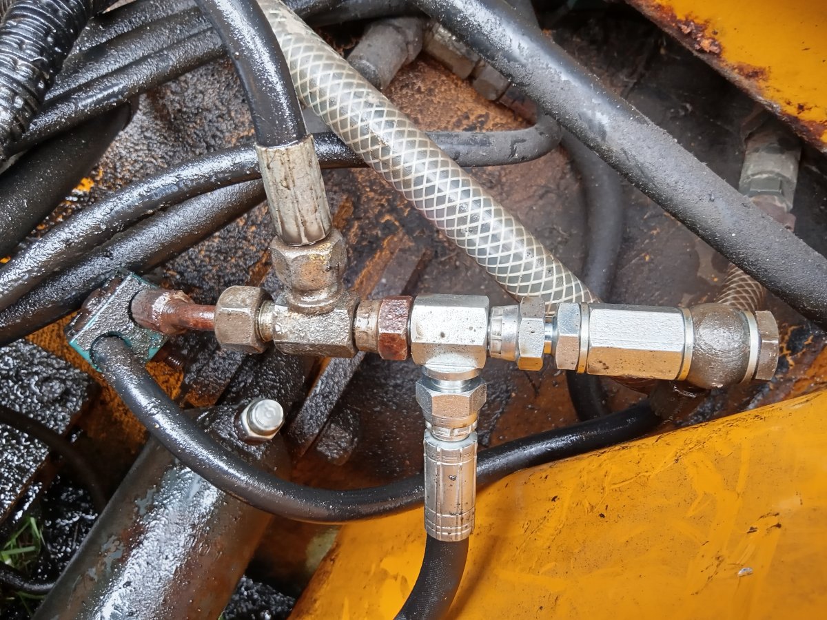

You will get flow when the engine is running, the tow valve may have an internal leak, which means rather than make pressure at the brake hubs it will leak back to tank! Ok take a hose off the steering ram either end, join it with a tee into the two brake hoses at the tow valve/ red and green cable ties, if you can blank the tow valve, start the engine and turn the steering one way or the other, the roller will turn one way but take the brakes off in the other direction, turn the steering wheel to the brakes off and try and drive at the same time. Photos please👍

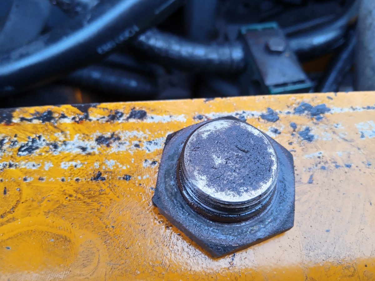

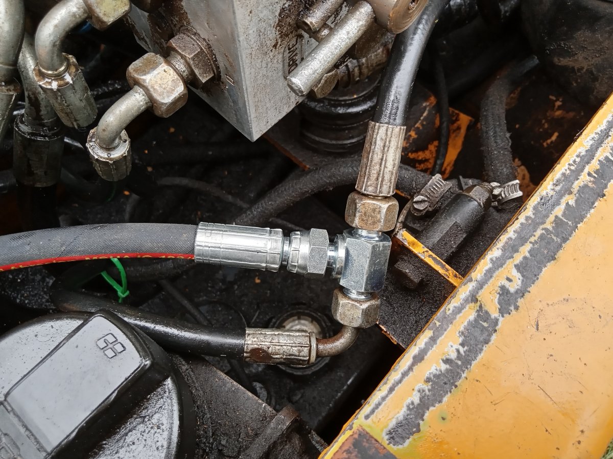

Hi Mick
Tried that ( see photos) no difference

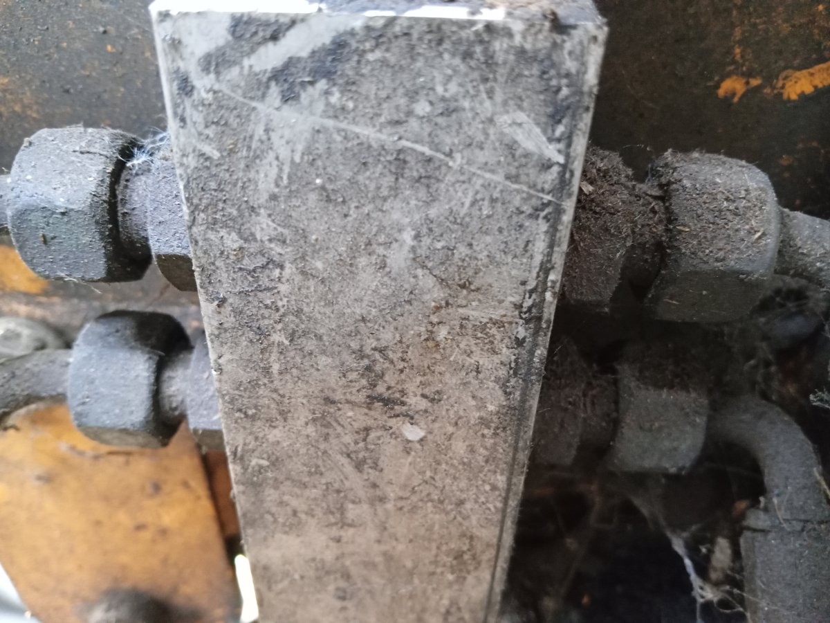

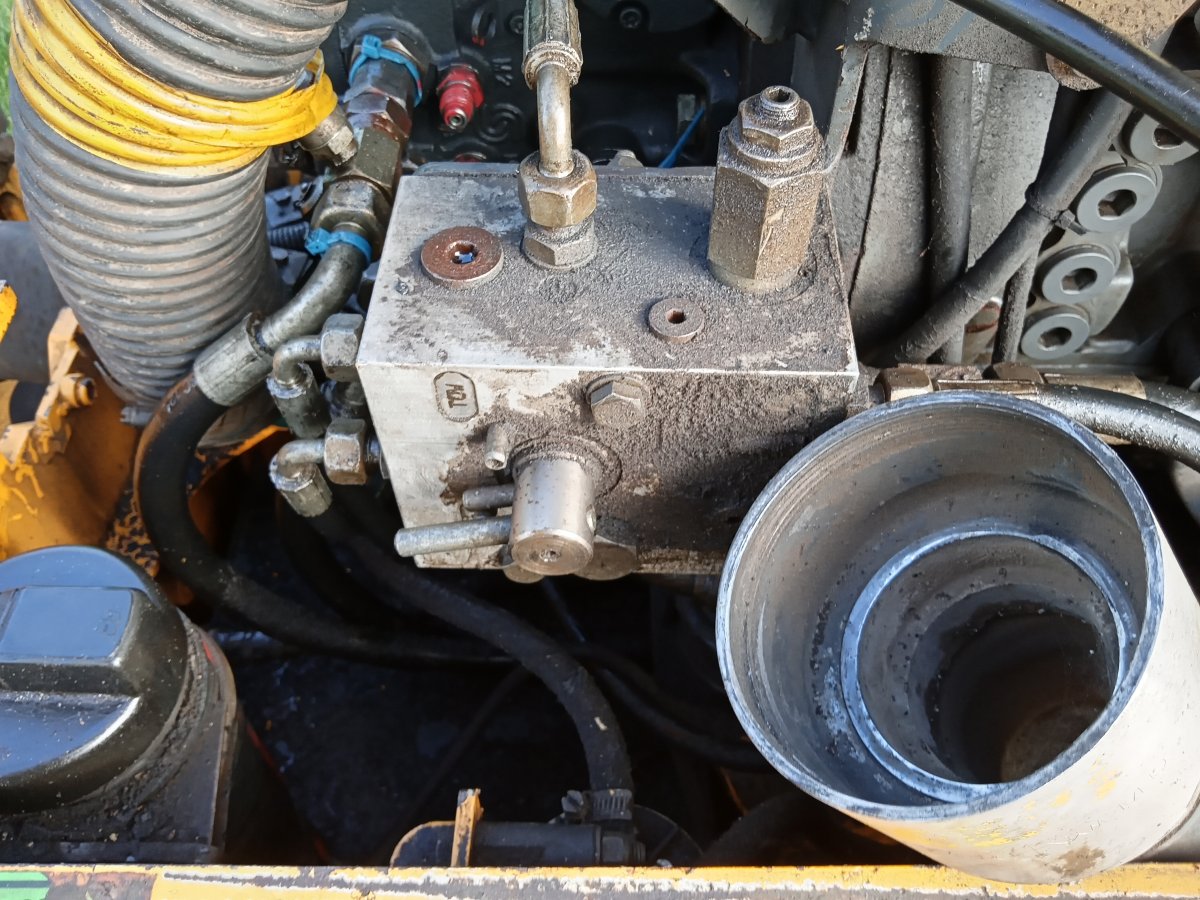

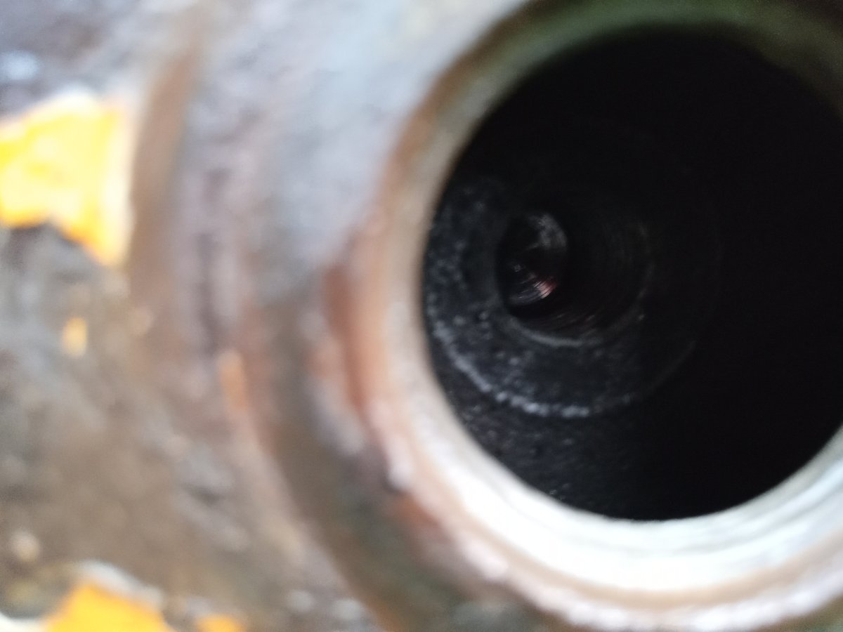

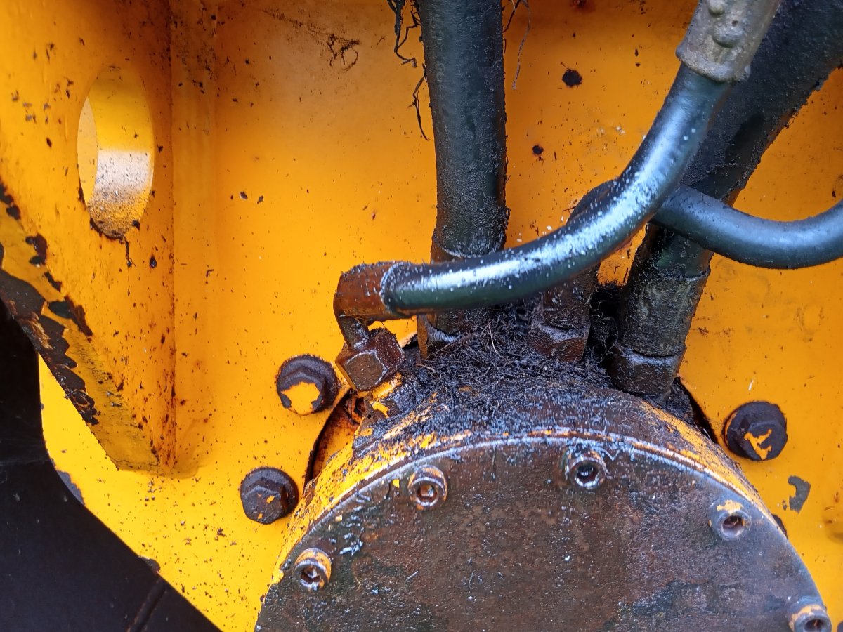

As I remember! There is a thread inside, that when using a large washer and bolt or threaded bar M16 I think! And a nut you can thread the bolt in through the washer and wind the nut down the bolt pulling the brakes off! Do back and front, then see if you can drive the roller?
Just a question? was there an issue with before you had it refurbished?
Steve Tivey
Steve Tivey
We were using the roller when suddenly we lost drive. no deterioration just no drive
When we rev the engine it does just that the engine does not pull down which would suggest stuck brakes or jammed wheels
So the bolt goes through the hole and screws into a thread in the machine, the washer rests on the outer plate, then a nut pulls something towards it releasing the brakes???

Put everything back to standard, wind the brakes off like I have sudgested with the studying or long bolts and nuts and washers👍🏻

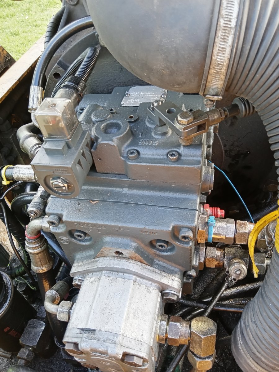

Mick the Fitter and others
Can I thanks everyone for their help and precious time.
In a pub conversation, I was introduced to one of John Deere`s top engineers.
He came and had a look and within 10 mins she was rolling.
The problem was/is the front drive pump is broken, however both drives are linked so all pressure was going back to the tank. This link was broken and the rear wheel drives.

A good result, if oil is going back to tank! The drive motors are in series so I would suggest the drive coupling is broken between motor and drum!👍
