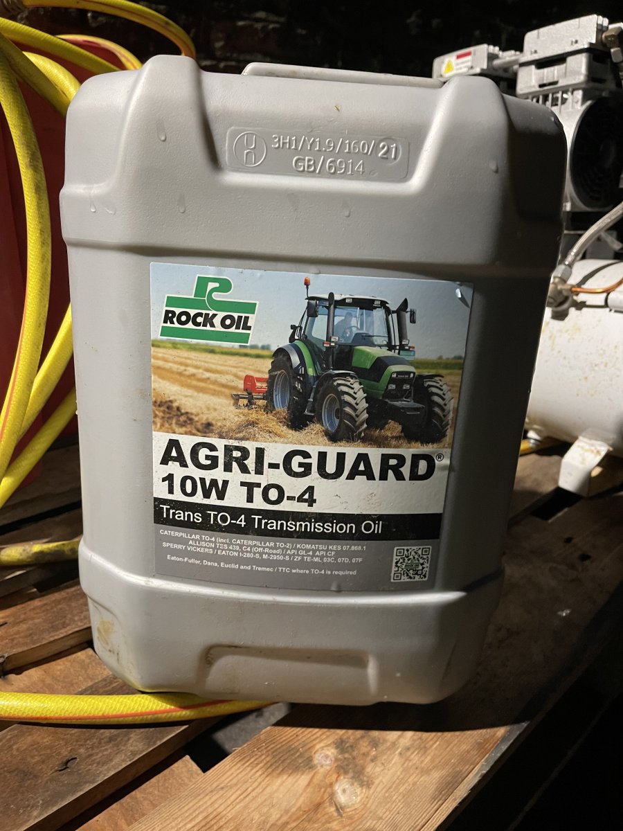

Guessing she’s a shuttle box, what oil did you put in the transmission?
Justino

This can double as a UTTO oil so should be ok, is it any better driving hot or cold?

UTTO can be clear or dyed(red) there is a pressure switch on the box you could find someone to do a pressure test on the box!
