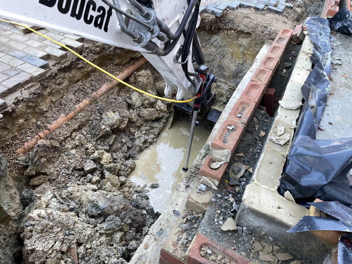

Found this post when lookingWell speak of the devil. Guess what I got called out to today?

If its just smallIsh amounts of water, I’ve been very impressed with the Milwaukee 12v pump stick for emptying the bottom of footings etc. it has a pretty good filter system at the bottom of the stick. Worth a look, wins for me on convenience and is also pretty effective.
Basically if the water is coming in as you dig then you need a petrol diaphragm pump. But for pumping out once or twice a day then the pump stick and possibly a cable tie for the trigger is pretty nifty. It may even have a lock switch, can’t remember.
