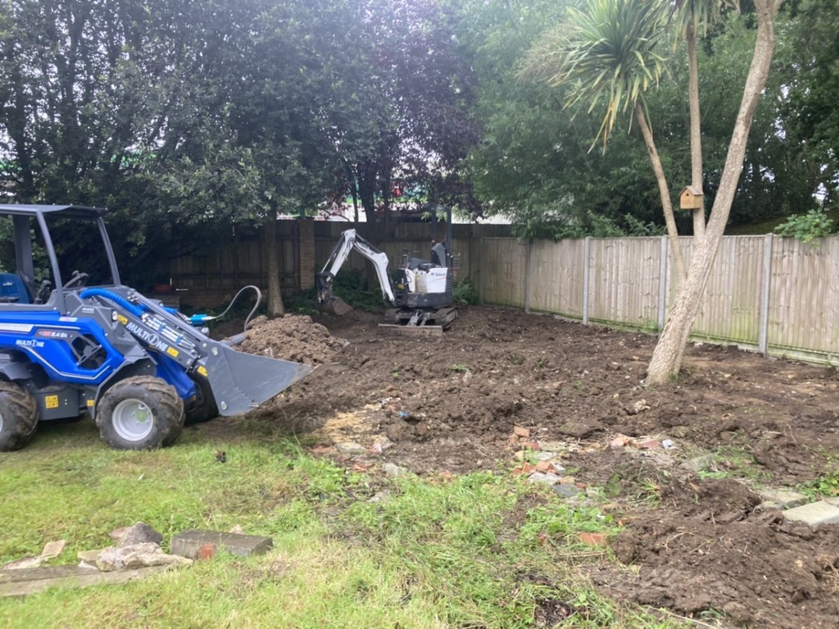

Well it turned what would have been a two day job with digger and power barrow into home by three.
I took the micro there on the Iveco and the MO in the trailer with digger buckets and pallet forks in the loader bucket. Any loss of efficiency from the smaller digger was more than offset by being able to pull it out into a windrow, then scoop up and tip exactly where I wanted it. I can’t believe what a difference this made. The most painful part of driving a micro is the slow slewing round with a tiny bucket and lack of height/reach when dumping- all I had to to here was grub it out.

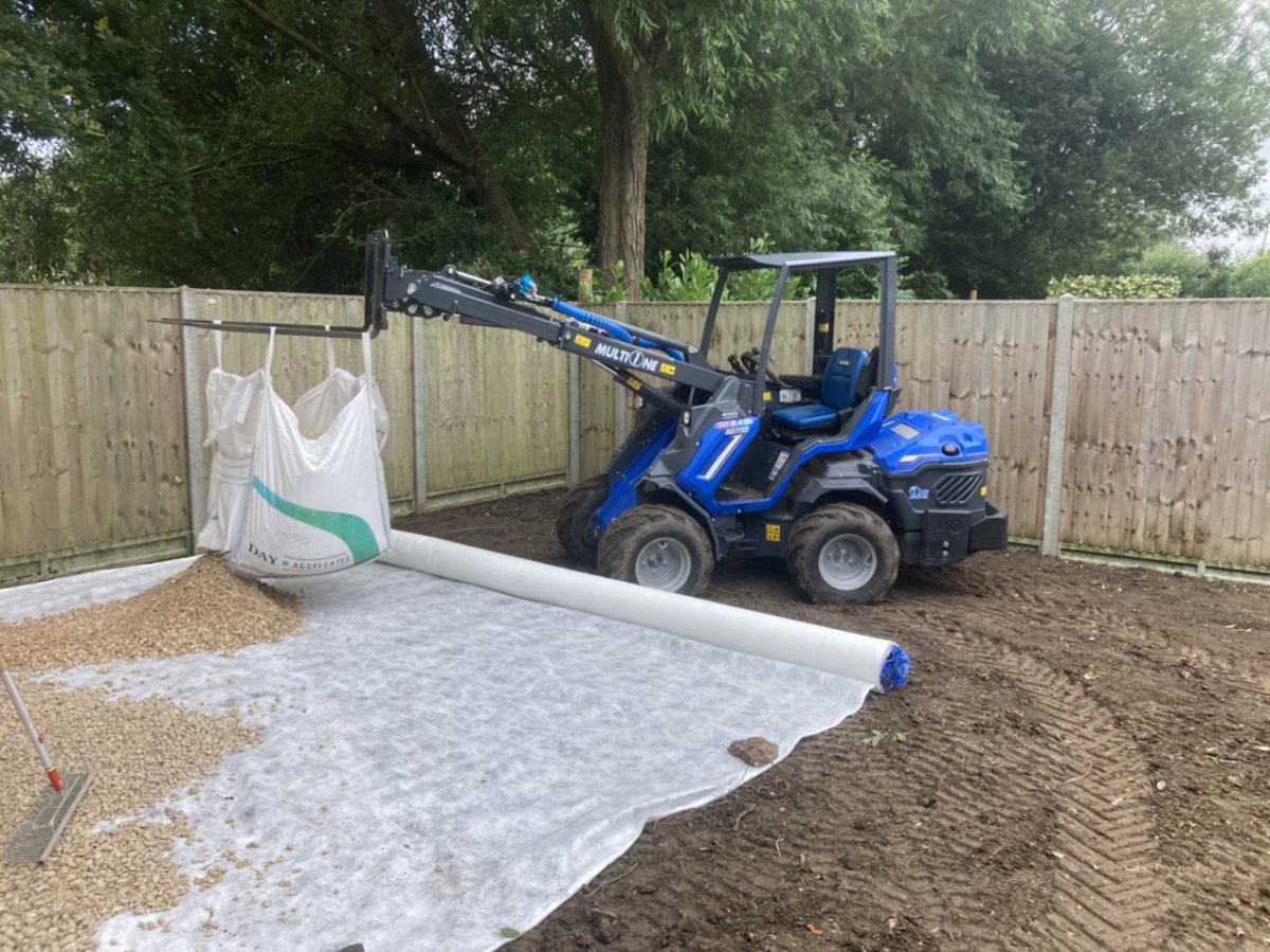

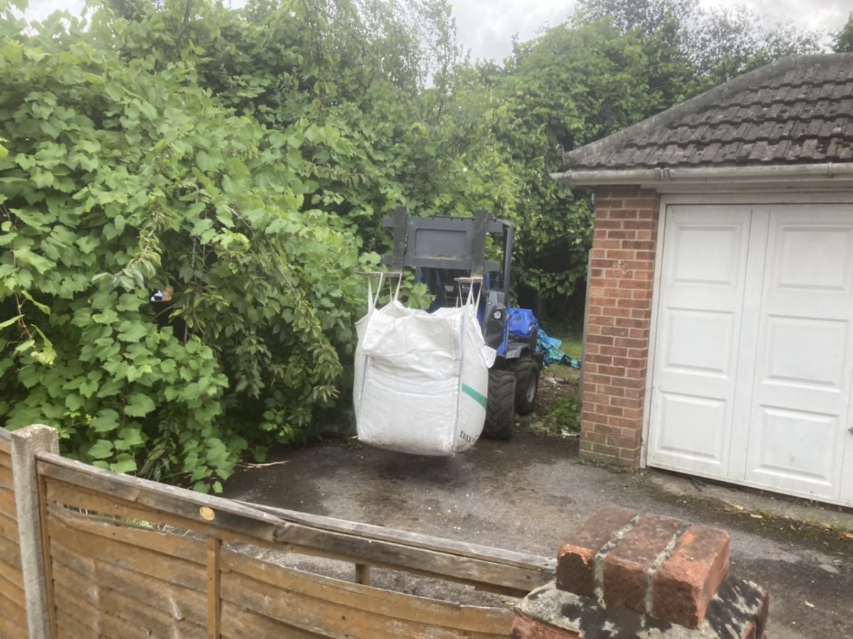

Then six bulk bags in through a tight corner access with the only drama being the shitty state of the bags 🙄
Day rate hire before anyone comments upon lack of sub base.

nice cordyline Doob :giggle:(y)
want to get yourself some tubes, to either, slip over the forks to give the bag straps a much easier life, (blue/yellow placcy), or a pair of steel tubes to span across the tynes (114 x 4 or 5mm CHS )... drop the forks either side of the bag's loops, slip a tube through and across to sit on the forks and lift .... so much easier than threading the tynes through the loops
Or just use the fork slots in the bags

I wouldn’t have needed to worry if they hadn’t sent shitty bags that had obviously been sitting in the depot for years! One was only half full and wrapped in shrinkwapp ffs. Luckily it was customer ordering them.
Pallet forks are fine for a one time lift of a bulk bag that your gonna cut anyway.
