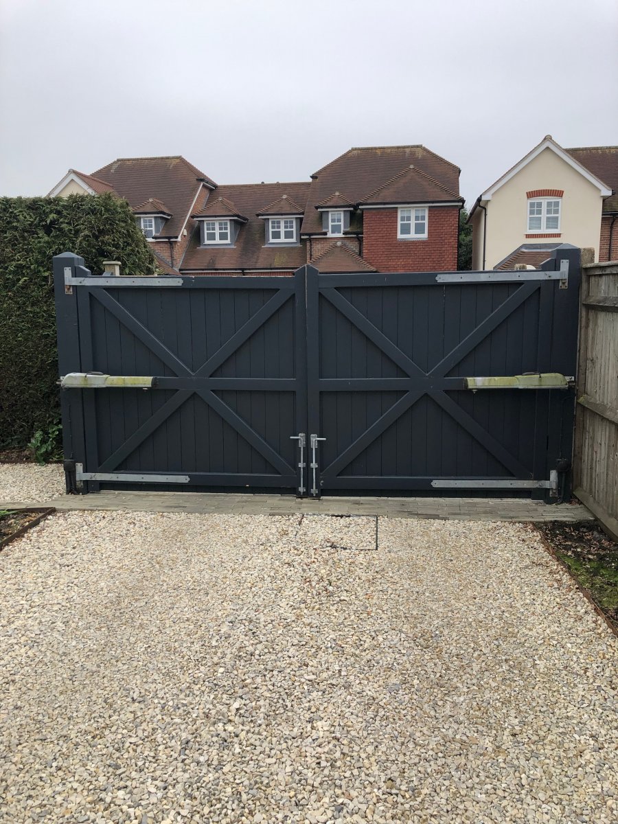

Anyone got knowledge? The Internet is full of Ciinese imports and one man bands claiming to be the best.
Two very heavy (hardwood) 6'x6' leaves, hung upon 8"x8" oak posts. To be operated by remotes.
Do I want 24v or 230v? Can someone recommend a good reliable model of sufficient power?
