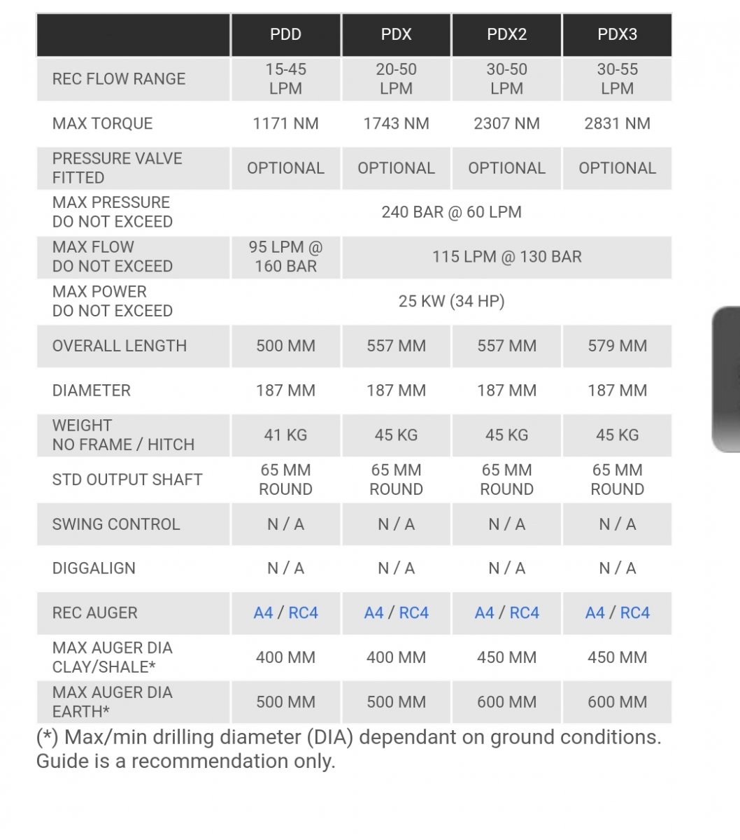

Maxus
I've used a pdd2 from the hire shop, worked a treat with 200mm flight. Says for .75T to 1.5T.

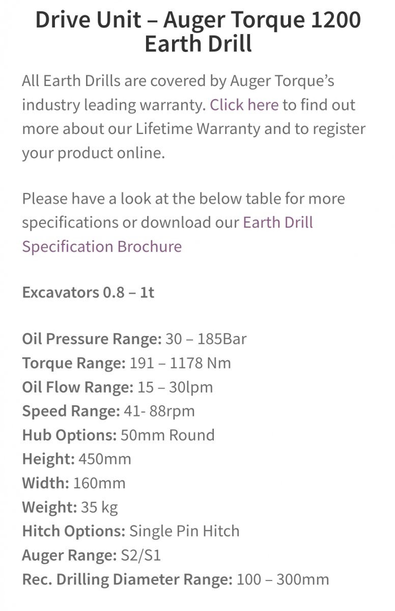

Maxus
Or the other option, Auger torque 1200 which is a bit smaller.... 0.8 - 1T

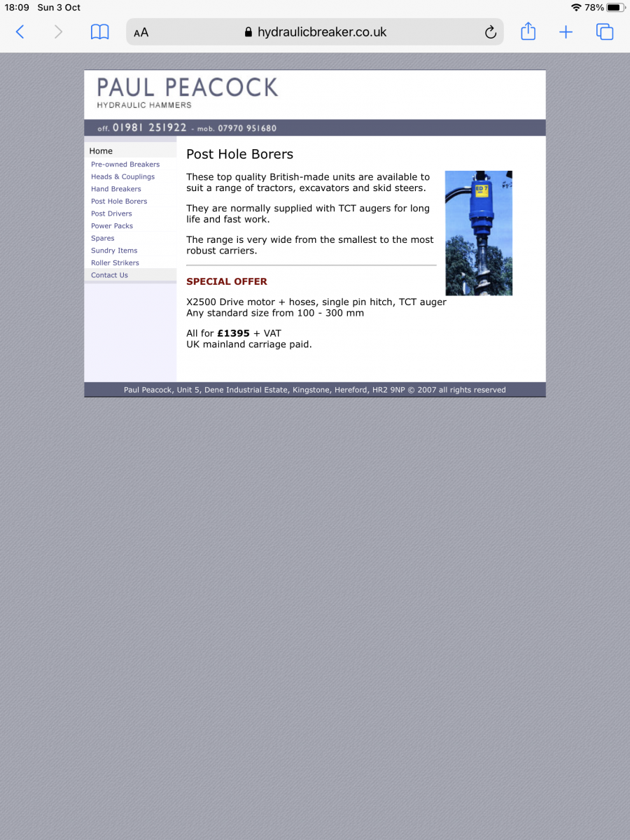

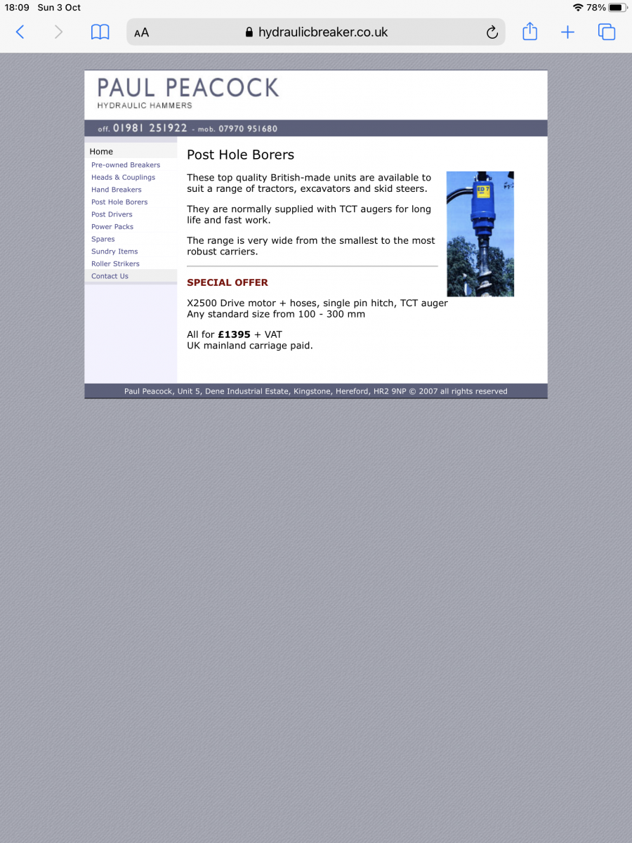

bobthebuilder
I have a augertorque 2500x on my taki 125,fab bit of kit ,done a couple of hundred holes now ,all good ,was 1450 all in with a 150mm tungsten tipped bit ,from Paul Peake hereford
Maxus
That's a good price from what I've seen. Does Paul have a website or business name?

yep thats him ,he delivered mine as he was in the area ,mad as a box of frogs ,but proper nice fella
I have a digga auger as that's what you got years back when you bought a taki micro with buckets hammer auger and trailer as a complete set. Tbh the limiting factor is the machine flow at the small end of the market i can't see brand of auger making that much difference provided you buy one matched to the machine (or if you envisage a slightly bigger machine at a later date try and buy one which would suit both). It'll likely come down to price and what you can actually get.
Try and get a cradle hitch if poss. The dangly setup without one is a bit of a pain when tracking around site
