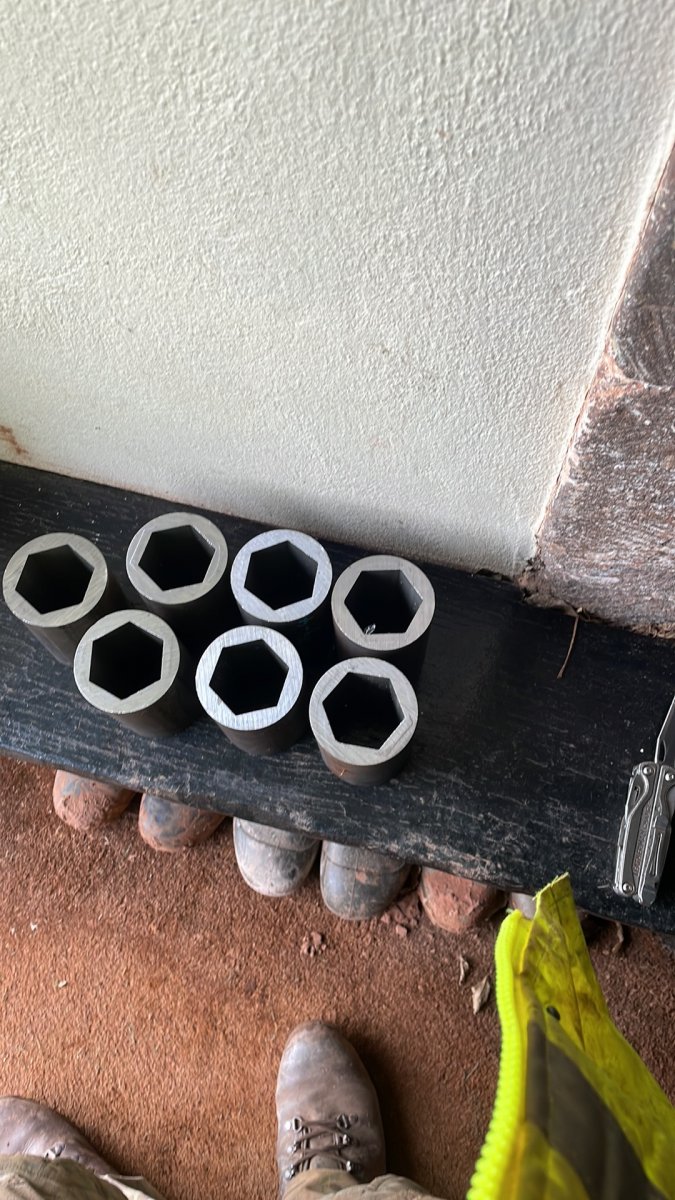

about £100 a meter so not a huge price increase from what you paid. I’ll pop a couple more photos on once I’ve got them welded up.

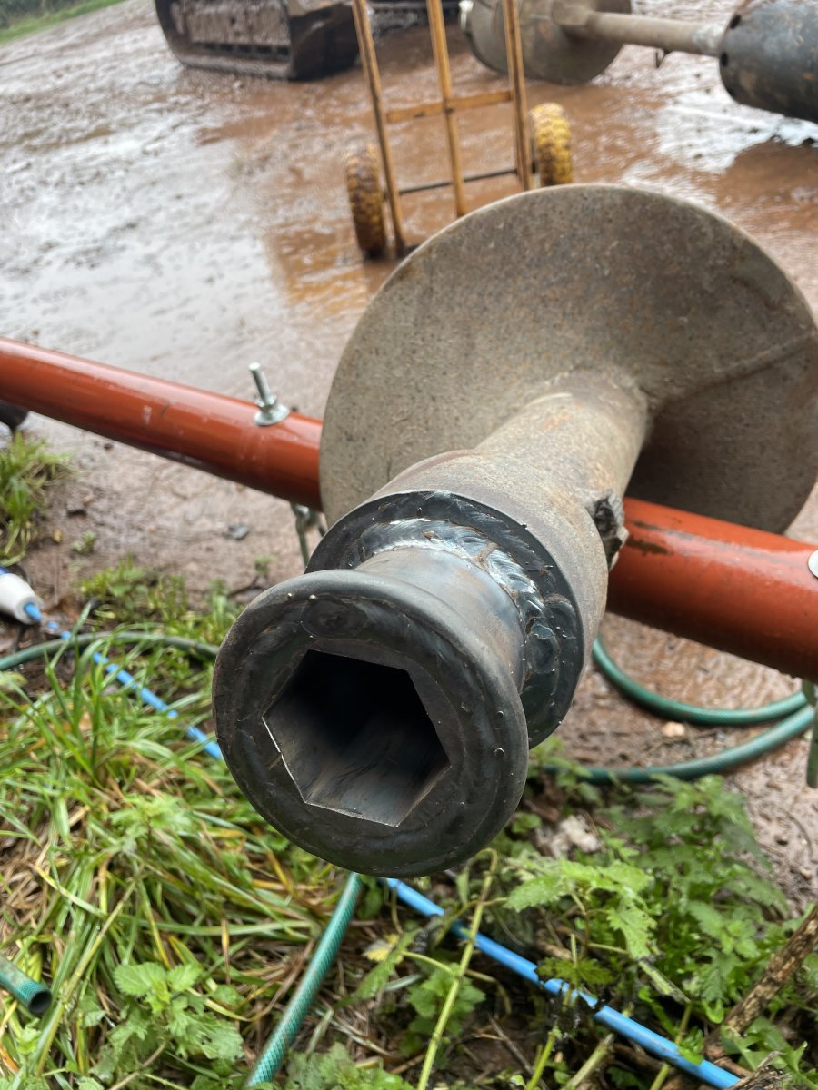

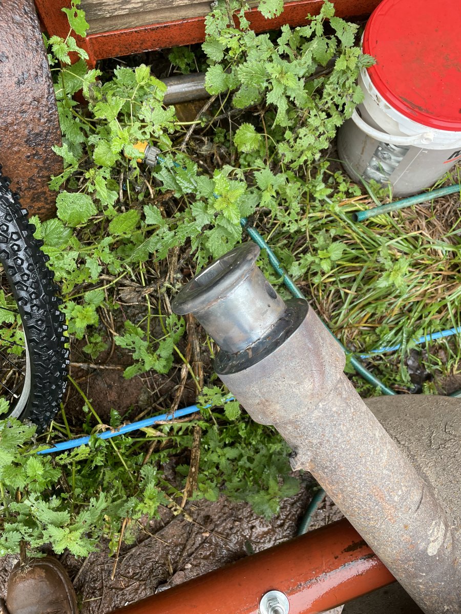

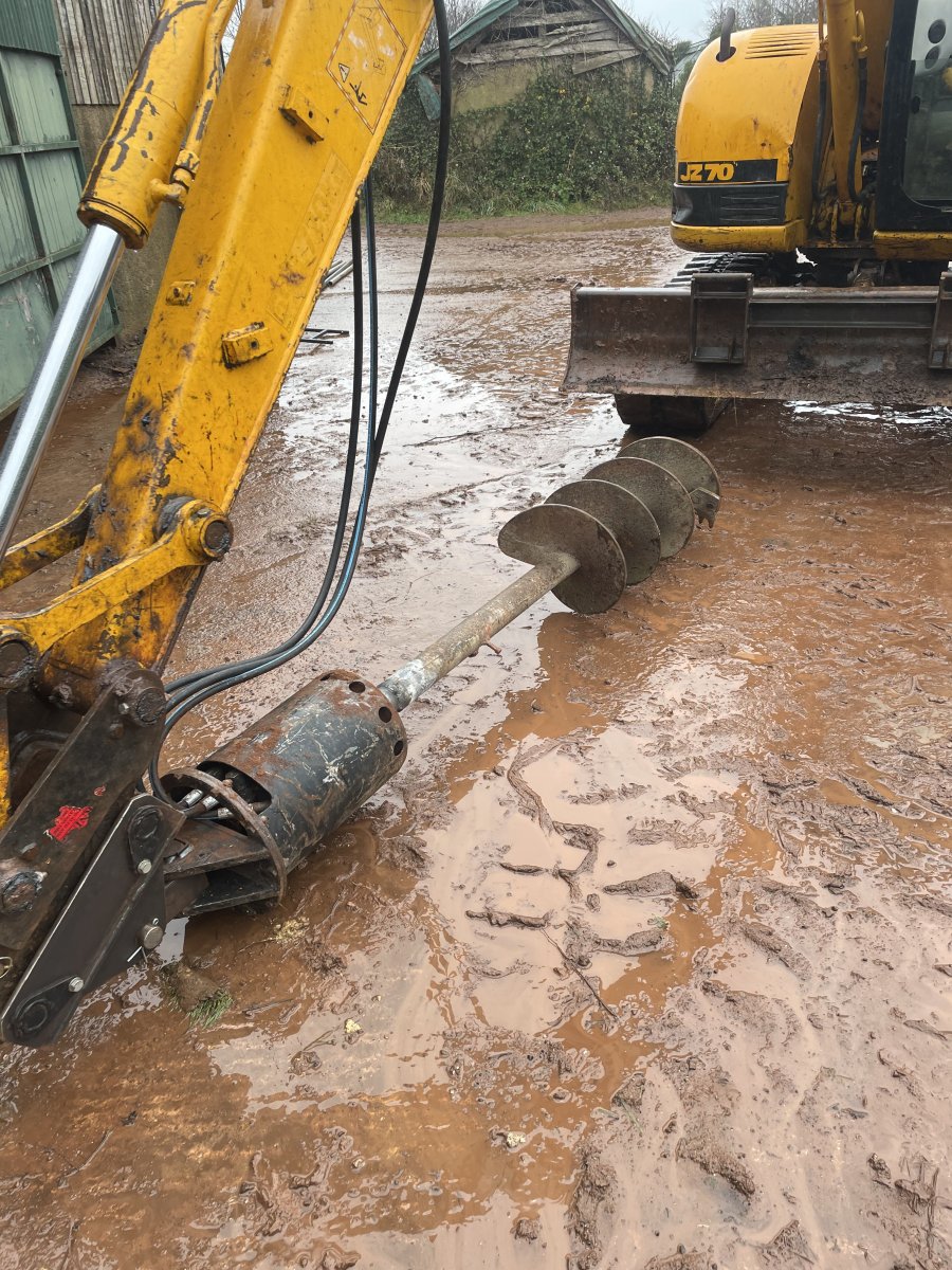

All welded on and up Monday morning and bored about 10 or so holes with the big auger now, met some big rocks and all held up.
Wrapped a peice of 12mm round around the top for a bit of strength, would have rather some flat or square but it was the best fitting that I had so went with it.
