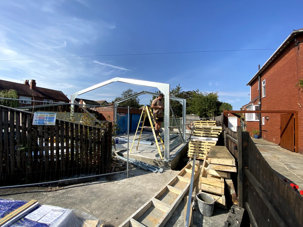

Small sheds, we did a few of the cold rolled sheds on a few tight sites. Supplier had loads to go at but wanted us to travel all over.To be fair the guys who build my sheds have a step frame low loader.. but they use a telehandler and mewp for everything

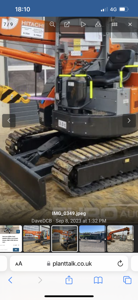

Wouldn’t that be lift capacity? Could be anything if it’s in Euro auction’s TbfSays 3.0 T on front?
did see that ..... I would guess that's it's capacity/capabilitySays 3.0 T on front?

Exactly that. Been vague is best description.Wouldn’t that be lift capacity? Could be anything if it’s in Euro auction’s Tbf![]()

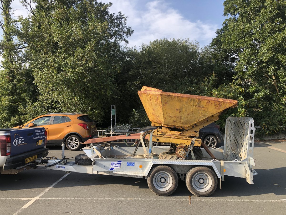

Got it in the trailer …. Not to get it off and see if it works as intended.

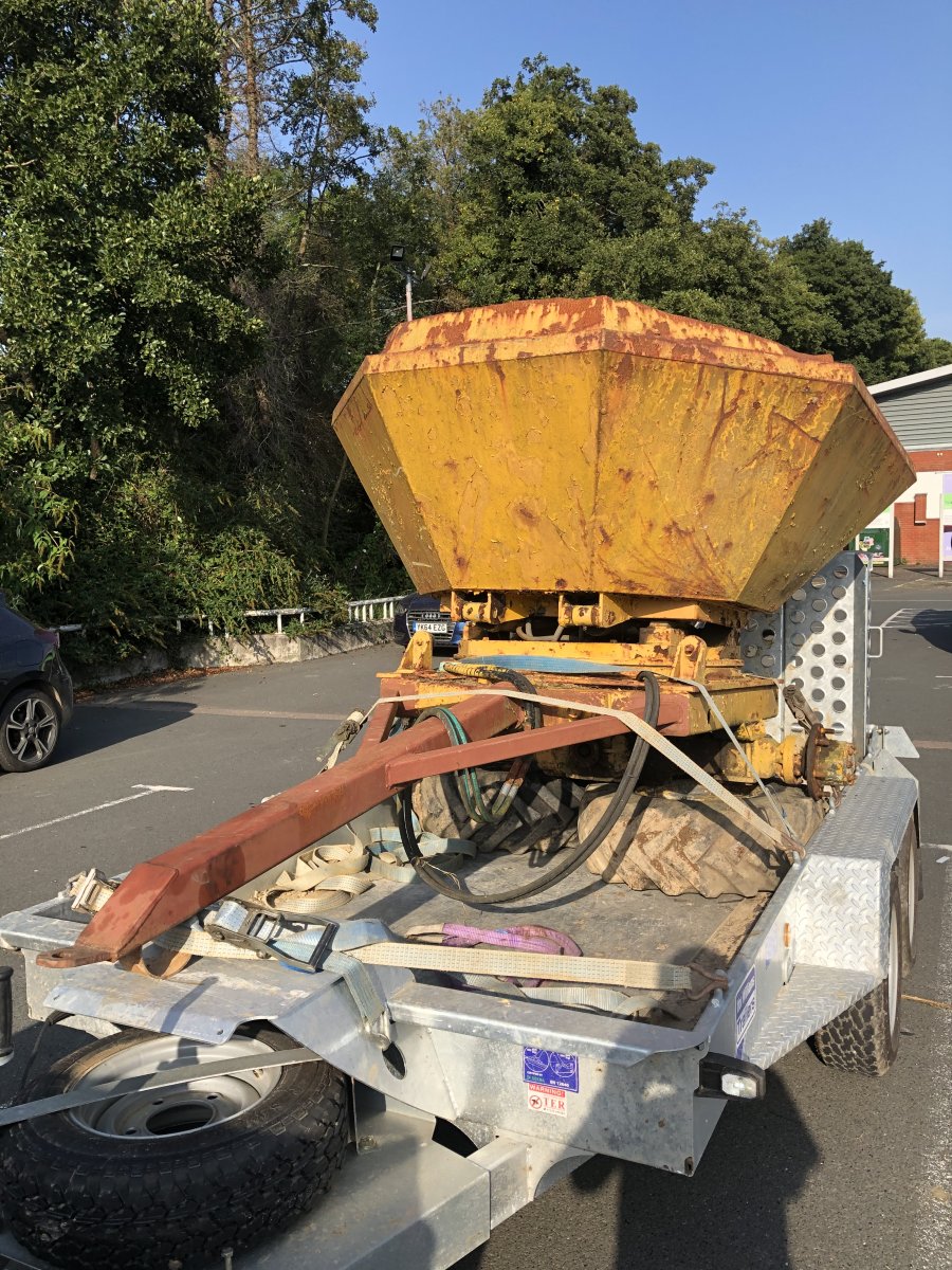

Using it behind father's little Tafe 45. Need to wrap my brain around hydraulics as 2 pipes on trailer for tip. but only one on back of tractor. Its got a loader with aux circuits so I'm sure it's sortable one way or other. Not fussed about the swivel function on dumper as I think it might be a bit inclined to fall over. Seller made the trailer when the engine blew on his dumper. Air cooled? He says it was 3 ton and I'd trust him as he's a very experienced plant mechanic in his day job.What’s it going on? Also never seen a 3ton with twin ripping rams?
you may well have a two way service connection on the arse of yon traccy, (a P and a T connector),apart from your one way with return to tank for a single acting ram ... but they'll need a two way valve to make the tip rams work on the new acquisitionUsing it behind father's little Tafe 45. Need to wrap my brain around hydraulics as 2 pipes on trailer for tip. but only one on back of tractor. Its got a loader with aux circuits so I'm sure it's sortable one way or other. Not fussed about the swivel function on dumper as I think it might be a bit inclined to fall over. Seller made the trailer when the engine blew on his dumper. Air cooled? He says it was 3 ton and I'd trust him as he's a very experienced plant mechanic in his day job.
Thanks. I don't understand... but I know a man that will... annoyingly I'm pretty hot on hydronics, but hydraulics not so much. And deffo only one pipe on arse of tractor.you may well have a two way service connection on the arse of yon traccy, (a P and a T connector),apart from your one way with return to tank for a single acting ram ... but they'll need a two way valve to make the tip rams work on the new acquisition

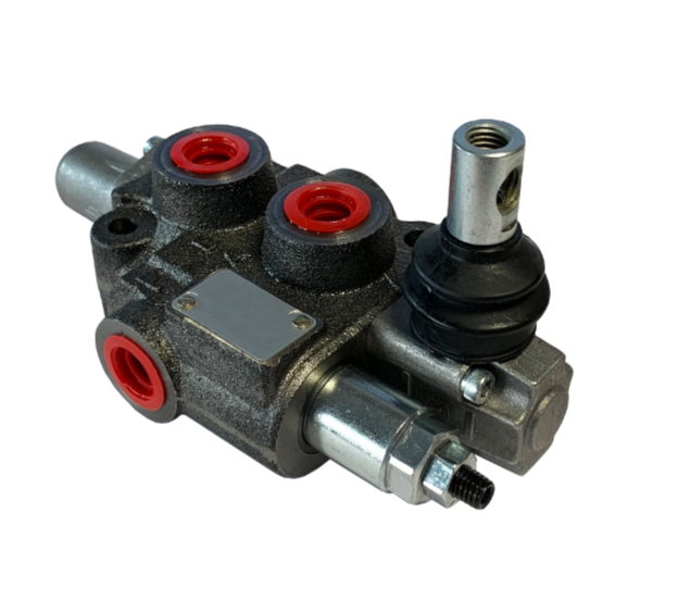

the P & T lines from Traccy go to the P&T on the valve .. the tip rams'll need tee-ing together (two 'up' ports together, two 'down' ports together) and the single lines from each will go to the A & B ports on the valve
you're going to have to run a P & T from your loader services then, unless you have a spare slice on your loader valve ... just tee into the P&T supplying the loader valveThanks. I don't understand... but I know a man that will... annoyingly I'm pretty hot on hydronics, but hydraulics not so much. And deffo only one pipe on arse of tractor.
