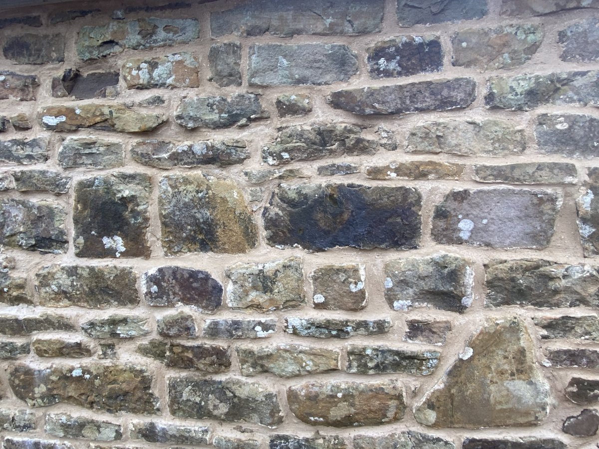

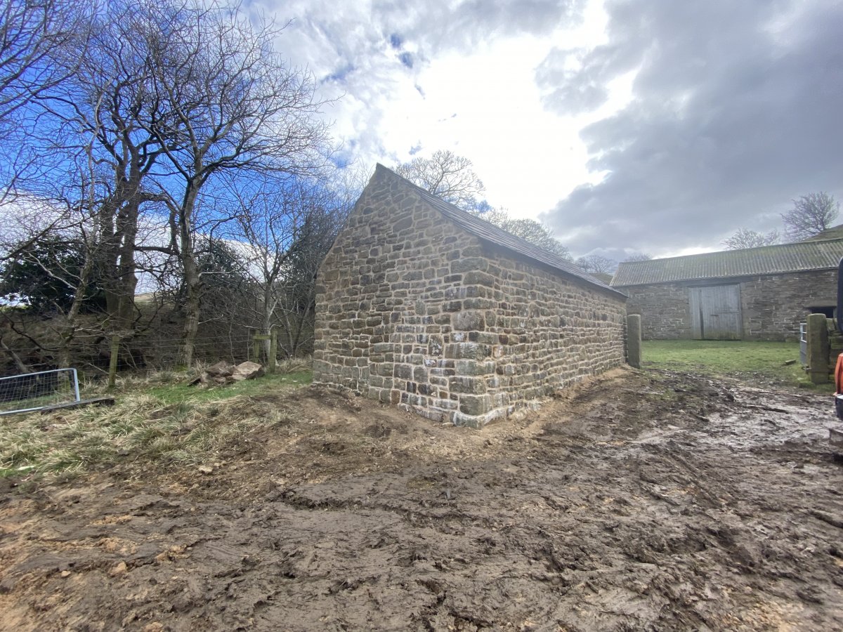

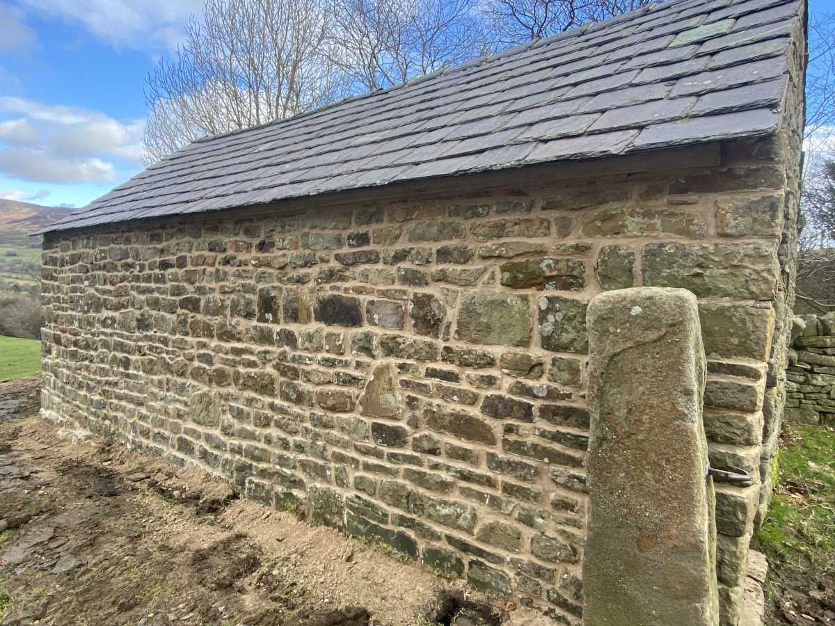

We do a fair bit of lime work we use pfa as a potsan to aid setting times and strength, special grit sand, nhl 3.5 and a 3-5mm grit
