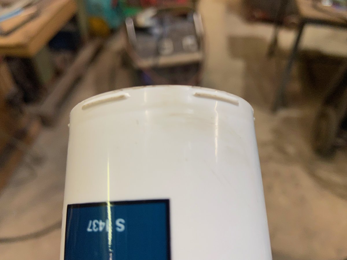

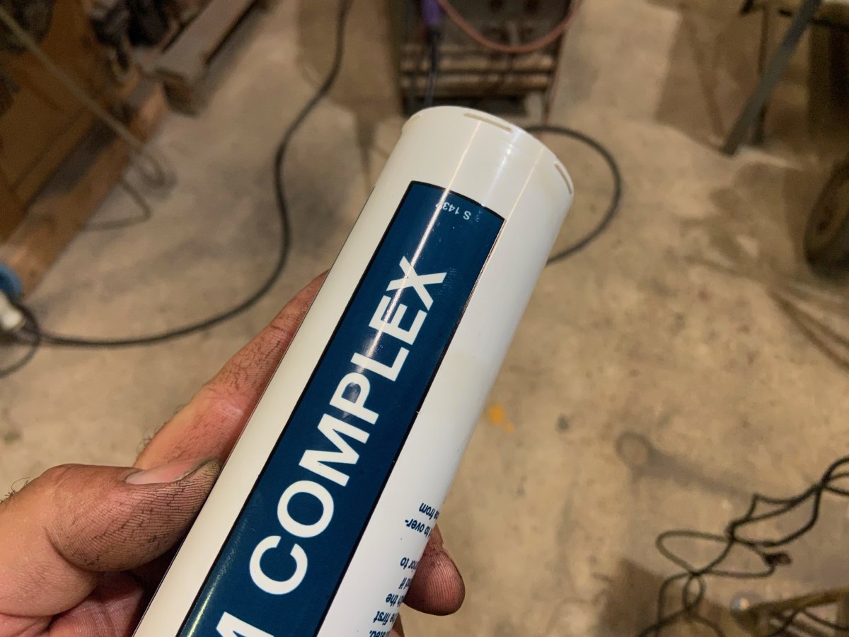

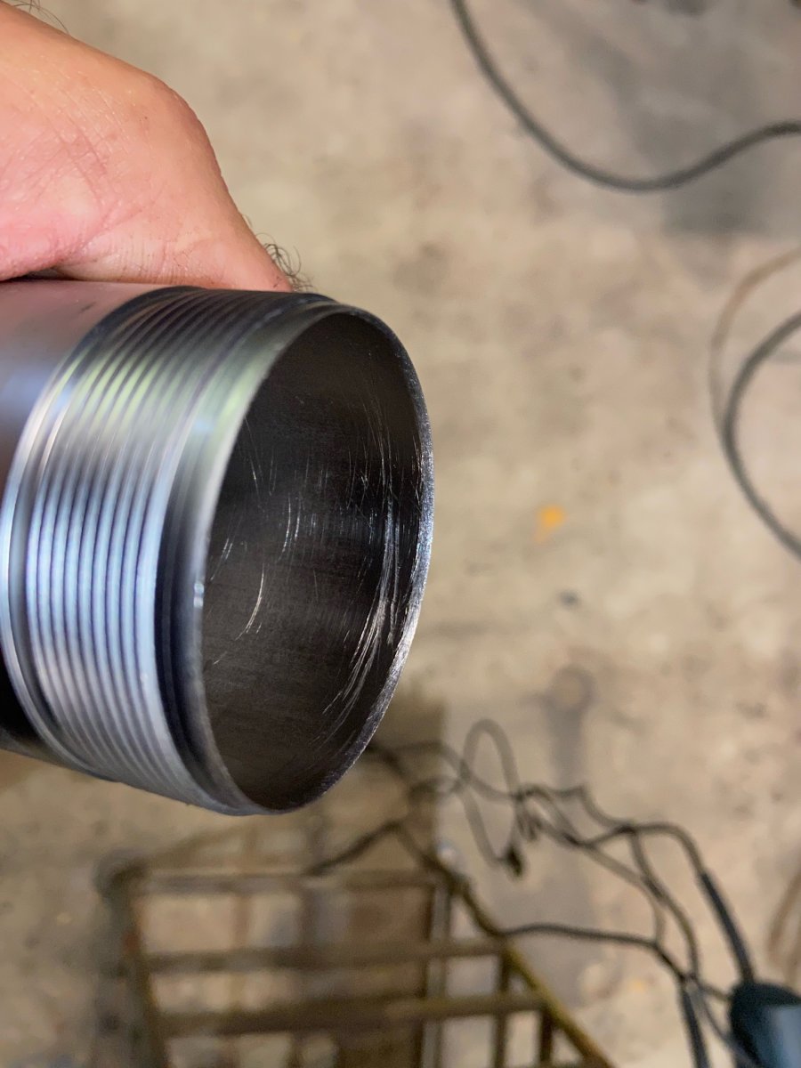

Reviving an old thread, but thought this was worth sharing.
Makita finally released the proper battery grease gun a few moths ago and I bought a couple. Honestly they’ve sat in the shed until last week when I finally got round to putting a cartridge in one and giving it a go. I put G Couplers on them both, for anyone doing the same they are M10 and not BSP, just for reference.
First impression was, it is a bit of an arse to get the cartridge in the barrel fully (enough to screw it in) without getting in a bit of a muddle, but once you know what’s going on then it’s ok. In operation it works brilliantly, very fast and if you really want a battery grease gun and run the Makita platform then it’s a good bit of kit.
BUT the joy soon turns to frustration and anger once you need to get an empty cartridge out of the barrel! Maybe not all cartridges are the same? But of the two brands I’ve got, both have small ridges around the end, I’ve noticed them before, no idea what the purpose of them is? I assume they are intended to keep the cartridge from sliding into the barrel, but every gun I’ve ever used let’s them go in past the end regardless. But whatever they are for, they are there. Anyway, once you get a cartridge in the Makita gun and screw it in, the cartridge gets pushed fully into the barrel. Due to what I can only assume is a manufacturing oversight, the cartridge gets pushed past a tiny ridge/lip around the edge of the barrel and it’s is a total PITA to get out! Cartridges can sometimes be a pain to get out at the best of times on any gun and messy too if your not careful, but this is just feckin ridiculous!
So......my advice for anyone choosing the new Makita battery grease gun, do it, it’s excellent, BUT before you get a cartridge anywhere near it, trim that bloody lip off from round the edge of the barrel! Five minutes with a de-burring tool and I had it sorted on the second gun, but I wish I’d have know that before I put the grease in the first gun!
View attachment 26715View attachment 26716View attachment 26717
Sorry, I’d trimmed it out before I though of taking a pic 🤦‍♂️

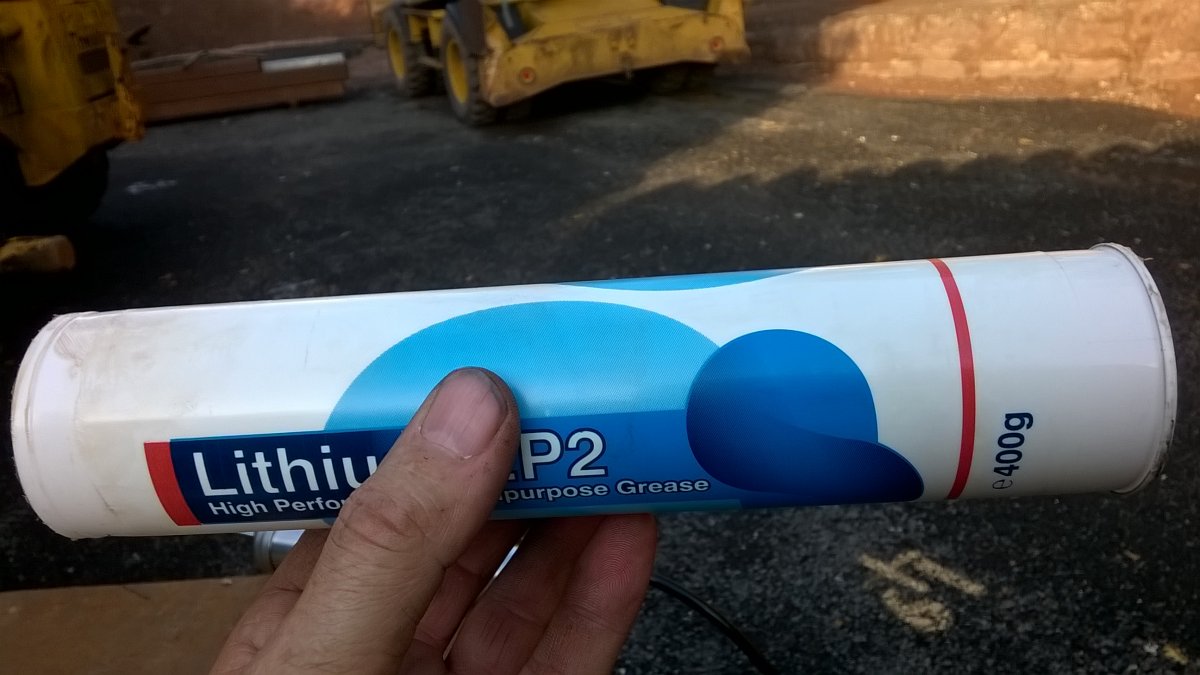

cartridges I use have a full ring around them to slide home against the body James

Don't screw the body of the gun in tight just a very gentle nip is enough so the lip stays on the outside of the barrel it makes pulling the cartridges out easy though admittedly some cartridges have a better lip than others
An old boy I knew would trim the lips of the cartridges with a Stanley knife or a file
