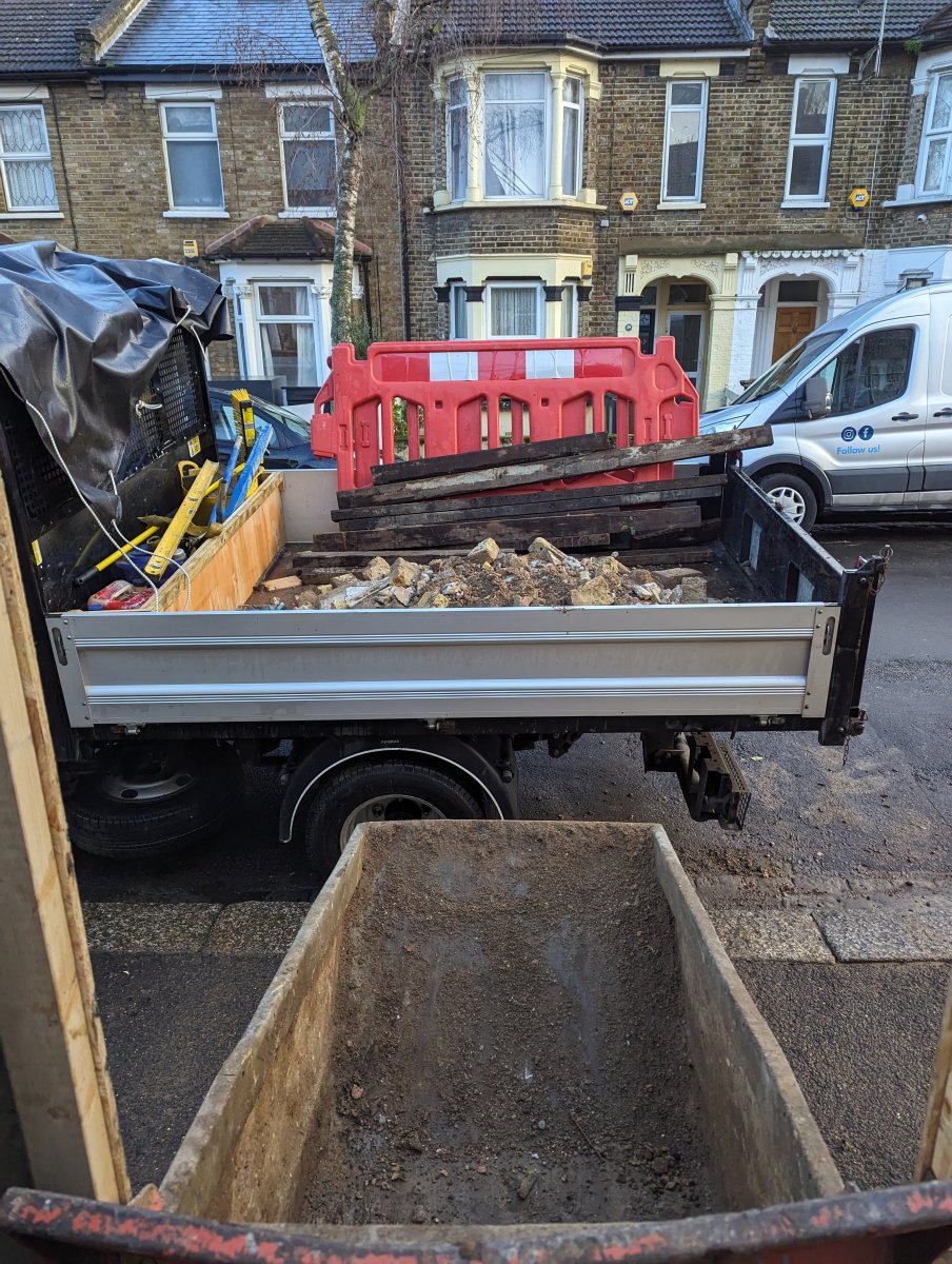

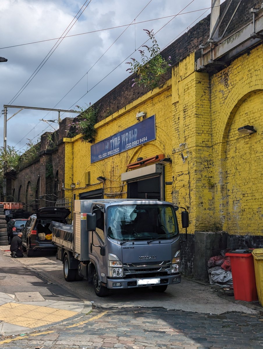

Looking into doing this on my Isuzu Grafter as it squats a fair bit when loaded. Would like to have it sit more level and be a bit more composed...

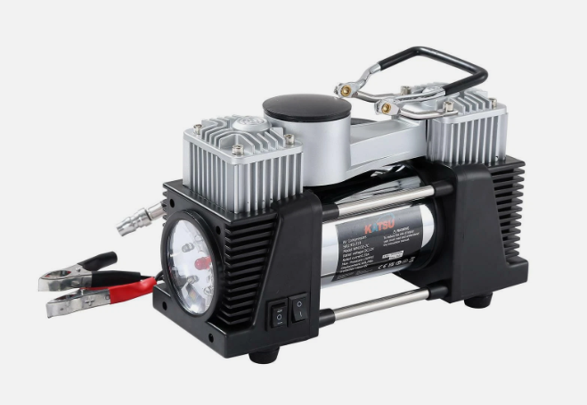

I'm thinking I could keep an 18v tyre inflator in the underbody boxes rather than having an onboard compressor set up which looks handy but £££

I'm guessing as you've the long wheelbase you've the extra leverage.
Mine seems to be fine but I do sometimes wish we had the utility version

Mine is SWB too, the tool lockers are awesome but it means the bed is sat too far back - there's more bed behind the axle than in front. Takes a bit of thought to load it in such a way it doesn't want to wheelie down the road.
Probably makes the squat look worse too as a 1 inch drop at the arches must be 3 inches at the tow bar.

cheap enough to hardwire in to the truck with a non return valve in the supply line and a solenoid valve to maintain/control/decrease the air pressure ...... and have an onboard tyre inflator to boot with 2.2cfm output
