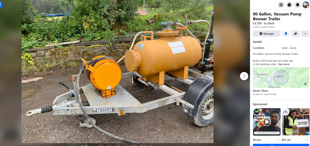

I am still toying with the concept of digging small complicated holes more efficiently/safely/easily. Usually around water meters or up against the side of a house or around other services. Air Spades seem to be very messy from the feedback, and need a bigger compressor than mine. Hydro/Suction systems seem more applicable. Pressure washers are easily obtained/modified, but the suction bit more difficult. I have considered units like this, but emptying solids would be the issue. Would need the tank mounted at (or tiltable) to 45 degrees with a easy open clean door at the end for scraping out into a barrow. Ideally high enough for a tipping IW trailer. Does such a think exist on the UK market that is tow-able?

There are a whole range of trailer or tracked mounted vac excavators available, but the price would mean they need to be working all day every day. Definitely an up and coming market.

These are all air units.. I have requested a price for giggles. Guessing 50K?
