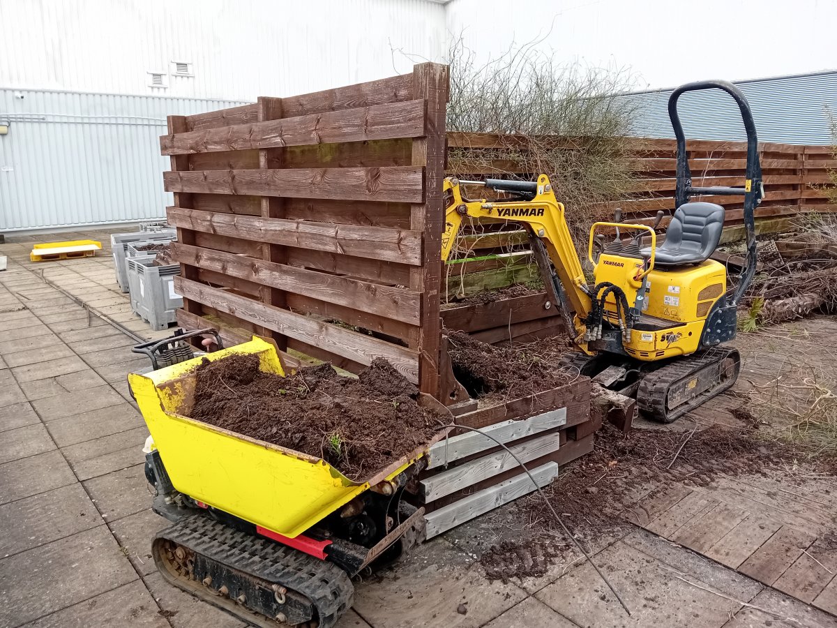

For domestic work I'd say go 1.7-1.9 zero tail, coupled with a hitip track dumper. I have a slanetrac which is great but I recently picked up this little cormidi. The slanetrac is definitely better but is a lot more expensive and a lot bigger, whereas the cormidi will comfortably fit in the plant trailer with the 217r.

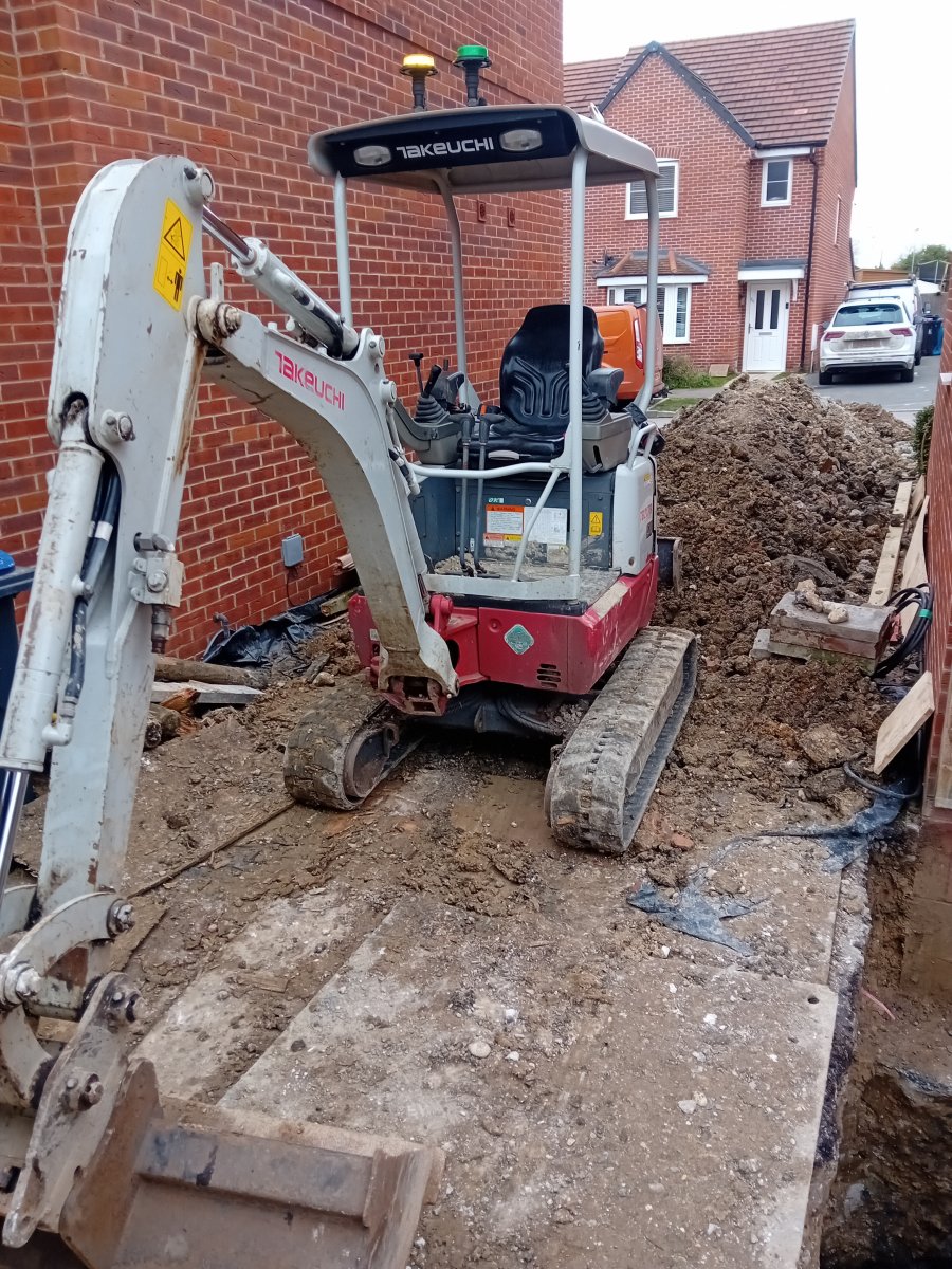

I know this job is rough as arseholes, it’s a Saturday morning day rate job.
But it shows what I mean- far too much for a micro to handle, but too tight around the side of the house (and also at the front when I add more trenches) for a 2.7t.
Handy having a big enough machine to run the grab for moving the concrete also.
1.9t really is a sweet spot for domestic groundworks.
