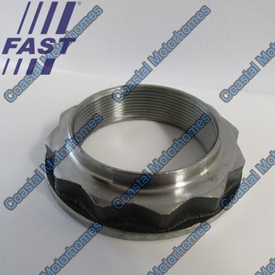

72mm 12 sided socket
Can't help wondering how they are measuring that 72 mm on a bi-hex hub nut 🤔
If I could lay my hands on mine I could tell you the exact size....I'm definitely not stripping down the current one to measure it tho 🤪🤪.

" The Iveco Daily 35 utilises a removable stub-axle on the front hubs. This stub-axle is held in place by a castellated ring nut - " interesting idea

There is a lot of ivecos on the road and the 5t shares similar parts with the 3.5t, would safely assume as there is a huge lack of available sockets in that size, they can't have measured it properly
Wouldn’t be the first time a manufacture decided to make a part which then needed a custom tool to remove it…
but I agree chances are its not 72mm…

I'd be very interested to know of a tool supplier who is prepared to make a one off at such a good price.
The £130 ish +vat sounds spectacularly good value 🙂
There is one just a couple of miles from me...they will make alsorts of sockets to suit.
