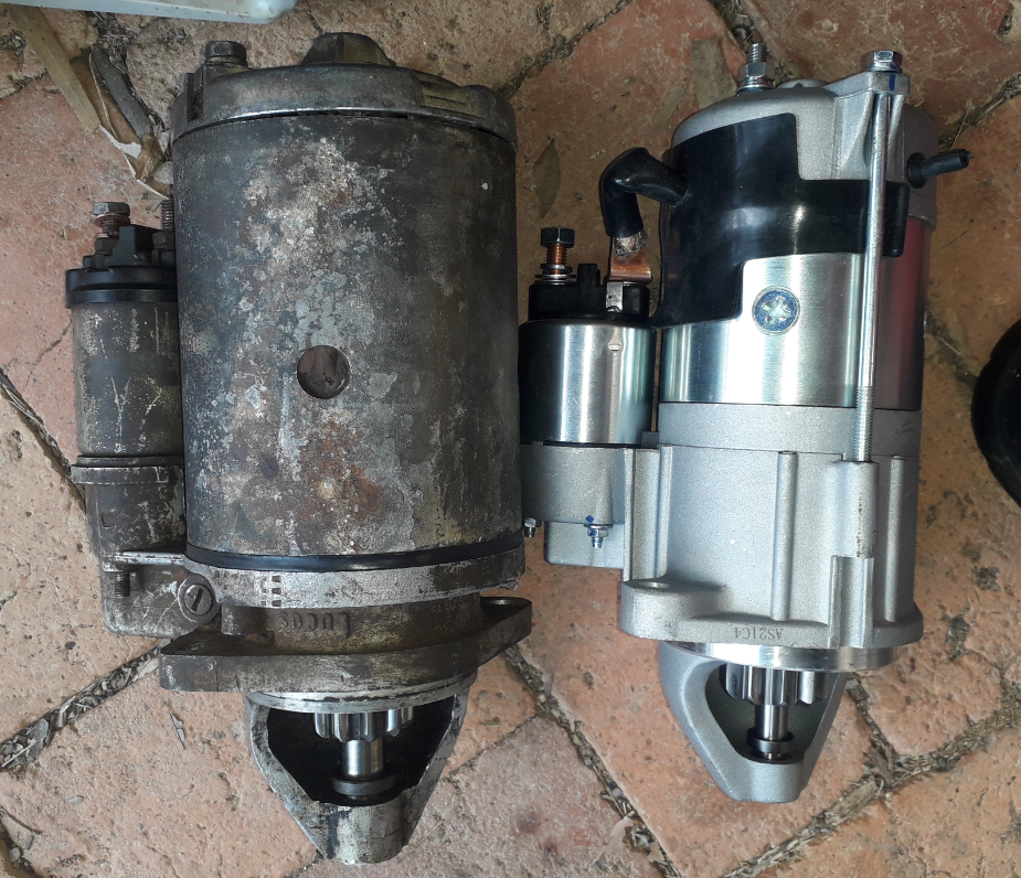

For the next person deciding between the original direct drive and a reduction drive starter, here is the physical comparison.
The new starter draws 500Amps and seems to frighten the engine into starting.
Apart from anything else, the slimmer body allows you to get a socket onto the mounts making installation so much easier.

This one is rated 3kW and I measured 500Amps while cranking.
I didn't measure the terminal voltage, but assuming it was pulled down to 10V.
That works out to 5kW from the battery resulting in 2kW being turned into heat in the motor.
2kW in an un-ventilated motor will have a very fast temp rise.

Due to the reduction gearing the torque is very high, so when something goes wrong it is catastrophic, in replace on recently on a 2010 Deutz engine, the old direct motor chipped a pinion tooth, I thought I had got all the chips out but one bit must have been hiding in the bell housing, started ok for a week, one morning the call came that the starter had gone again, when I removed it I found the pinion housing sheered completely off the motor, bits of metal everywhere so bell housing off.

I thought I had got all the chips out ~ found the pinion housing sheered completely off the motor,
Thinking about it, I can't imagine any starter surviving passing a spare tooth between the ring-gear and pinion
