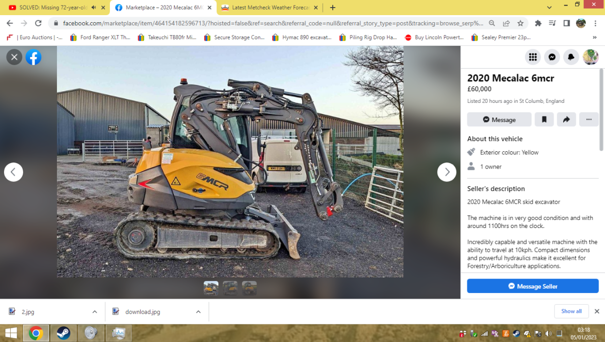

2020 Mecalac 6MCR Skid-Excavator for sale! Excellent Condition.
Just don’t see the advantage over spending same as 6 ton and skid/tele/avant load carrier having the flexibility of two machines vs 1 expensive halfway machine.
Having spent time on one, they are a rare beast that is a comparable tool in all it's roles to the standard alternative.
Only thing they lack is reach, and digging you need to master using the boom as a set rather than leaving the 3 piece in one place.

Great machine, what are you replacing it with?
Exactly the same but with a slightly different spec, the Engcon is being transferred over onto the new one.

Different proposition to a standard 6t money wise so what sort of work makes it worth it ?
Hope its got autolube 🙂
No autolube unfortunately, although it is an option. However if you actually break down what each component is there aren't any extra pivot point compared to a typical excavator with a 2 peice boom, its just they are in different places (namely the offset pivot being in the boom)
