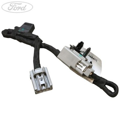

Yea had two wires that where left that had no feed at all coming to them so just took a guess and put them in the two spare connections but everything else works as it should👍.. used the tester and trial and error.

Do you have the 12v live constant?
Don’t think I do tried the two spare wires as I’ll call them with ignition on and off and not a volt coming to them according to my multimeter… but honestly I’d be lieing if I said I had the foggiest about electrical jiggery pokery.. I got all the lights on the trailer working so I’m happy👍

That's the jumper cable that goes in the box under the front passenger seat, if you open the box and it's not there you won't have a 12v constant to your towbar wiring, so if you hook up a caravan no feed for fridge or if wanting to run split charge relay for tipper trailer
My guess would be those wires go to the small limit switch in the socket which switches off the fog light when the trailer is plugged in to stop glare. I only found this out when trying to work out how the main dealer was able to justify the cost of a genuine socket
