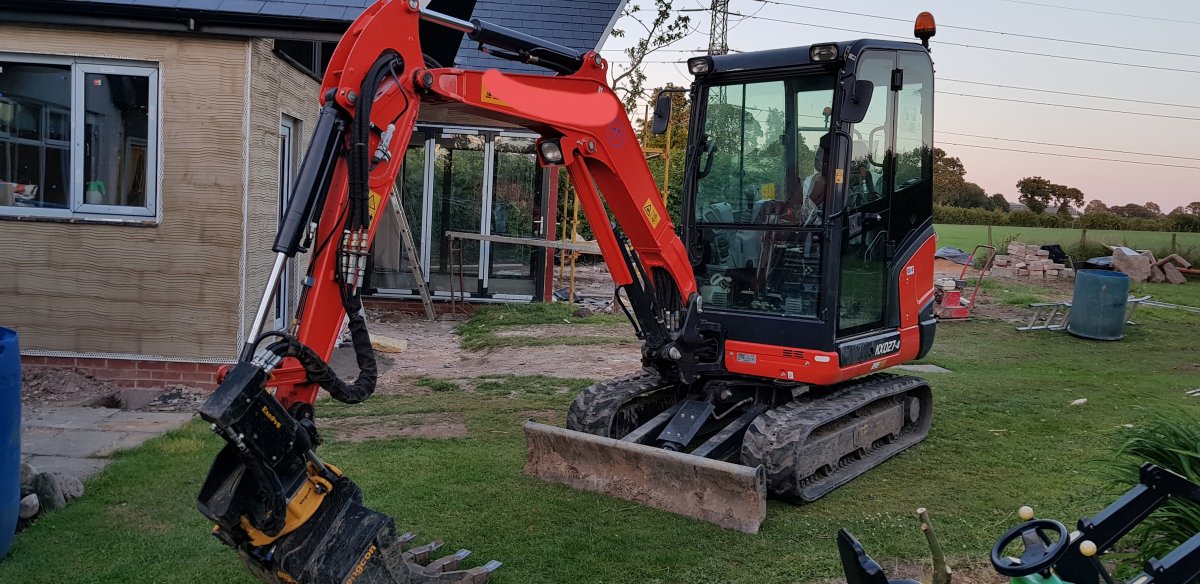

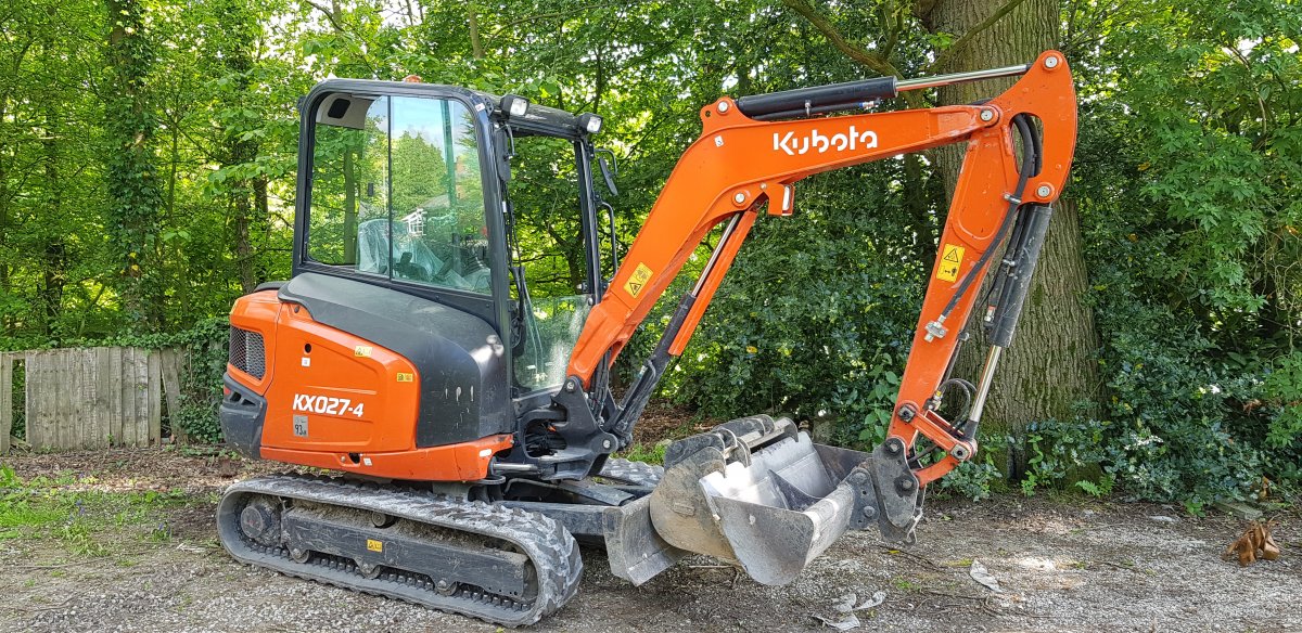

You're gonna struggle in that weight class to get a machine with a decent counterweight, they've got to chop weight off the back to keep within towing weights. I've seen a few machines with a bracket added on the back to hang tractor front weights off when using heavy attachments.It’s just the counterweight on the u27 that concerns me, look at this photo compared with the Kx030-4 or TB125. I think it won’t have the stability I need to run my postknocker for example 350kg at full stretch,
