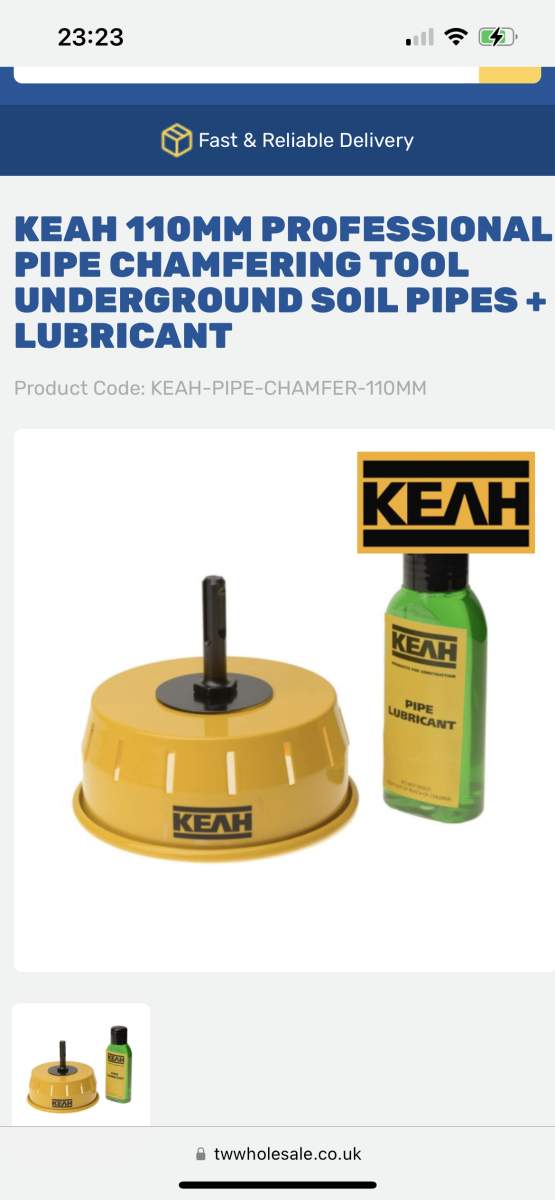

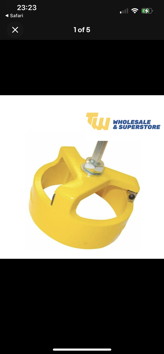

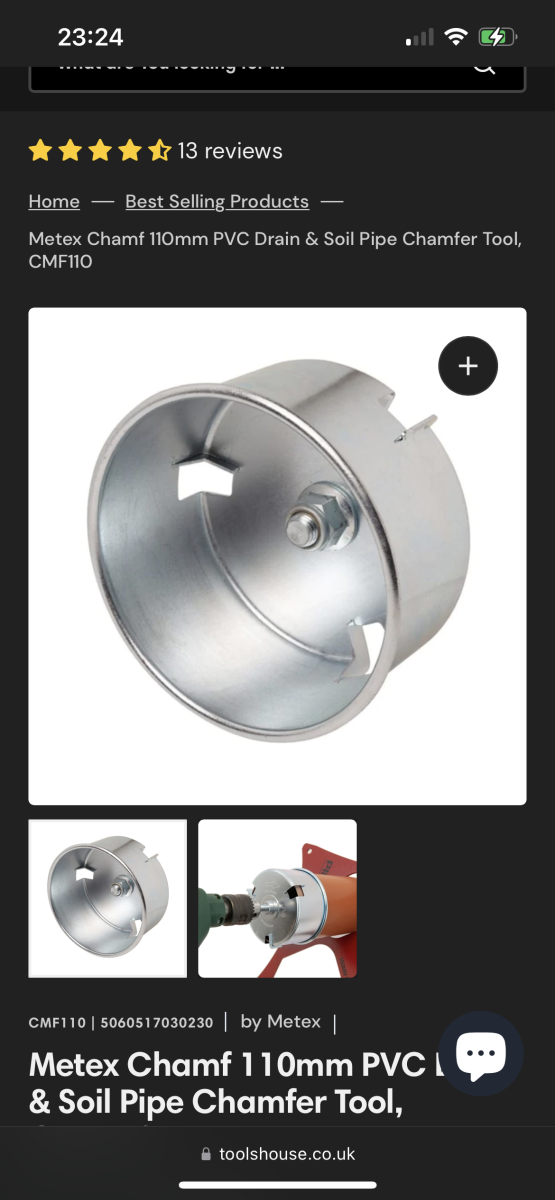

I have all 3 of the styles of chamfer tools the metex is the best one imho

I've got the keah one, it's ok but can mark the outside of the pipe if not completely square when chamfering.
