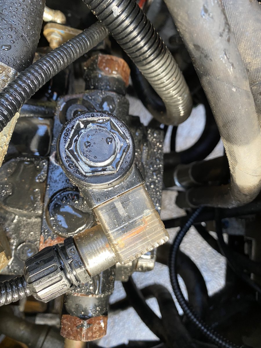

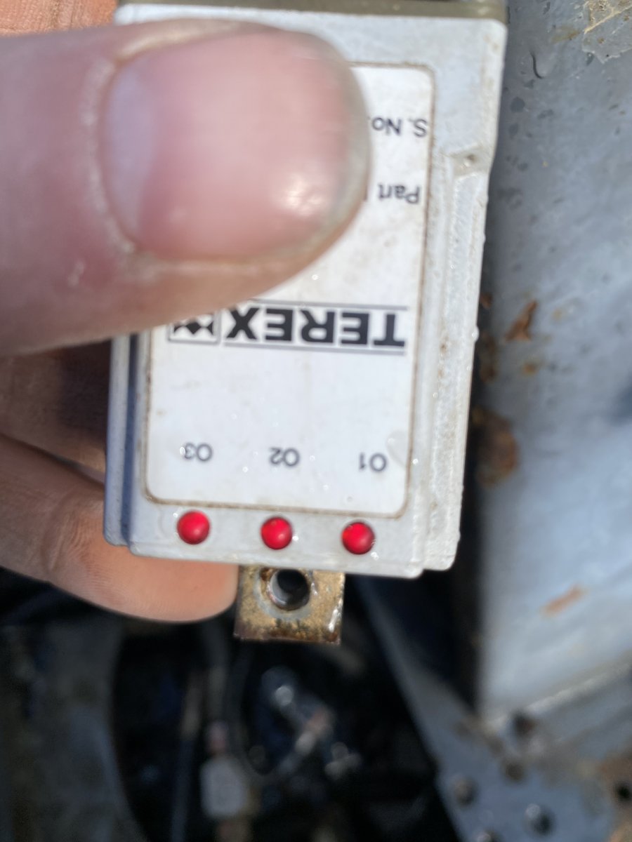

No unlikely, I'd say something is a miss since the engine change? Can you take a picture of the solenoid you are putting live to and which way round you've connected it up. Also a picture of the lights on the Terex box when engine running and in forwards or reverse. Then with just the key on but engine not running and drive in neutral. Gives us a clue about the wiring under the dash and can see if anything has been bypassed in the past.

All 3 lights are on when ignition is on and when started, and stay on when in forward or reverse. The light is on the solenoid.

There are two solenoid caps on the transmission, if you run a live and earth to one at a time, it should drive forward or backwards, but it needs also to take the brake off, do you have a hand brake light on the dash?
The fly wheel cover was swapped from the old engin and is definitely engaged with the pump.
the light may be lit in the plug but does not mean the coil is functional and pulling the armature in the valve ...
have you tried energising the coil with a suitable metal rod in the coil to see if you have a magnetic field to operate the valve's shuttle/armature ?
