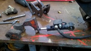

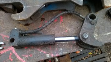

Chasing up hill to see if they have the rams to fit my zx180 hitch as the welded on check valves are rotten through and leaking
Had to cut the pins on the big one and fubar the cylinder and rod end to get them off got the off cuts out of the jaw /rod end but cylinder end was grown in so took it up to a machine shop that does steam engine repairs/ fab work to drill out the last 2 stuck in 6 inch bits of pin left from cutting it
iron worm has certainly gotten to that check valve Stu :oops::oops::cry:
Left hooker
Left hooker
14 years old out in all weather's with salt air down here does that unfortunately
Hill think they have a complete main ram but the numbers are rubbed off of mine due to the metal spiral wrap on the pipes for the small ram so waiting on them to confirm the length of one they have is same extended
They have the small ram and they will knock up a couple new pins for me also
Left hooker
Left hooker
Darent think the cost of that… 🫣
270 so far to get the machine shop to drill out the pins remains
What ever my fitter bills for helping me extract the rams as nothing is light on this at 250kg 🤣
Plus my time messing around sourcing parts and running around still got to buy and post down rams and pins then refit praying it's cheaper than a new hitch
They have the small ram and they will knock up a couple new pins for me also View attachment 66728

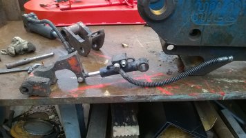

that hitch is one of those two ram twin lock hitches is it?
Much like the 9t one I mod.ed to go under my VA-r?
didn't register with me yesterday - little sod to get apart if anything is seized :(
hell they'm as bad as Mog ;):p :rolleyes::ROFLMAO: ... charge "like a wounded Rhino" as he so often says .. (just kidding Mog - he's always seen me alright(y)(y) ) :cool:
......... so took it up to a machine shop that does steam engine repairs/ fab work to drill out the last 2 stuck in 6 inch bits of pin left from cutting it
think I know that bloke .. partner/t'other arf to one of Vicki's old school friends - Sam Henwood, I think his name is - up Newquay way?

Yep that's him dropped off one day picked up the next so can't argue with that turn around
View attachment 66731 View attachment 66732 View attachment 66733
Yes just a 80mm pin one instead that was labeled for a zx210 its the 2nd hitch on this machine as first one would only do 210 buckets Hitachi changed it when new as wouldn't pick up the old buckets from our ex165/fh150 like we asked for
