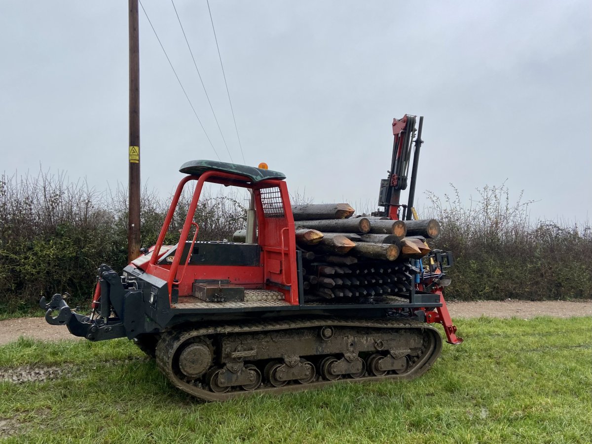

I have got a converted Yanmar C50r-2 which has been converted to carry a post knocker. Its got three point linkages on the front and rear so a handy bit of kit. I bought it two years ago to carry my protech knocker, I do a bit of agricultural fencing for customers appox 1-2k meters a year so not a massive amount. It has been very handy but has always been weak tracking on one side and i am worried about getting stuck with it. Is ok on the flat but on a bank or tarmac struggles to turn the one way so aways have to use the good side. Its an old machine and i cant justify spending 1000's £ on it but to good to scrap. It has a sundstrand daikin PV2121-504 pump on it which i am finding hard to get any info for. I have got it into the workshop to investigate. Investigation work so far includes :-

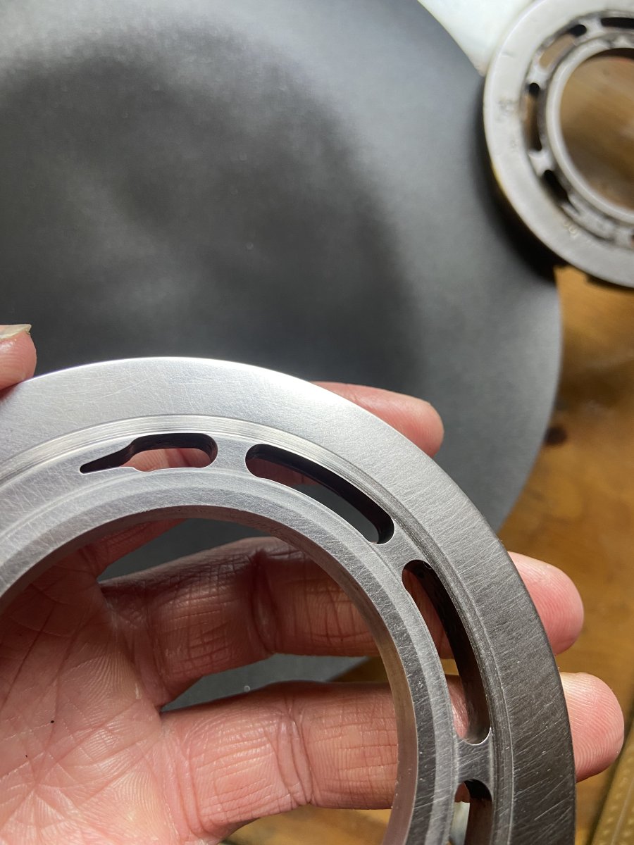

When. i bought the machine it came with a spare pump minus the linking but unfortunately it has got slight corrosion on the inside so buggered but i used that as a reference when stripping down the pump as i have not done one before. I have tried lapping the groove out on 600 grit paper on a glass plate but it does not appear to be reducing. I am struggling to find a replacemnent valve plate, i can find ones for pv21 pumps but the dimensions are different. Internal diameter is larger.
Does anyone know if the valve plate can be lapped or know of anywhere that can do it or have any advice. I have tried a few hydraulic places and the want me to send the whole pump for refurb but unfortunately i am not in the position to do that. Pics of machine and plate attached for reference.
