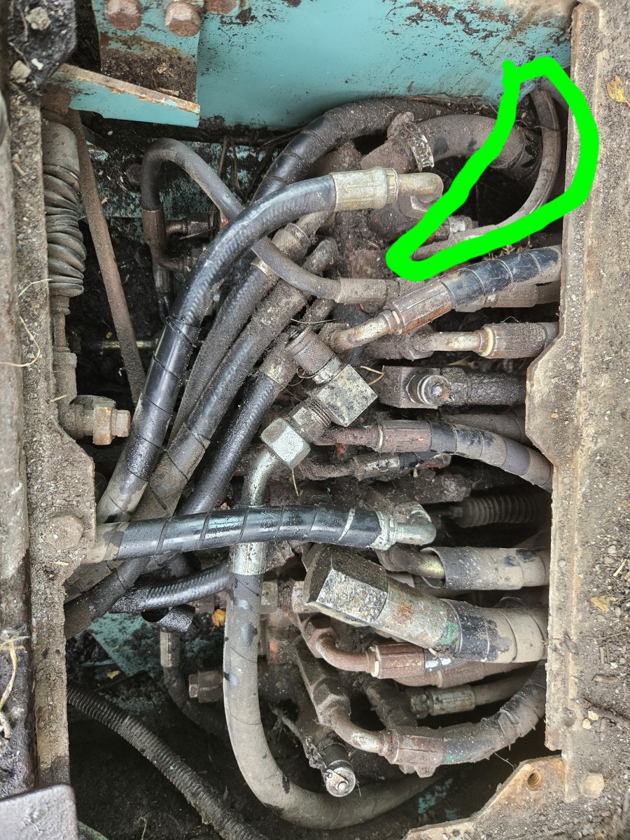

Im having an issue with my yanmar B30v
I have a slow main ram and bucket ram,
Checking at the valve chest get over 3k psi when the ram reaches full extension or closure,
However I notice a small pipe, see highlighted in pic , that oil seems to flow through when ram is in movement , maybe an overflow or bypass ?
Anyone have any suggestions, pump is good

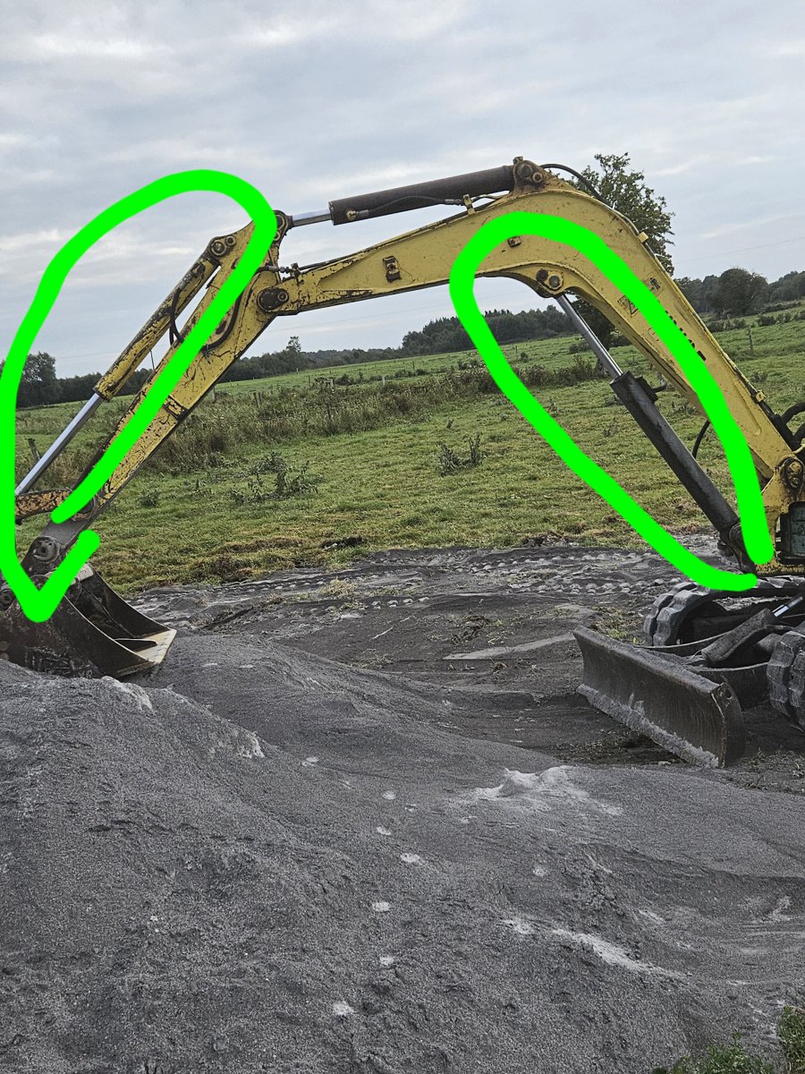

Hi Mick-the-fitter, see pic of rams highlighted ram on right side seems to be the main issue, but the bucket ram is also affected,
So checked the valves and washed just to be sure, they seem fine, bucket curl is pretty much ok,
The ram on the right will lift, and once the handle is released it will drop maybe 300 to 400mm and stop, same if lifting or lowering

Ok can you show me the other side of the rams where the pilot valve blocks are
