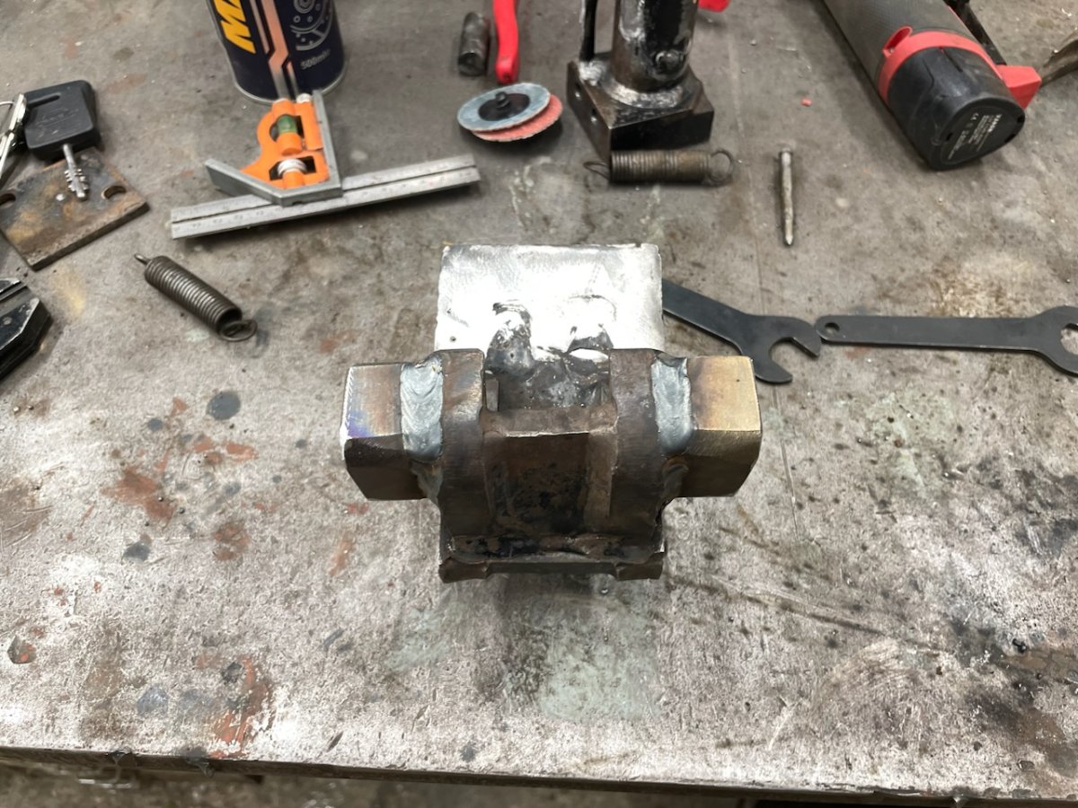

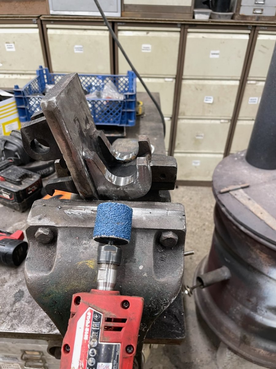

For a mini hitch you could probably stick it on a decent sized milling machine for the through hole.
I've had sucess using a 30mm spiraband to grind down the 30mm half circle bit of a hitch after building it up with weld. It's a bodge though, and not suitable for a through hole as you'll never get it even enough.
View attachment 45851View attachment 45852
Thank you Doobin, I was hoping for this kind of replies. Good job with the spiraband; you would need a jig to guide the grinder and keep it aligned. That is why I thought of a reamer with a guide to finish alignment.
