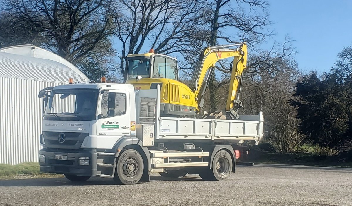

As you know we are 19t here on a 4 wheeler, I have 10t payload with mine so you would get around 9t.

Looks a good set up there, do you use the bed for carting the machine only or do you move materials with it as well? 4 wheelers to be honest I hadn't considered one due to the payload but I will certainly give it some thought now.
That body does the lot - I don't have a plant body, don't really need one and it's more messing about and i can put a trailer on the truck to take dumper etc but a trailer is a pita most of the time, working local I'd rather make another trip.
8t is a fair lump on it as you can see, it's much happier with the 6t but if axle weights etc work then why not if you need an 8tonner.
Tbh I learnt everything I know about trucks from the lads on here so I'm no expert, but this setup works very well for me.
