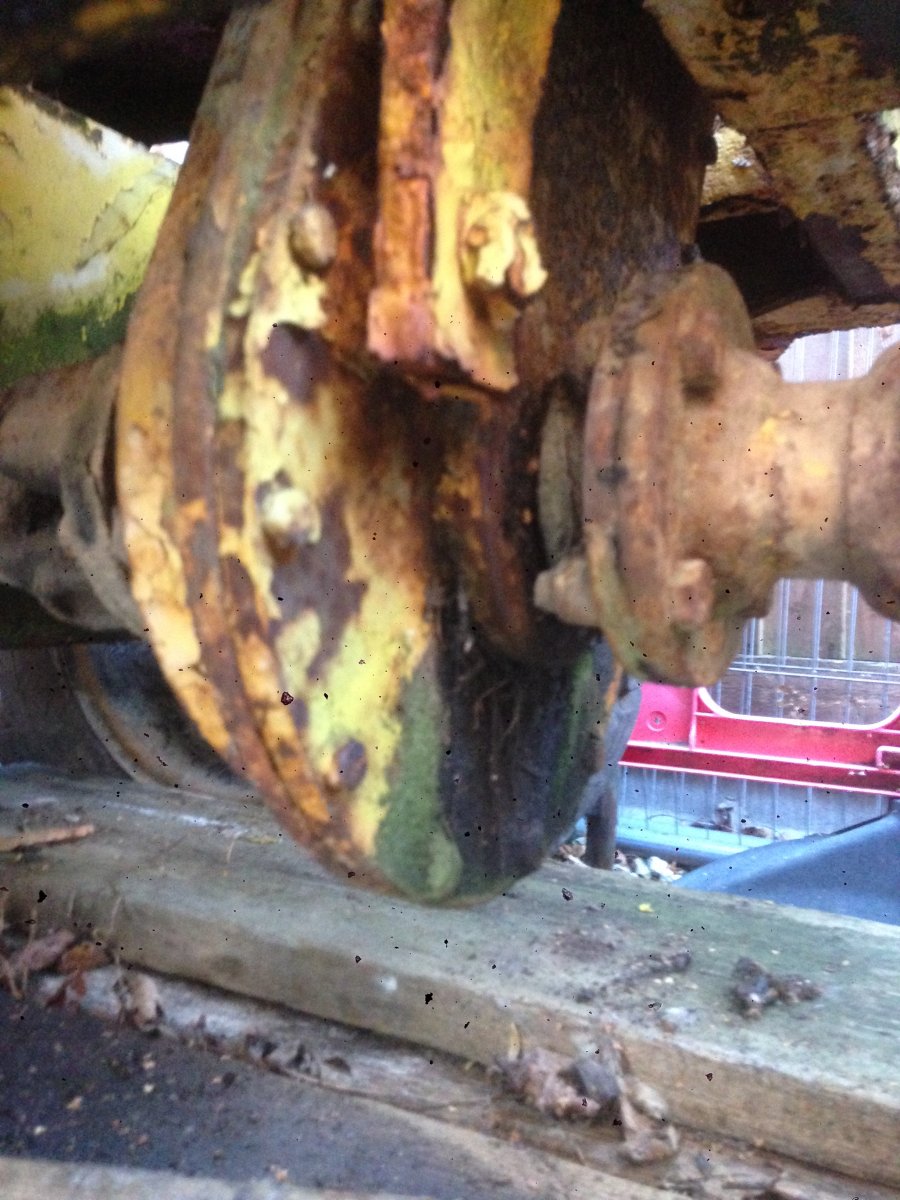

Should I be greasing this prop shaft it sounded a bit dry and creaky. Machine was rocking as I undid nuts!
