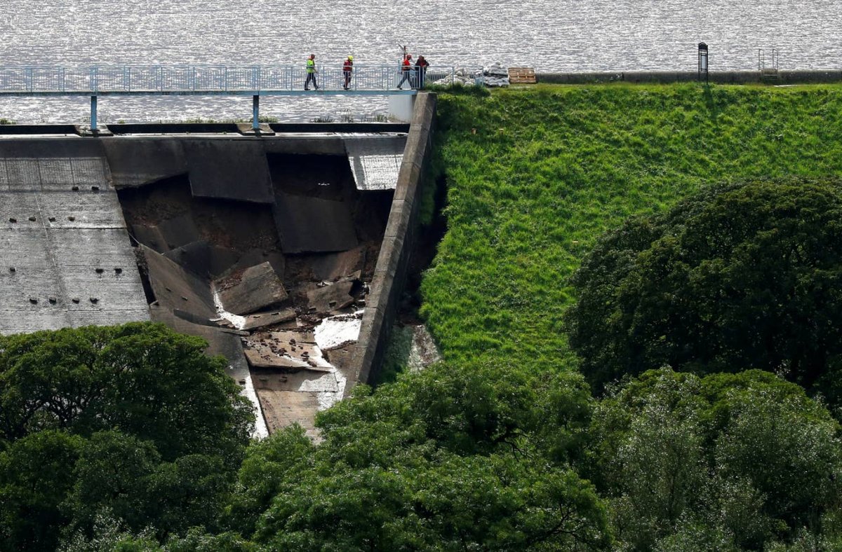

Pam's old mob - Canal and River Trust (as it's called now) .... obviously had a leak for some time looking at the wash out ....

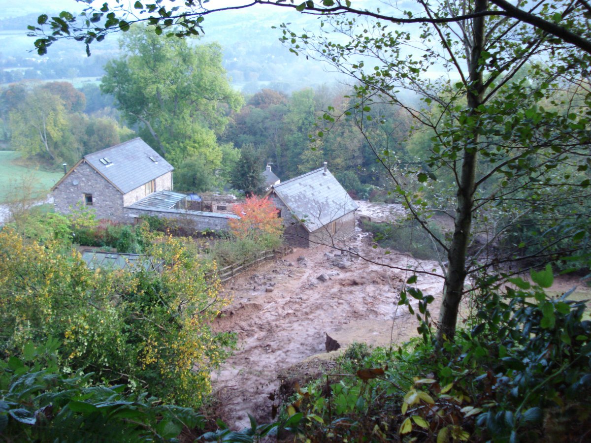

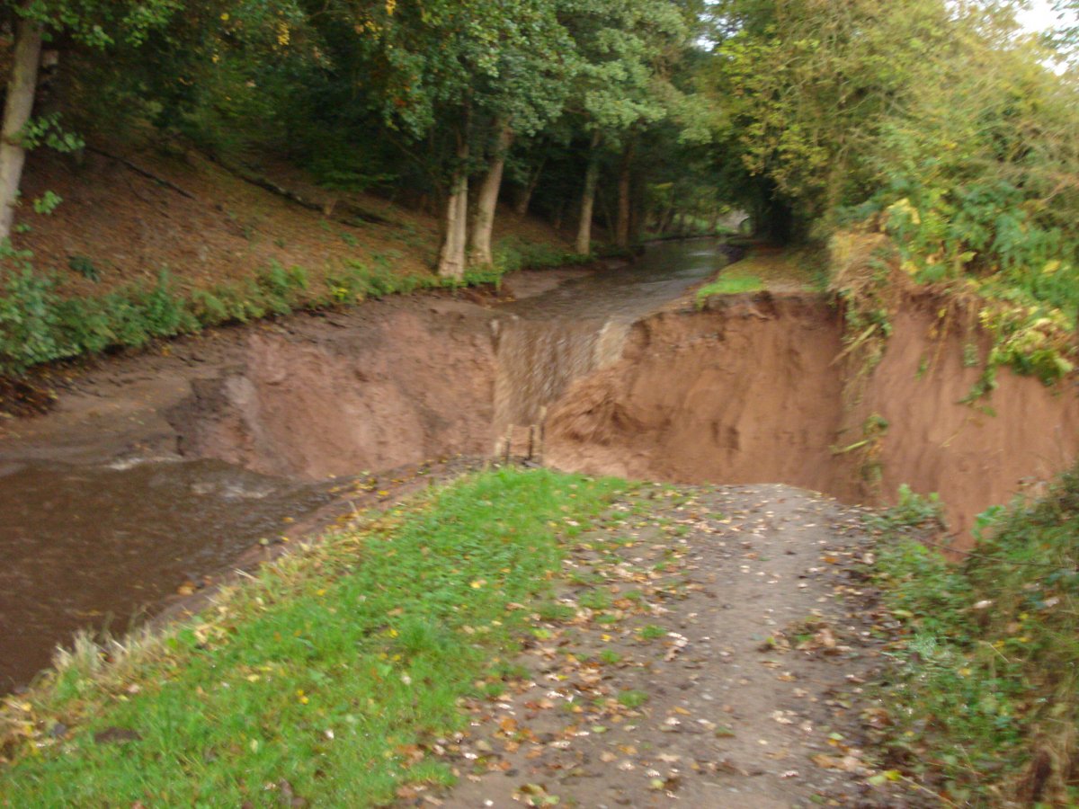

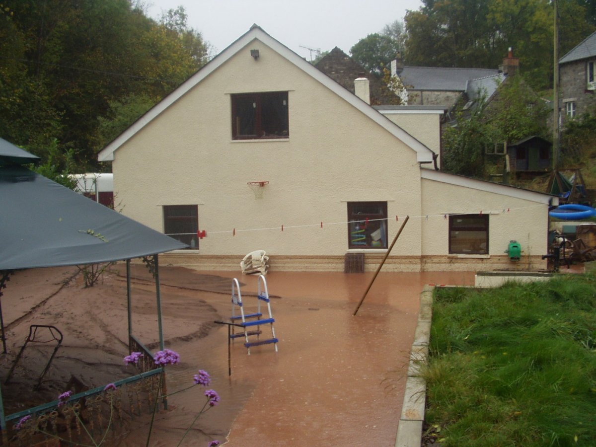

posted some pix of a similar 'situation' with the local canal a while back ... once it starts to infiltrate and create a course ... you're in the s**t .. if it isn't spotted quickly.
TBH they're very lucky .... that sort of event is usually fast and catastrophic and this 'un'd have been on a GRAND scale .. if it'd actually breached, rather than the infiltration they've had .... the high speed water flow over the slip was just the last straw and sucked the slip surface away from the void below it ...

My thinking would be coffer dam piles driven in around it then pumped to work on it

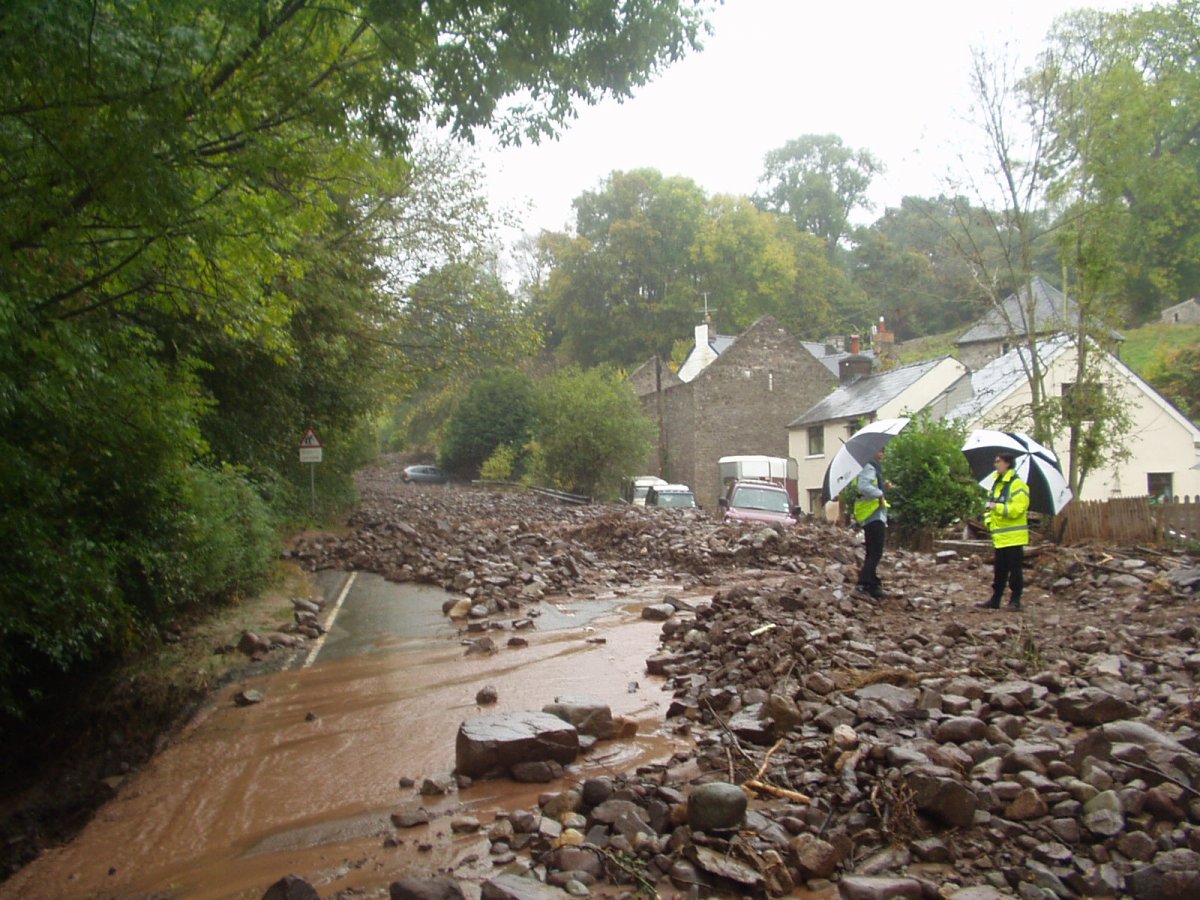

think the main concern ATM is to be seen to be doing A LOT, quickly Stu :unsure: .... repairs'll come later :rolleyes: ... for now they'll want it empty and controllable, with as minimal a risk of a breach as possible ;) .... that word strikes fear into the hearts of all canal workers .. they've seen too many and this'd be on an unprecedented scale, in comparison to a 'deep ditch' breach.
have had three around here, in my memory and jeeez don't they make a bloody mess :eek: .... luckily no lives were lost in any of them, but down to pure luck :whistle: .... being a contour canal, the Mon & Brec is usually way above the surrounding topography .... and water only flows one way :rolleyes:

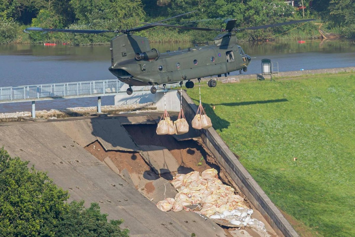

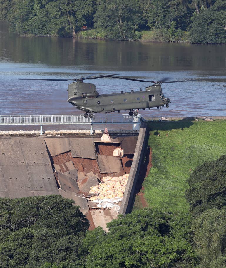

If it's a clay fill dam with earth mass/banks which it looks to be and it's suffering from infiltration then using piles before the water is down to nothing is a bad idea indeed, could easily cause liquefaction leading to a sudden and immediate collapse.
All there doing now is adding mass to the collapsed section in order to restore the weight in that section. on that type of dam Mass is what keeps it in place and prevents the Clay center from moving/keeps it water tight.

I would get in there build a coffer dam around damaged area and over pump the overspill from main lake and from inside piling 2 birds one stone as they say

Cock on there Rory, with that summary ..... all they'll want to do ATM is get it empty, if only to reassure Joe Public of the removal of the flood risk .... and to negate any chances of it getting away from them

Once empty your into conventional earthworks... a quick bit of Geotech to ensure the center is still secure and provided that's the case a simple bit of filling and compacting of the failure, followed by a concrete cap for the spillway.
