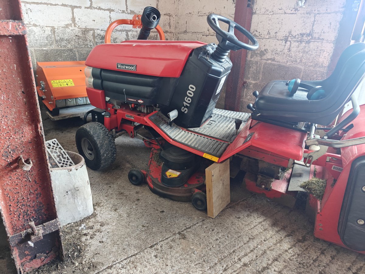

I've had the axle snap on the Westwood ride on mower.
Has anyone got a source for a new gearbox/shaft before I get it stripped down?

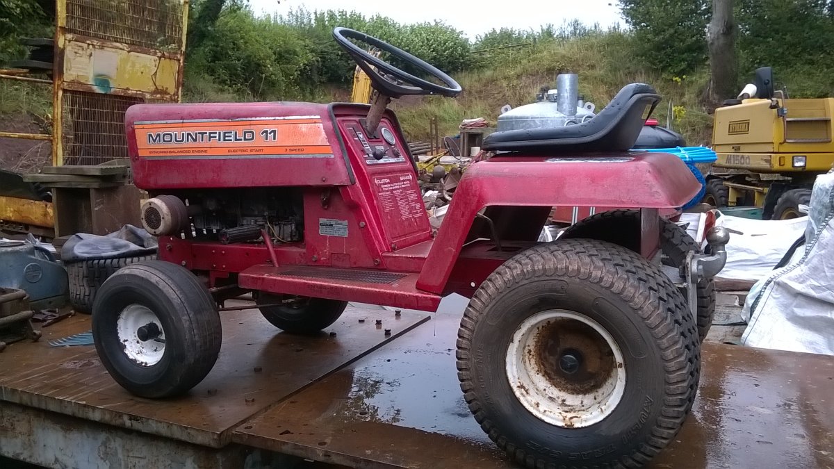

I had to bush the final drive on a very old Mountfield I have as a tug (although I did build it a new deck maaaany years ago, that's never been used) ... never seen one snap off though
's a good little traccy, but whenever I want to use it I have to take the flywheel off the motor and remove the cobwebs from the points :mad::mad: ....... could do with an electronic ign. conversion

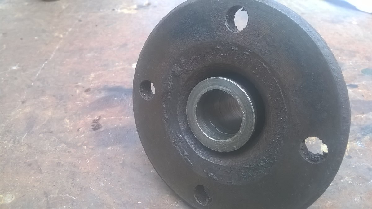

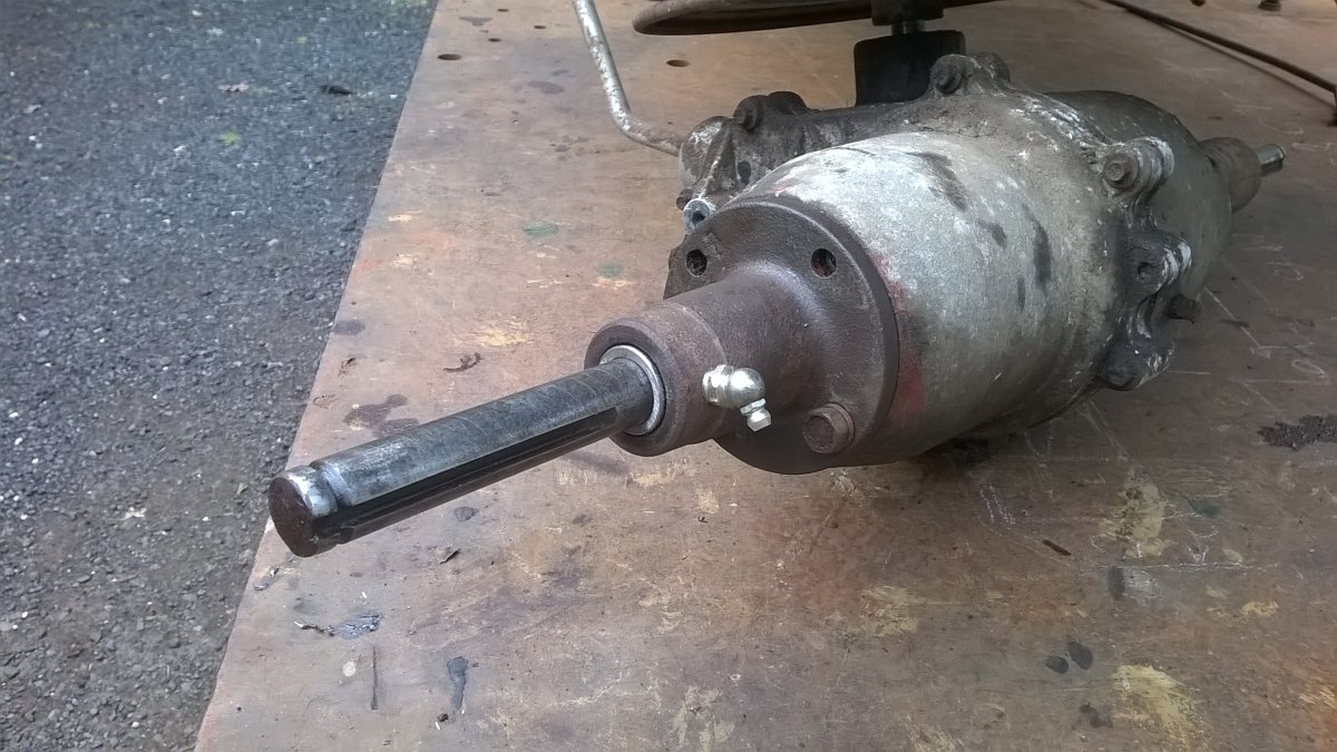

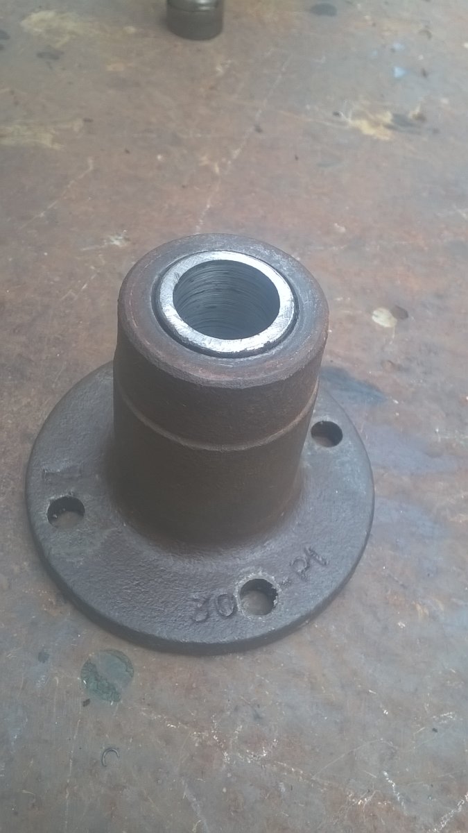

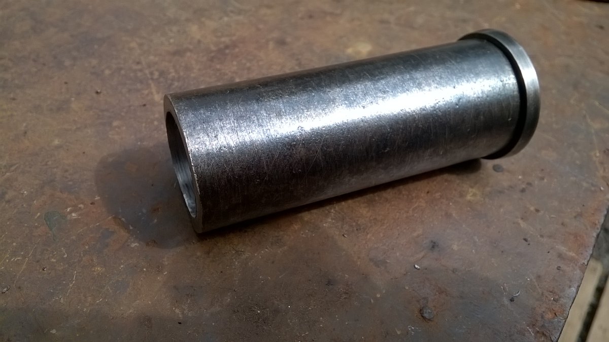

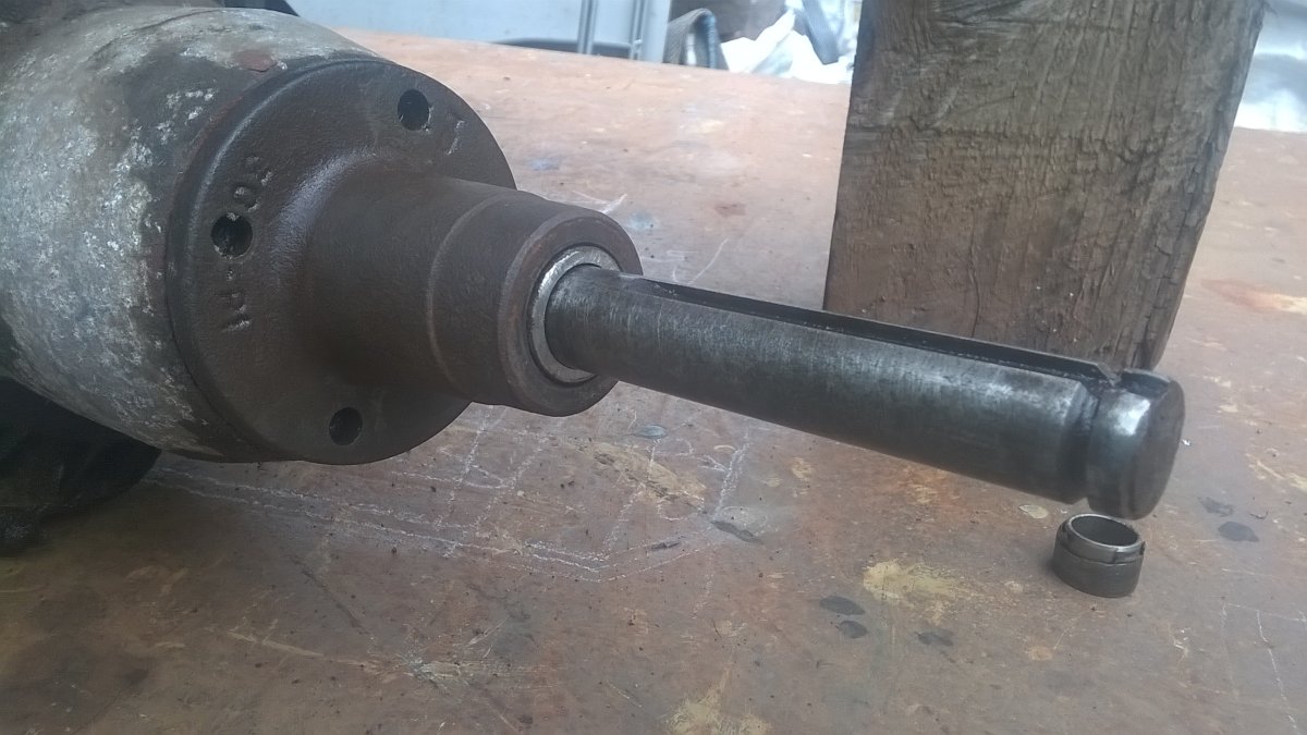

looking at that blown up a bit .. is it anything like the outrigger boss on that one I bushed ? -- could you weld the shaft back together and sleeve over it, increasing the outrigger bore to compensate ?

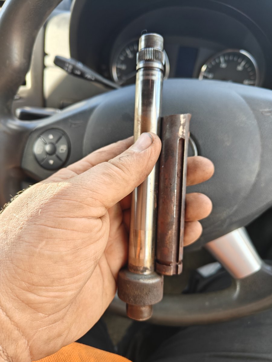

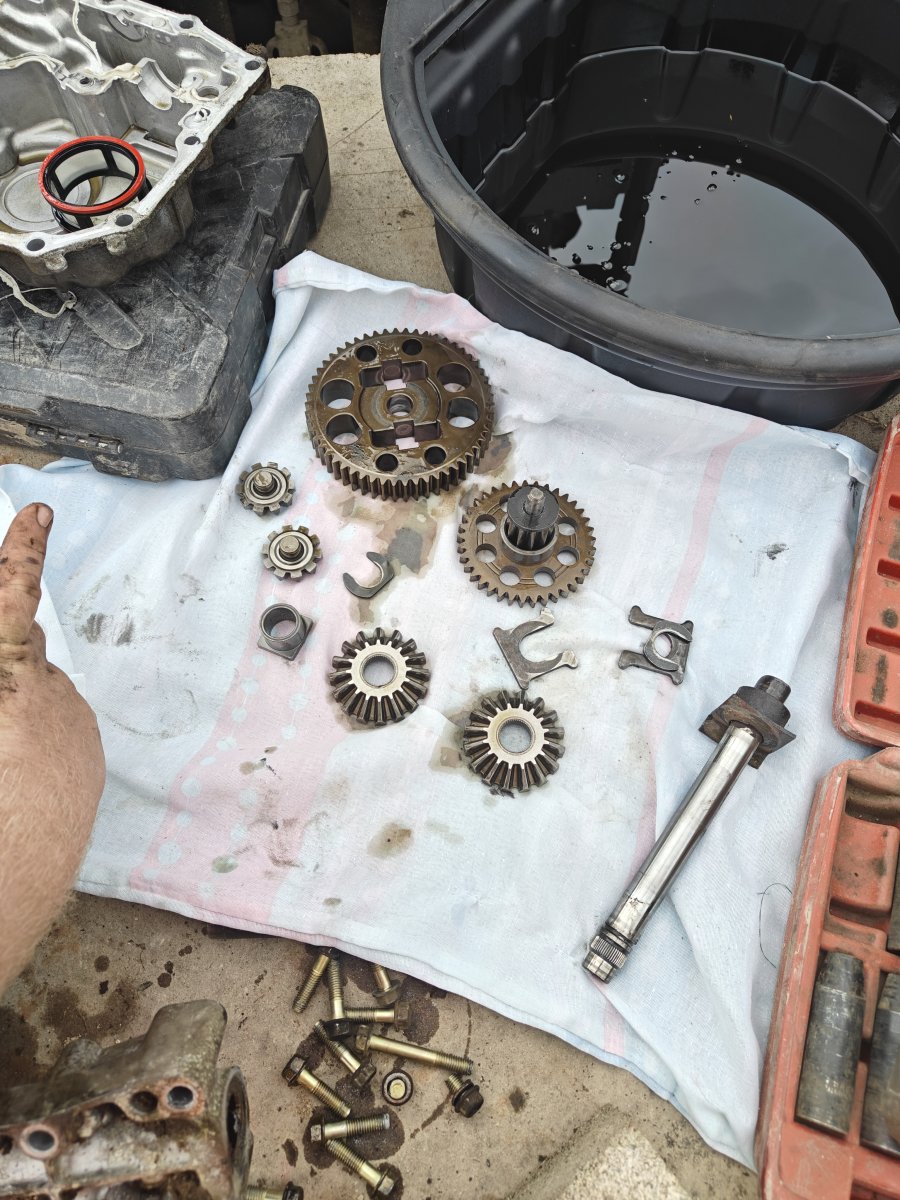

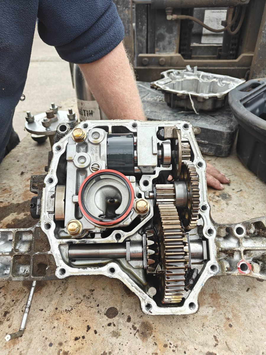

You can see where it's been cracked for a while.
Well it's in bits now the shaft has snapped about 10mm inside the hub for the tyre so my options for a weld repair are limited.
The broken piece did not want to come out the hub it needed a fair amount of pressure in the press to get it to move.

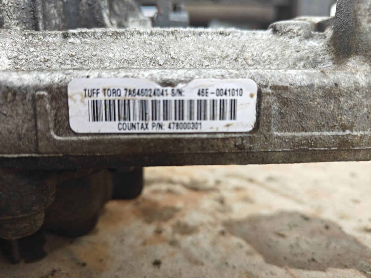

I'll have a ring round tomorrow and see what the damage will be for a new half shaft.
