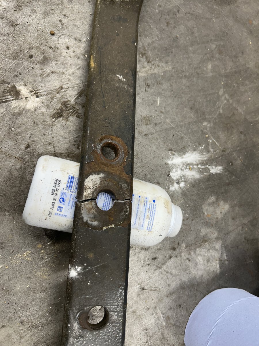

Alpine link arm took a beating yesterday.
Suggested protocol for migging this back together? V out almost to halfway all around, preheat and fill up with spray mig? I have 15% gas for extra penetration but not sure this calls for it. My main concern is post weld brittleness of the edges of the weld.
I can put it in the mill with a mag drill cutter to redo the hole.
I can put it in the mill with a mag drill cutter to redo the hole. View attachment 74252
do that and let it cool slowly id say
Preheat it, 'fore welding then bury it in sawdust to cool for a few hours - will cool nice and slow in the insulation
