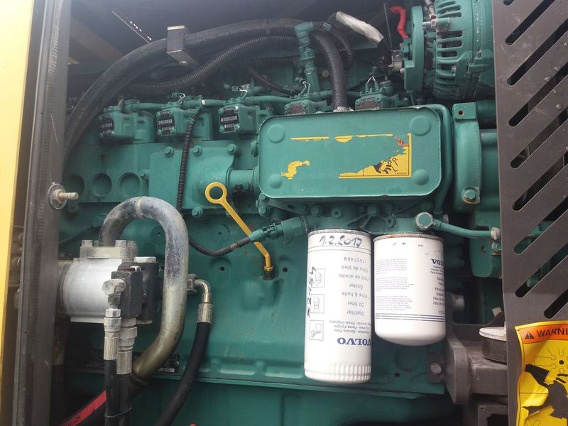

Got a Volvo L90E with D6D engine and we have oil in the water..looks like the oil cooler has been changed in the past.. apart from head gasket has anyone got any other suggestions of how the oil is getting in.. she runs like a watch..

Maybe the o rings have perished in the oil cooler?

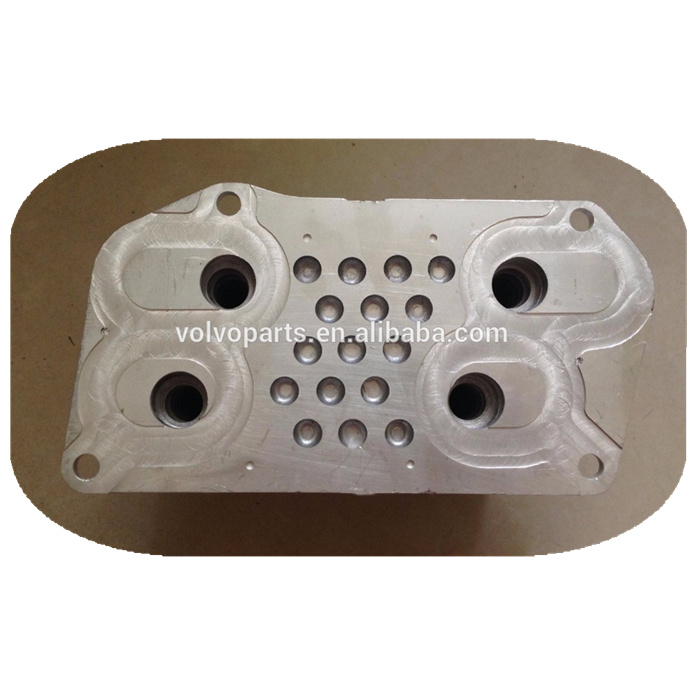

It would be the square looking box here, o rings are behind it.
