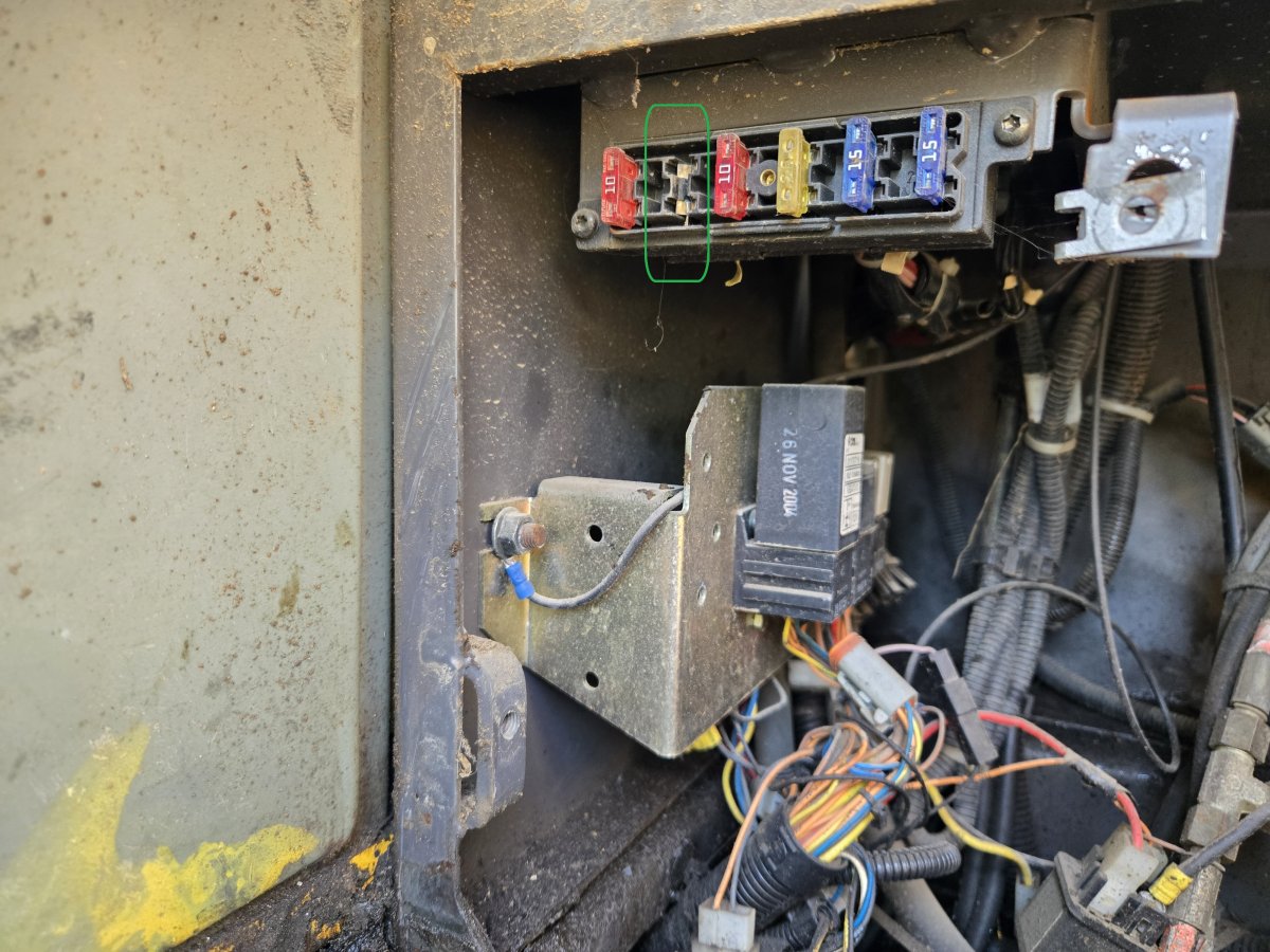

My Volvo EC25 (2003) hydraulics stopped working when I was using machine - (engine still running). Next, I turned off engine and tried to start again but engine would not crank. First thing I checked was safety switch but it seems fine - (I have not checked wiring yet, just switch). I was checking the fuses and the fuse number 2 - (7.5amp) was blown. I swapped out fuse but it failed straight away when I turned ignition on. Does anyone know what fuse number 2 is for? and would it have anything to do with the starting circuit? I badly need a wiring diagram if anyone can kindly supply to me. I have attached photo of fuse box - Fuse number 2 is the second from the left - (I have fuse removed in photo).

Fuse 2 is connected to the dead man solenoid, Id disconnect the plug at the solenoid and see if the fuse doesn't blow
F2F FUSE SUPPLY ELECTRICAL VALVE FOR SLEWING / OFFSET + ELECTRICAL VALVE FOR HYDRAULICS

Yes I'm in Derrytresk. Is that Aidan? I will give that a go Aidan. Where did you get that information regarding the fuses?
