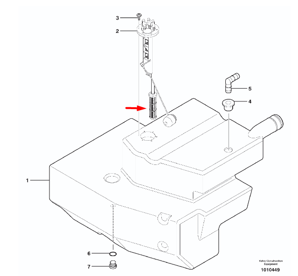

If you stand back and eyeball the seat base, could the tank look like this?

The strainer in the tank isn't replaceable separately, it's part of the pump basket/level sender unit, item 2 in Gecko's post. The plastic bit you have circled in the picture is for...... and that information comes when you buy the filters from a decent company who cares and helps about their customers. Not some online reseller who is there to buy in bulk sell em cheap.
