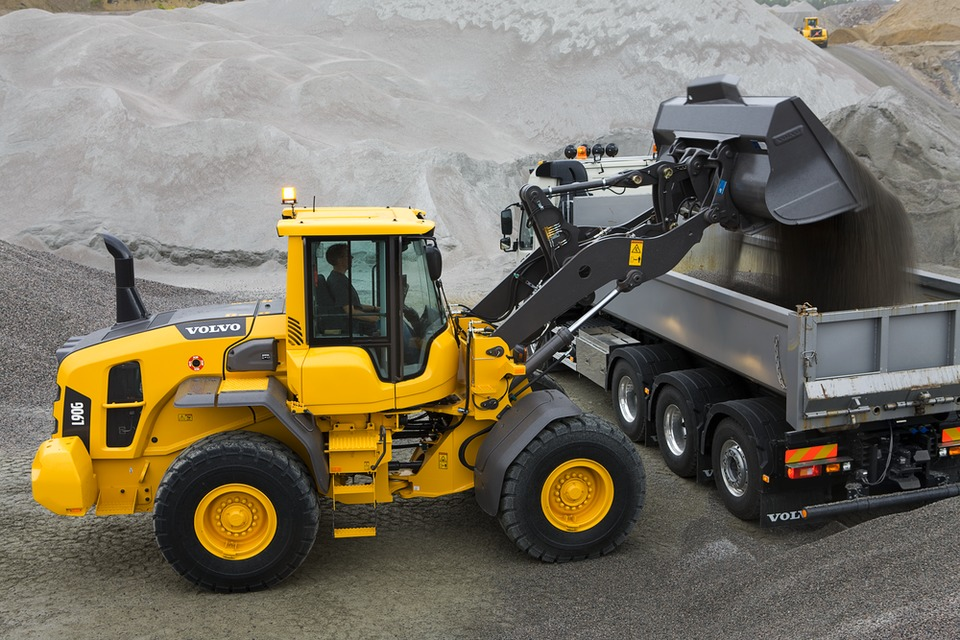

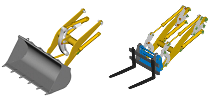

I did my homework too, I know that the mechanical shovels have as parameters: penetration and tearing of the tooth, plus other parameters that are used to make the machine performance. many say that the dresser type Z balance system is efficient but the operator has little visibility. better the system with parallel arms if you have to use the forks and move loads, you have more visibility and precision of the maneuvers. a friend of my father who repaired hanomag claimed that the best arm mechanism was the 55d hanomag blade. but it was difficult to repair the arm and replace the worn bushings. I have seen that caterpillar has created a system that is similar to volvo and is a middle ground between Z balance system with levers and parallel arm system, so you can use the bucket for earthmoving jobs, the forks to move and move loads and goods and other utensils. at the expense of visibility? which engineer designed the z system? I noticed used by the German production shovels, am I wrong?
The Z linkage has far more tare out force but doesn’t lift the bucket parallel and also has a greater bucket rotation for tipping at full height
thanks for your clarification, I believe that caterpillar and volvo are improving and perfecting this type of linkage so as to create an arm that has good performance for earthmoving and excavation operations and with tools, hooking the forklift type lifting forks and for the claw pliers for the trunks and other tools. I'm wrong?
