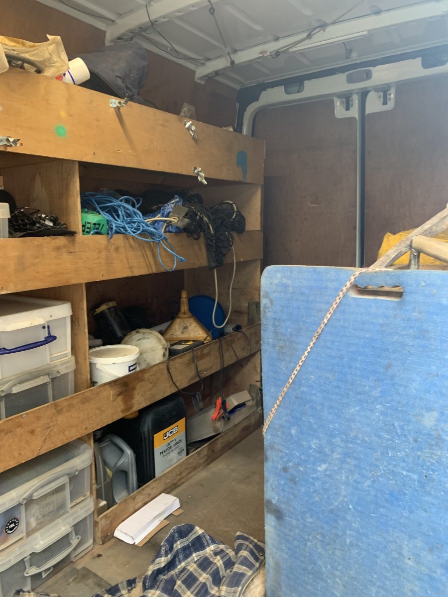

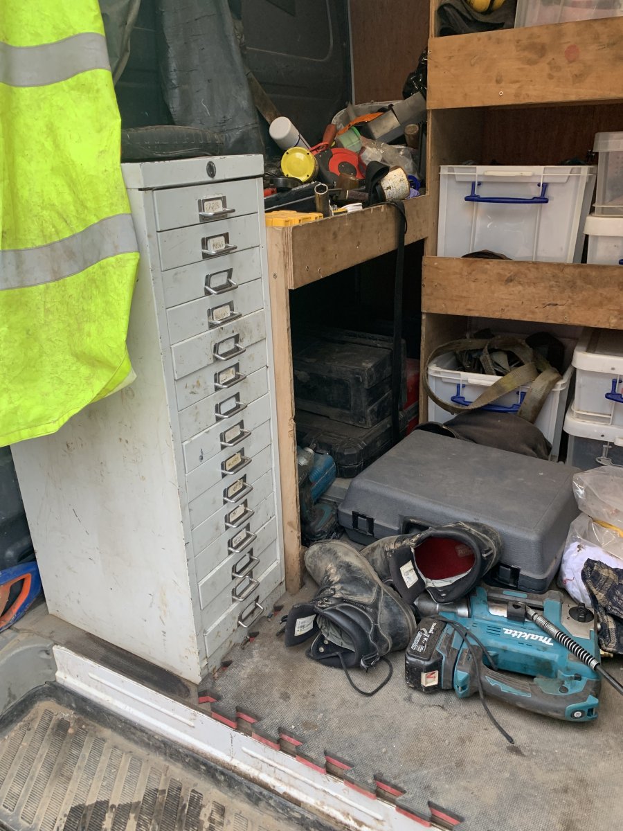

I’ve bought a year old MAN TGE
I want to rack it out for work and was thinking best way to do it . It’s similar size to my sprinters so I know roughly what I want but wondered does anyone have any good ideas I can steel ! My hand tool storage is awful shovels punch bar broom etc

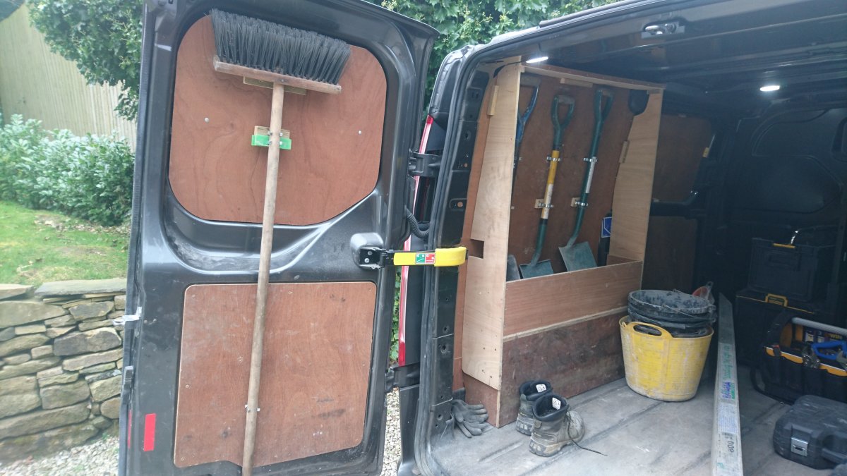

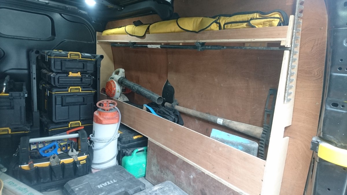

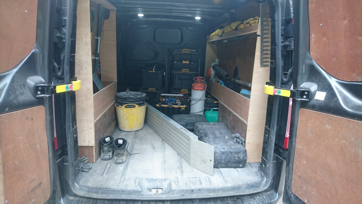

We tried alsorts with shovel storage false floors, length of pipe trough for them to lay in and found the only thing that works is bars coming out the side of the van a piece of roof batten one the floor to stop them sliding forwards and a mini ratchet strap screwed to the wall to hold them all in place.
Nice and easy to get to everything without making a complete mess of everything else. We do have a small false floor for long level and digging bar as the van isn't tall enough to stand them up. And try to use brooms with removable heads. Take the heads off Mattocks and and picks.
Biggest problem is rakes

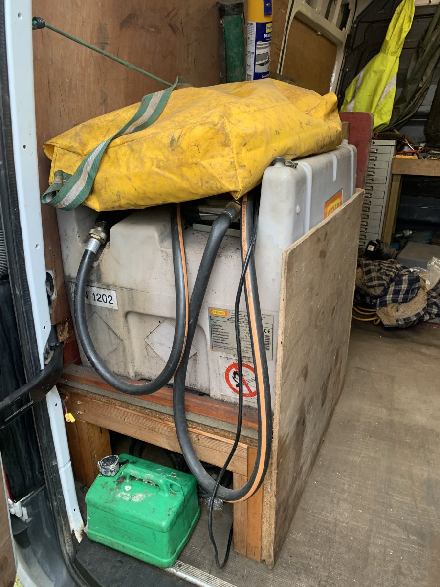

I put my fuel tank on a ledge built over the wheel arch so the weight is on the right place when I fill it and it takes up less floor space than having it on the floor .
I may put it a bit higher this time as the space above it is wasted and space below it is usable

neat rake solution :cool:
