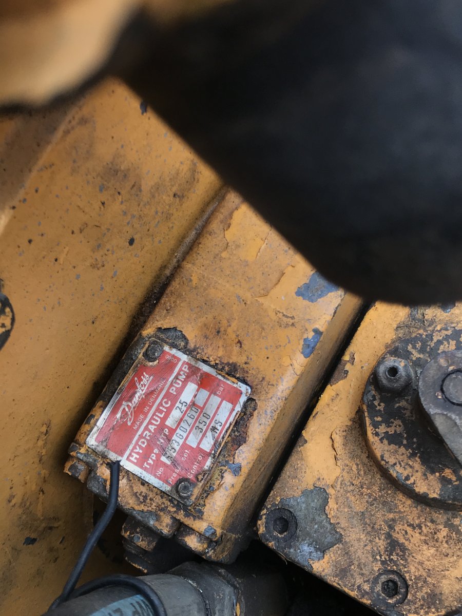

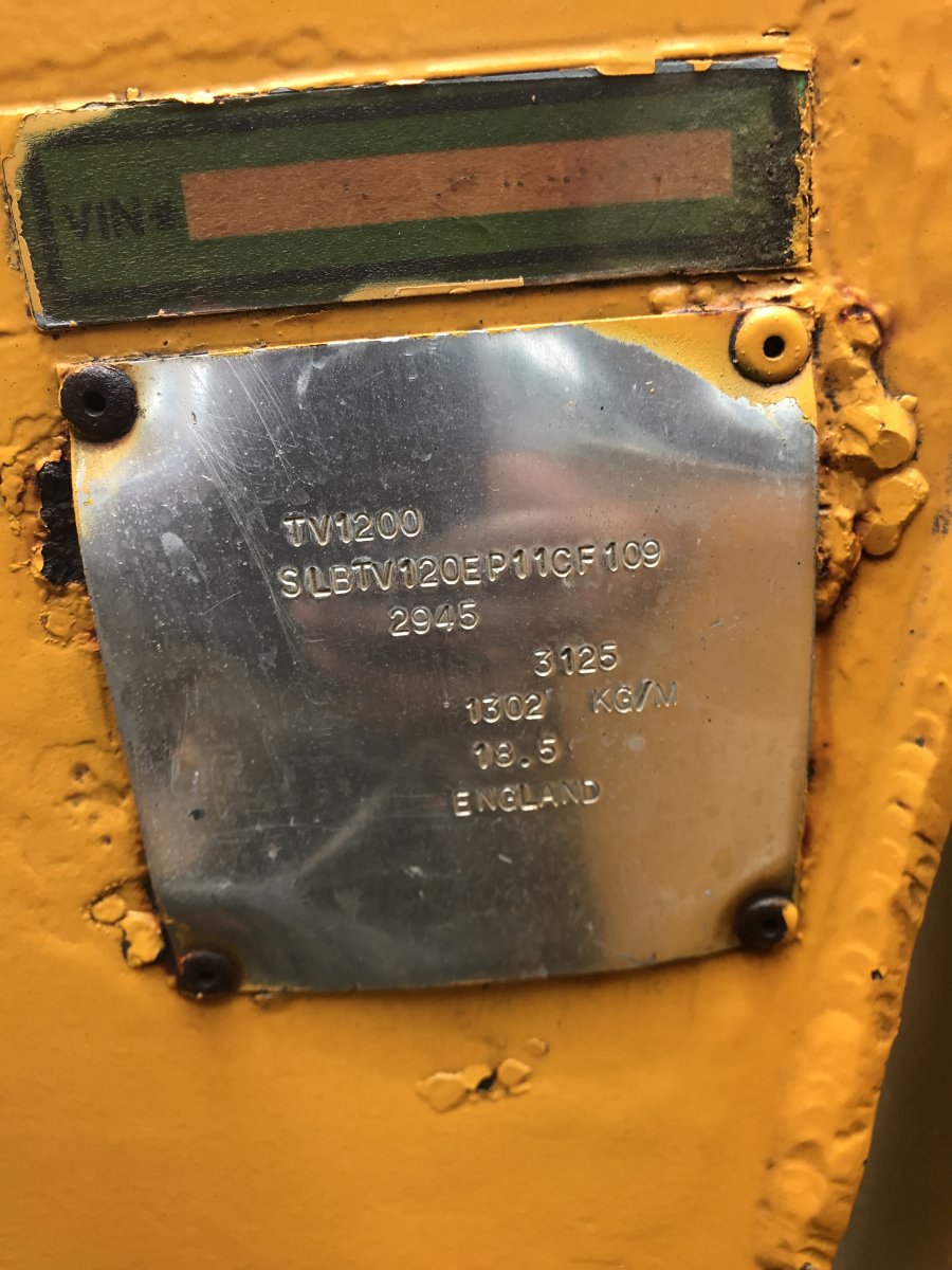

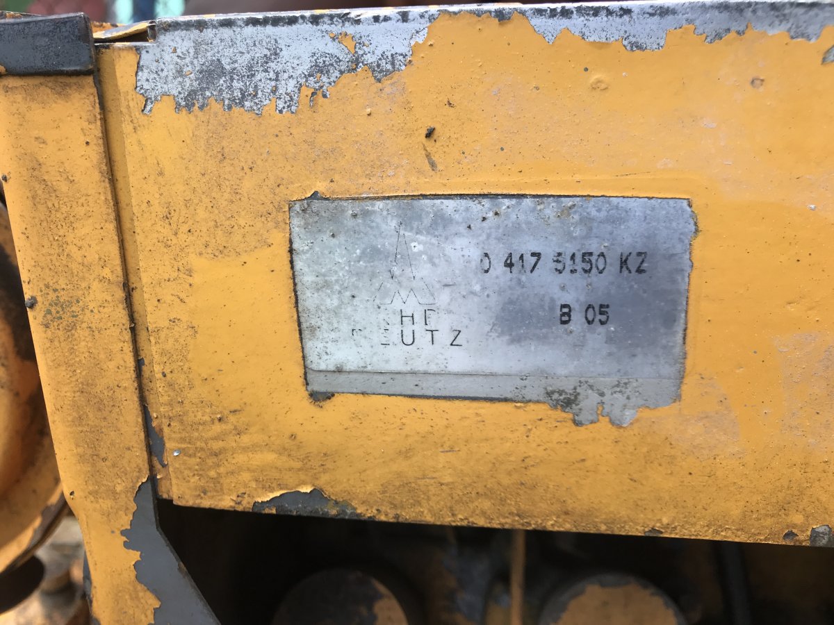

Just recently bought a TV1200 vibrating roller
That starts and drives fine but having an issue with the vibrator which isn’t engaging
Raheem holness
These are the name plates
Shovelhands
Shovelhands
Vin plate? I can’t recall if it states the age separately or it’s within the vin number?
Take a pic of it?
If it’s a Terex Benford machine then there is a solenoid valve under the footplate. Might be a good place to start, it may be a simple the switch in the joystick. If you can test the power at the solenoid and possibly put power to it via a power probe or just a short piece of wire off the battery to test the solenoid works.
Shovelhands
Shovelhands
Take a pic of it?
I think it’s older than I’m imagining from your pics. So maybe disregard what I’ve said.

we also had a 1993 lol
I’m assuming the op’s roller is a 90’s model? Am I right in saying the age is in the serial number? In the letters somehow?
Why they just can’t put the age on the plate is beyond me!
Regy53
Regy53
I like cake
yep but i only know until 2020
It used to say E506
be 6 month 2005 as an example
but they changed since. also early ones not so easy to follow
