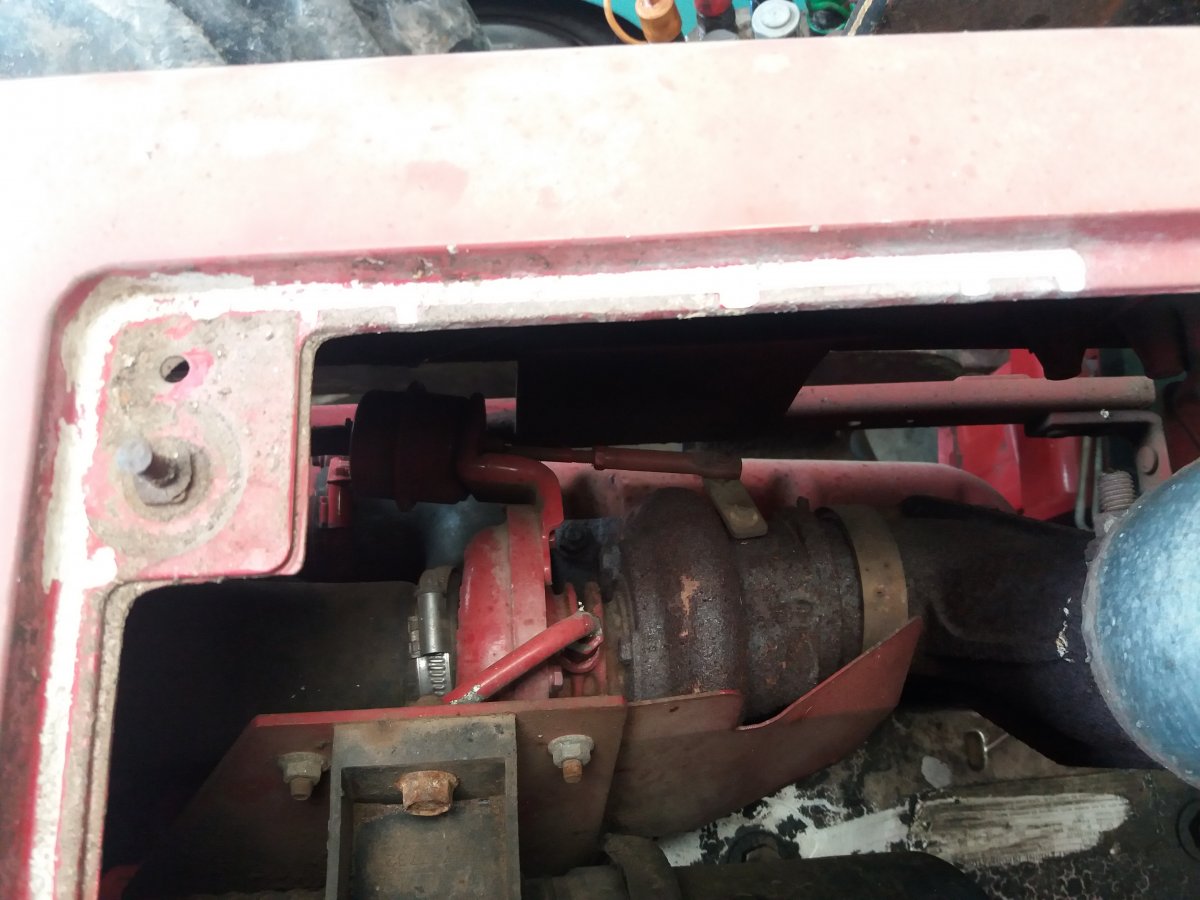

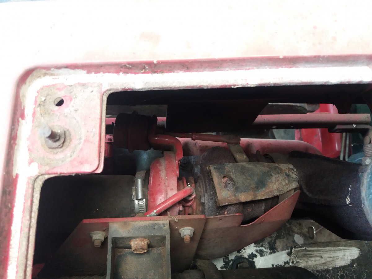

I was going to take the bonnet off for easier access for the mechanic. But there should be enough room through this hole surely. He will need to get the rocker cover off
diggerjones
diggerjones
I just though was there any point taking it off if he could do it through this hole.
If you take the air filter off you can see the rocker cover
It'll probably save more time than it'll take to remove it though and if there's a bad bolt or anything.......

Taking the top of an engine is the last thing you want to do with restricted access, more chance of dropping things, more chance of knocking s**t in the top when you’re taking it off and when it’s off etc. If it’s not too much of a ball ache then give him as much room as you can. can’t beat seeing the job properly 👍

Ok. Yes you right. I will take it off before i drop it off👍😁

Got bonnet off. Took about 10mins.😁
